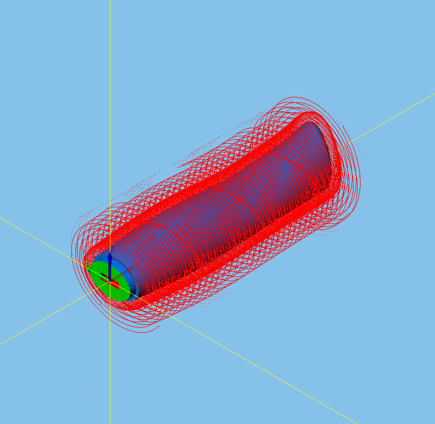

Hello friends. I would like to see the support of the G93 G94 in the controller, this allows using 5 axial cycles for 4 axial machining with a fixed 5 axis. :thumbup:
Sorry for my english, this is Google translator
Offline Benedikt

Offline maxx2000
  • Posts: 27
  • Country: ru
« Reply #464 on: March 10, 2017, 07:51:14 AM »
Are you talking about the following commands?
G93: Feed Rate Mode (Inverse Time Mode)
G94: Feed Rate Mode (Units per Minute)
Yes
Offline Benedikt
  • Posts: 200
  • Country: de
« Reply #465 on: March 10, 2017, 08:26:29 AM »
Yes
I think this might be possible.
In inverse time mode, the preprocessor would just calculate the standard length/time feedrate from the time F parameter. Does this sound plausible? Or am I getting something mixed up?
I have never worked with these modes so far.
EDIT: I would like to start making a list of additional G and M commands we need.
Would anyone who has a suggestion please leave a comment with the G-Code number and maybe a quick description?
Thanks,
Benedikt
Offline maxx2000
  • Posts: 27
  • Country: ru
« Reply #466 on: March 10, 2017, 09:41:21 AM »
Yes. In the inverse time mode, F means that the movement must be completed in [unit divided by the number of F] minutes. For example, if the number is F = 2.0, the movement should be completed in half a minute.
Example program in an attachment
G94 - Starting the minute feed.  Enabled by default.
Also not bad to add G95 -  In unit mode, per revolution F in the line means the number of inches / millimeters / degrees per minute, depending on the units of length used, which should pass the control point per revolution of the spindle, depending on the units of length used
 and G96 - constant cutting speed.
Note that the number following address S is equal to the cutting speed in meters per minute. The spindle speed is automatically adjusted to maintain the programmed cutting speed.
P.S. I think it is necessary to set the minimum goal of full compatibility of DDCSV with the MACH3 or LinuxCNC program.
I probably want too much from this controller  :wack:

« Reply #472 on: March 16, 2017, 04:58:29 PM »
As can be seen in this pic
