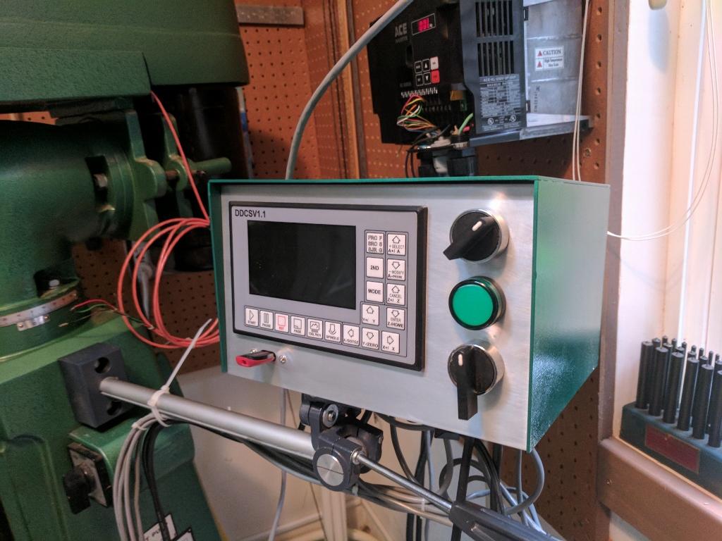

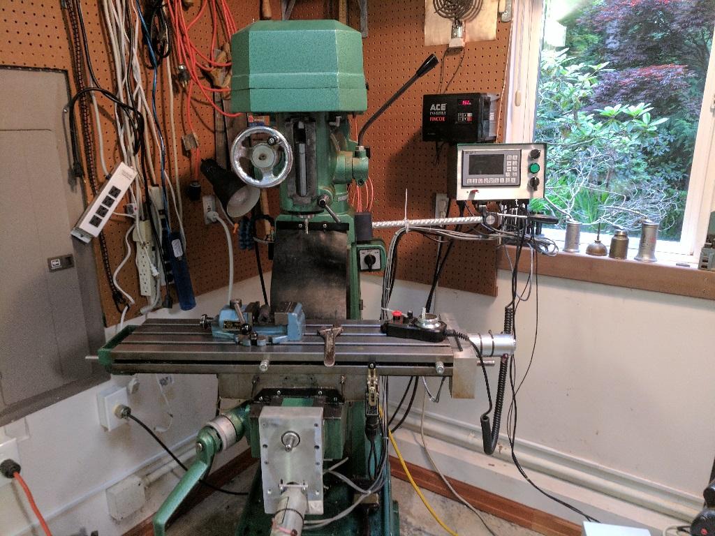

I finally have my Grizzly G1004 small knee mill moving. My goal was to replace the screwing around with Mach3 and a computer with the DDCSV1.1 and end up with a more reliable and simpler machine. To that end I built a little box that contains the controller and my Geckodrive G320 servo drives with a few switches. It seems to work well and the MPG moves the machine well.
The only glitch is the failure of the G20 mode; no inch display and the G20 has a bug.
I think it will be useable because the Fusion 360 cam can spit out metric G21 code whether the design is in inch or mm.

WoW...that turned out nice and clean.  Is what I would think a factory install would look like.
Great job.

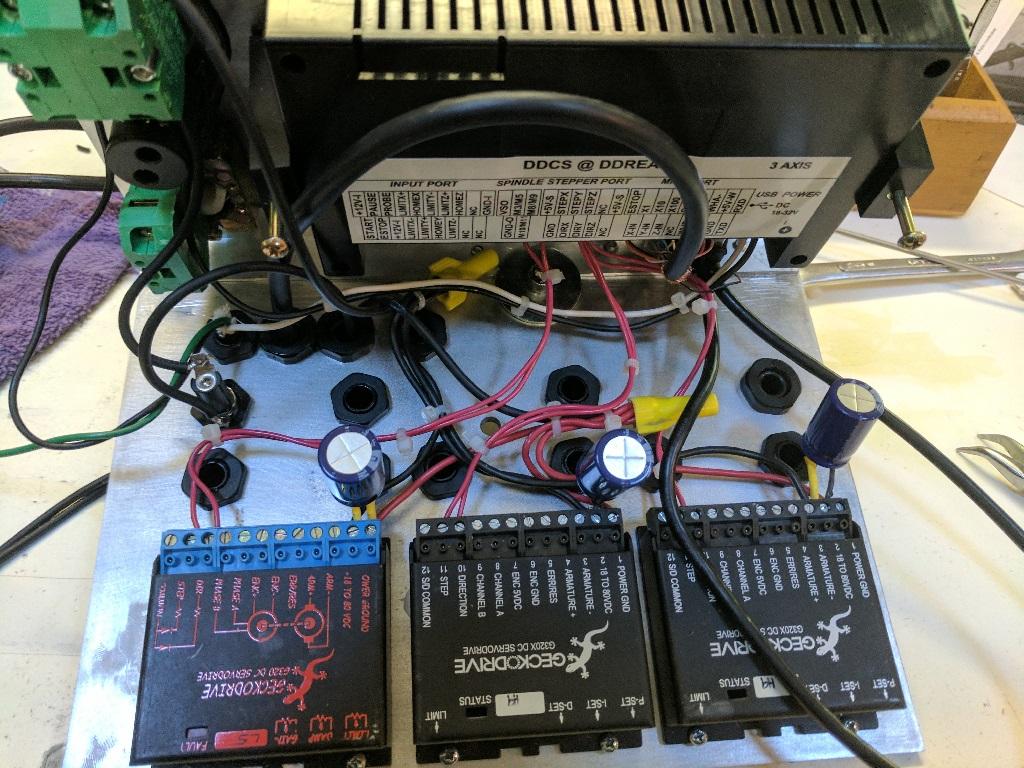

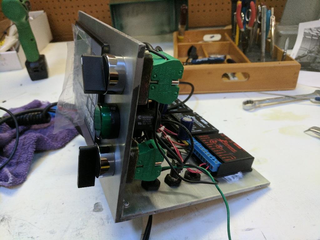

Rob -
Thanks, I was trying for a clean look.

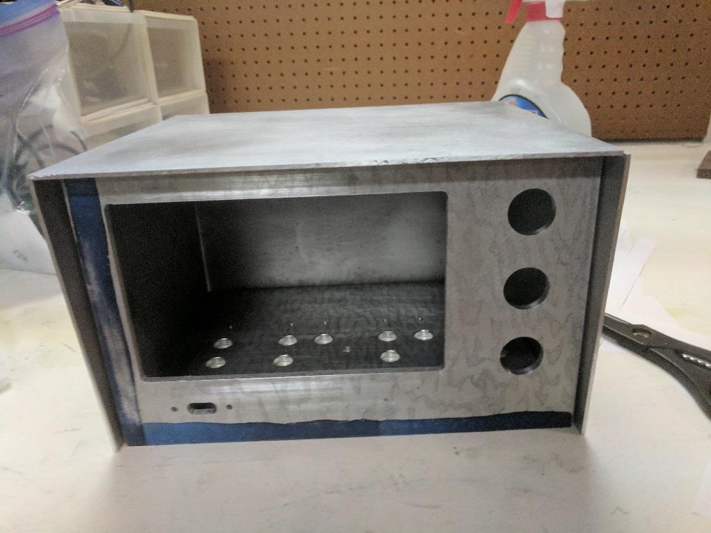

I thought I would post a few photos and notes from the build.
Control box is mounted on a photo tripod head. It is made from painted alum sheet with 3/4 leg alum angle and epoxy to hold it together.
The wiring is a little tight but do able.
I put the USB cable socket too close the the DDCSV, watch out of clearance on the right angle usb connector.
The Geckodrives are mounted on a 3/16 plate with heat transfer paste and are not getting hot so far.
I had this machine running on Mach3 but was constantly having trouble with wiring ( my fault) noise etc. The thing was just not reliable, and this should be better I am hoping.

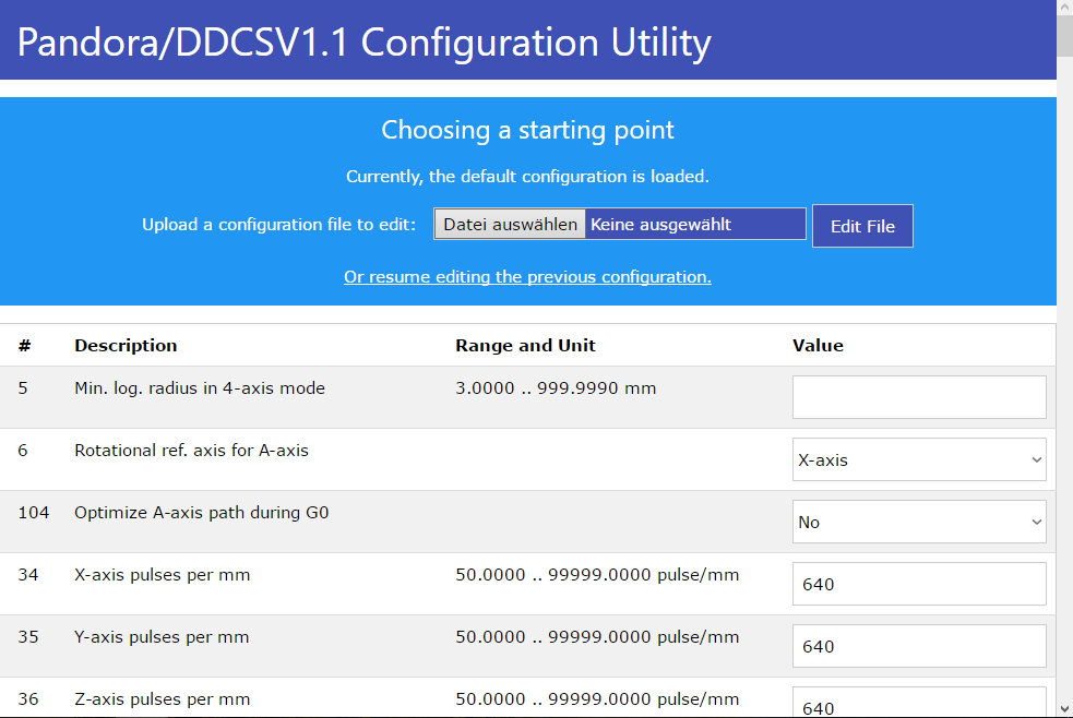

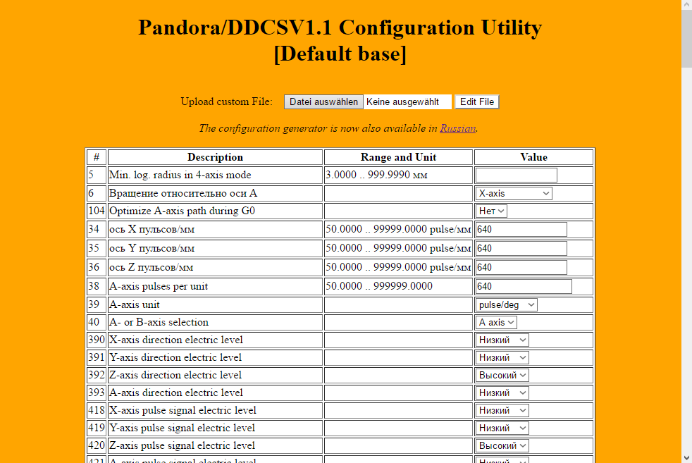

Thanks to riorao, the online Pandora/DDVSV1.1 Configuration Generator is now also available in Russian  :beer:
http://config.pandora-cnc.eu/?lang=rus
It's not completely done yet, but most of the text is already translated.
If anyone would like to translate it to their language, please translate the file below into the desired language and mail it to me (contact-me@bmuessig.eu).
http://config.pandora-cnc.eu/lang/eng.txt

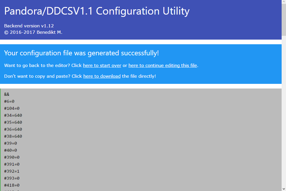

EDIT:
I have now also completely reworked the design of the configurator and made it look a lot more modern. I hope you'll all like it ;)
I have attached screenshots of the new design, but it looks best in person ;)

Does the configurator work with the stock software or only the update?
Offline Benedikt
  • Posts: 200
  • Country: de
« Reply #608 on: June 14, 2017, 05:09:19 PM »
It should also work with the stock software, but there should be no reason to not upgrade ;)
If it will work with our software rewrite is not yet sure. It most likely will do so.
Translated menu items into Russian are not complete enough and not quite right.
I could correct them some points in accordance with the accepted terminology. Send me the original English and Russian translation.
 I think it will be useful to compare 2 translations
Maybe in the future I or someone else will supplement some items of the configurator menu with icons showing the associated function
Sorry for my english, this is Google translator
I have attached riorao's latest version of the translation and the english translation. I have also seen that some translation work is done in cnc.userforum.ru, so you may want to check if they proposed some changes too.
Icons would be nice. If you happen to find ones with a Public domain or simple Attributive license, we could use them.
This is my current todo list for the website:
- Get argument type checking working
- Add translateable user interface
- Detect empty files and ask for translations for the error message
- Add "back to defaults" button
- Change numbers to 3 decimal places
- Keep language choice on backend and especially on continued editing
- Check for NAN in number fields
- Print a leading 0 for decimal numbers between 1 and -1
- Add setting groups
- Maybe add search for parameter number (maybe by having anchors)

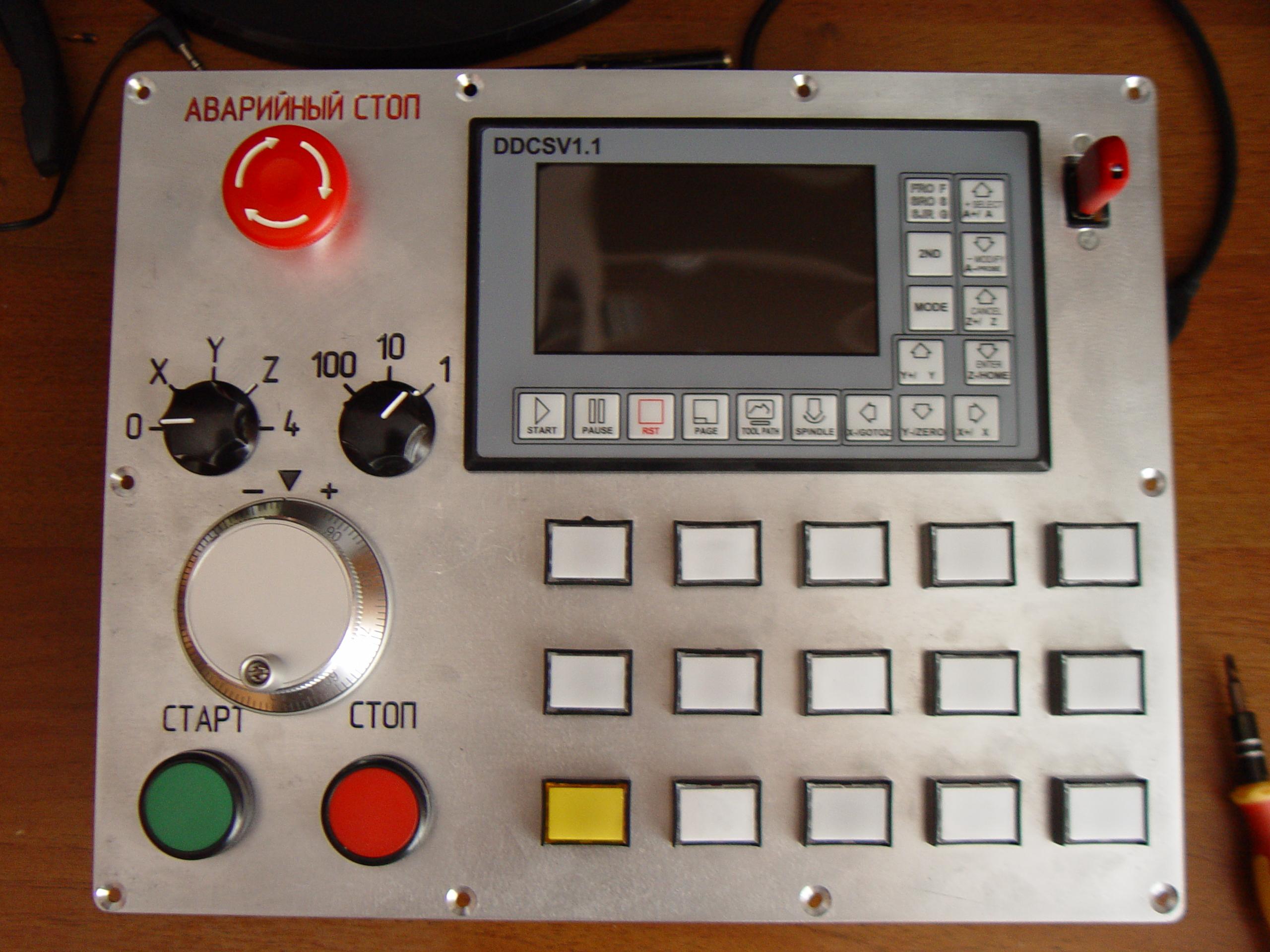

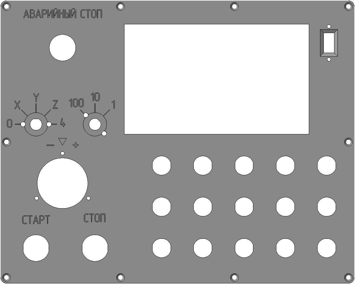

How do you concept? Arrogantly tore the layout from the HAAS rack.

« Reply #613 on: June 21, 2017, 12:23:08 PM »
So many buttons on the controller can not be connected.

They duplicate the controller keyboard, maybe there's nothing to it, but it's more convenient for me.
On extra you can always connect something else.

I like it.  Is that going to be mounted into a cabinet?
You mentioned some of the new keys duplicating some of the buttons on the control.  Please share details on how that it done.

Yes, it will be connected to the my CNC machine
Buttons duplicate the keys of the controller to make it easier to work with gloves. On the free you can connect functions such as forced on / off cooling, dust extraction, vacuum, etc.
New functions do not apply to the controller, the panel simply provides buttons for control.

« Reply #624 on: July 01, 2017, 07:01:28 PM »
Thank you Benedikt, I most certainly will be giving your modified version a try! Can't wait to see it! I will also try your suggestion regarding my configuration. Hopefully that will help.  :doh:
So for the configuration trick, you may want to simply leave the default value for the steps/mm (note that even if you use inches later, you will have to enter this in steps/mm).
Now, before submitting the form, write down the numbers associated with the values you want to set to a unrecommended value.
Then use a text editor that supports Unix line endings (on Windows, please use Notepad++ not the default Notepad that ships with Windows) and adjust the values associated with the numbers you wrote down earlier.
Now, save the file to an USB stick and call it userVar.set and safely remove the USB.
Finally, insert the USB stick into the controller and go to the file manager. There, locate the file, highlight it and press Enter.
