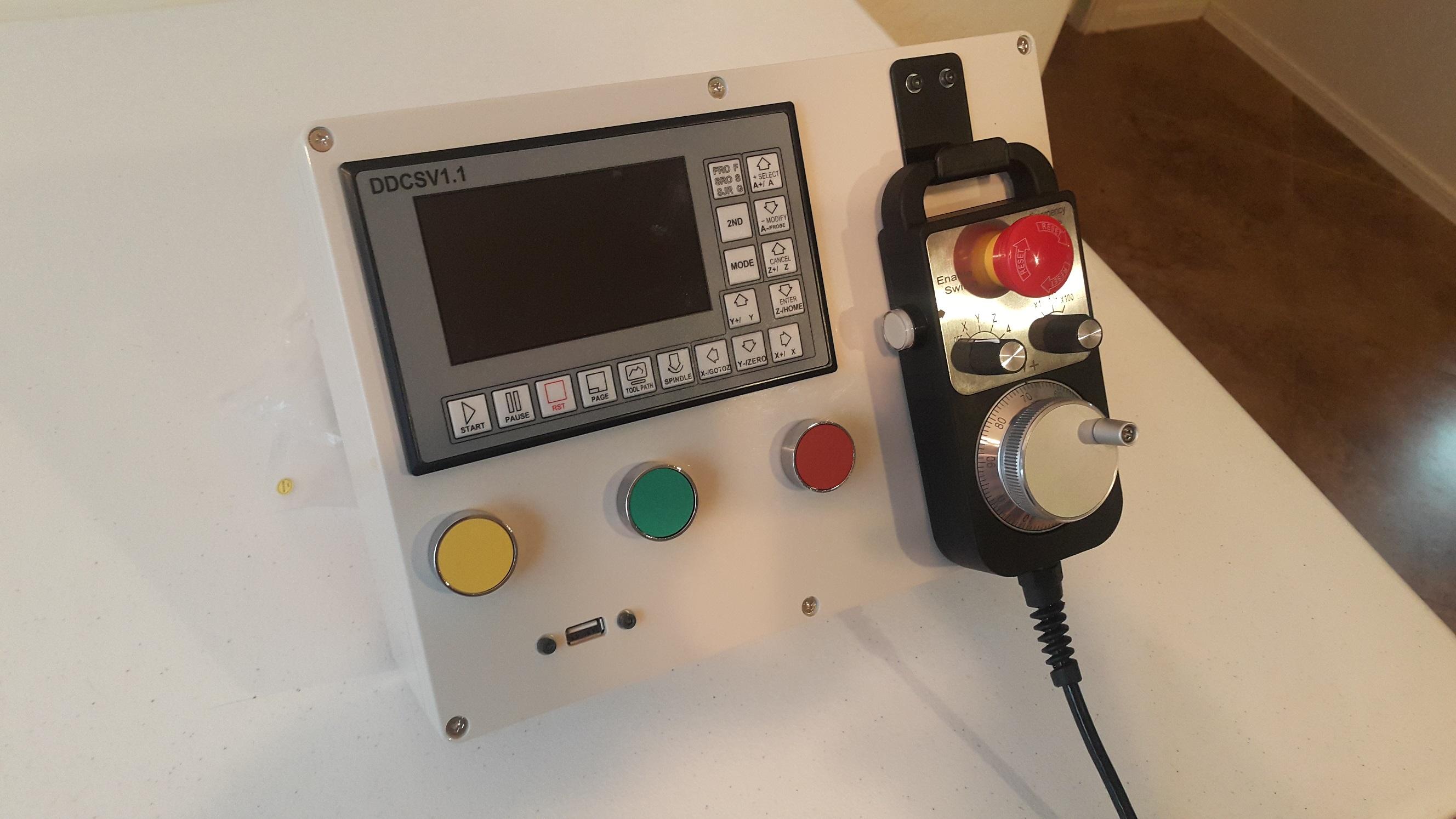

Finally getting to set mine up

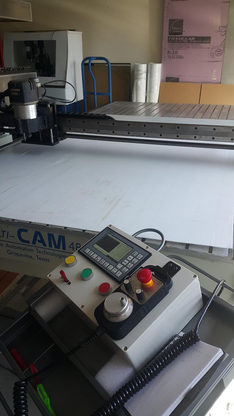

Hey group, so some advice on the internal vs external power, im converting a Multi-cam cnc router to our loved ddcsv. to original control is from 1998 and has to be drip feed... and sucks with fast 3d moves. I've built many CNC mills etc from the ground up but this one im doing more of a conversion reusing 90% of whats there it has nice IMS drives and power supplies and magnetic home switches etc.
So here is my question the drives have a nice 5v supply already tie'd to drive for the opto (3 wire 5v+,step,dir) can I leave the 5v from the PSU and not use the 5v from the DDCSV, as the grounds will still be the same so the signal will be driven low either way. second is the home switches, they are magnetic 3 wire but are tied to the 24v psu will the home input take a 24v v.s the 12V as noted and supplied from the ddcsv, I would hate to need to swap these out for 12v ones, or I can try and source a level converter. Basically, there is a real nice5/12/24v PSU all wired up already in there and am wondering if I can/should use it v.s the DDCSV power outputs and only tie the signals in, my concern is some of the loads such as these 1998 magnetic switches and opto drives may pull more than the DDCSV step down regulator is putting out.

homing set up issue, so ive converted my Multicam and its moving great but im having an issue with homing, when it home's the dir option is reversed from noted, causing the 10mm retract to be added so it see home then jumps 10 more mm in the same direction instead of backing up. There is no way to add a neg value if I switch the homing direction pos to neg it rev the 10 mm as it should but the issue is the axis is then homing the wrong direction. basical if you tell it to home y to a neg direction it homes pos its rev even tho all axis move correctly and then the bounce back is wrong. Also seams there is no way to do a home offset. my mach has the X axis home at full pos (right side) forcing me to use right for zero vs left. is there any way to add a home offset. I guess in g54 it does not matter anyway but I just like it to all lineup. to fix the bounce back issue i just set it to zero so it does not move after home.
Offline chriscnc
  • Posts: 39
« Reply #666 on: September 09, 2017, 11:06:43 PM »
Also homing speed also does not change, the speed its stuck at 50mm/m
Offline tklus

Hello, thanks for your time on the DDCSV. I have mine all set up on a Multicam router.. motion, homing, probe, M3 and M8 all works great..... but am having issues with motion processing arcs. every time there is an arc and goes from an arc to a line it jumps over this is not an electrical/mechanical problem, it even shows it in the display it is doing it. I've tried many posts in fusion from Fanuc to Jays and all do the same thing. Its very frustrating and makes the control unusable. any ideas why it's doing this? is anyone else's doing it also with arcs? I've attached a pic of my router, the screen that shows the jump at arc ends, the g-code and fusion file. Any help would be great or im back to using the 1995 drip feed control or mach conversion. such because its a nice unit if the software worked. I may jump on a SMC-4-4 I hear those have no issue with gcode?
Thanks much

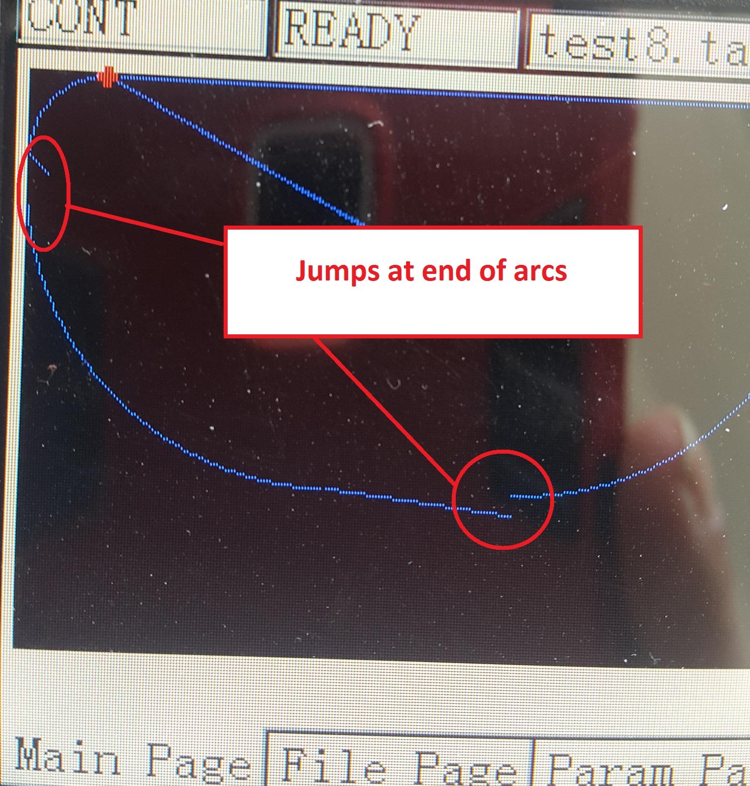

Messed with it all day all G02 moves regardless of the code are breaking the arc's made 3 different parts/G-Code and all have the same issue I've run the code through simulators and it works fine. Ive run a few different post processors and same results. One thing may be my firmware is newer, so maybe its a problem with the firmware. if some one could please run the code and look on the draw screen and see if the outer line is broken on the end of the arcs.  thanks much if it's my firmware I can just load an old version from the link in this forum
(Program: 1001)
(Toolpaths: 2D Contour3, 2D Contour4)
(Units: millimeters)
(Tool: flat end mill, D=3.175 CR=0.000)
(Workpiece:   0.000 <= X <= 152.000 | 0.000 <= Y <= 70.829 | -10.000 <= Z <= 0.000)
(Tool travel: -0.587 <= X <= 152.587 | -0.587 <= Y <= 72.369 | -10.000 <= Z <= 15.000)
(Safe Z: 15.000)
G90
G21
G64 P0.0254
G00 Z15.000
S 10000
M03
(--- 2D Contour3 ---)
S 10000
G00 X76.027 Y49.141 Z15.000
G00 X76.027 Y49.141 Z5.000
G01 X76.027 Y49.141 Z1.000 F762
G01 X76.027 Y49.141 Z-4.683
G01 X76.048 Y49.129 Z-4.804
G01 X76.106 Y49.093 Z-4.907
G01 X76.194 Y49.039 Z-4.976
G01 X76.298 Y48.975 Z-5.000
G01 X76.569 Y48.810 Z-5.000
G03 X77.005 Y48.915 Z-5.000 I0.166 J0.271
F2500
G02 X78.360 Y49.674 Z-5.000 I1.354 J-0.828
G01 X88.613 Y49.674 Z-5.000
G01 X88.613 Y50.723 Z-5.000
G01 X63.419 Y50.723 Z-5.000
G01 X63.419 Y49.674 Z-5.000
G01 X73.623 Y49.674 Z-5.000
G02 X75.211 Y48.087 Z-5.000 I0.000 J-1.587
G01 X75.211 Y18.107 Z-5.000
G01 X76.772 Y18.107 Z-5.000
G01 X76.772 Y48.087 Z-5.000
G02 X77.005 Y48.915 Z-5.000 I1.587 J0.000
F762
G03 X76.900 Y49.352 Z-5.000 I-0.271 J0.166
G01 X76.629 Y49.517 Z-5.000
G01 X76.525 Y49.581 Z-4.976
G01 X76.438 Y49.634 Z-4.907
G01 X76.379 Y49.670 Z-4.804
G01 X76.358 Y49.683 Z-4.683
G00 X76.358 Y49.683 Z15.000
(--- 2D Contour4 ---)
S 10000
G00 X17.238 Y72.369 Z15.000
G00 X17.238 Y72.369 Z5.000
G01 X17.238 Y72.369 Z1.000
G01 X17.238 Y72.369 Z-9.683
G01 X17.238 Y72.345 Z-9.804
G01 X17.238 Y72.276 Z-9.907
G01 X17.238 Y72.173 Z-9.976
G01 X17.238 Y72.052 Z-10.000
G01 X17.238 Y71.734 Z-10.000
G03 X17.556 Y71.417 Z-10.000 I0.318 J0.000
G01 X136.000 Y71.417 Z-10.000 F2550
G02 X152.587 Y54.829 Z-10.000 I0.000 J-16.588
G01 X152.587 Y43.500 Z-10.000
G02 X108.500 Y-0.587 Z-10.000 I-44.087 J0.000
G01 X43.500 Y-0.587 Z-10.000
G02 X-0.587 Y43.500 Z-10.000 I0.000 J44.087
G01 X-0.587 Y54.829 Z-10.000
G02 X16.000 Y71.417 Z-10.000 I16.587 J0.000
G01 X17.556 Y71.417 Z-10.000
F762
G03 X17.873 Y71.734 Z-10.000 I0.000 J0.317
G01 X17.873 Y72.052 Z-10.000
G01 X17.873 Y72.173 Z-9.976
G01 X17.873 Y72.276 Z-9.907
G01 X17.873 Y72.345 Z-9.804
G01 X17.873 Y72.369 Z-9.683
G00 X17.873 Y72.369 Z15.000
G00 Z15.000
M5
M2

The code is correct, I've tested it on other simulators and my tormach... the controller is just having issues with transitioning from a G02 move to a G01 move the straight line is always shifted off and broken. My firmware is stock as it was newer then the latest revision here so I didn't change it as there were notes from benedict he was porting the newer firmware, I just wonder if it is my firmware, I would roll it back to the modded one here if I knew it worked.

Chris, sorry you are having problems with this.  I know too well how stressfull these things can be.
There are a couple/few different ways to output an arc move in a cnc.  Some controls are finicky about what they like...and I have already found out this is a finicky one.
Here is some code I run fine in my machine.  Please give it a try and let me know if it works correctly for you.  It is in metric units.
Set the G54 anywhere you want on the table and set the z height anywhere above the table.  The program cuts down to Z0.0 so it should not hit anything.
edit:
The comments in the code below indicates a large material size, but just disregard that.  The program only profiles a 6" x 6" box that has .5" corners.
