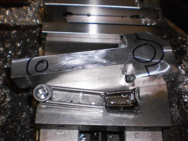

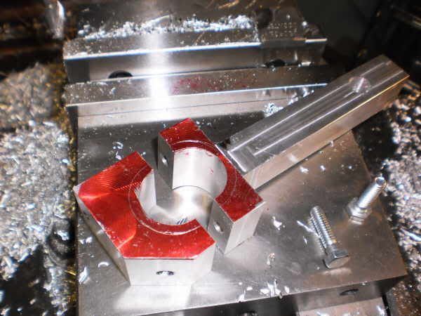

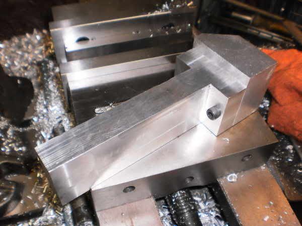

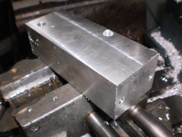

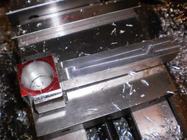

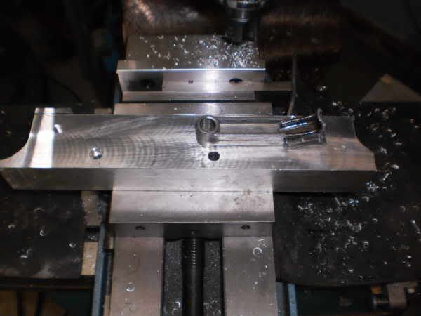

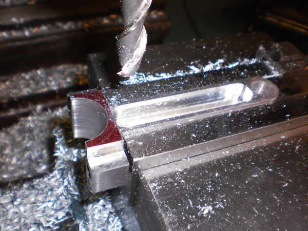

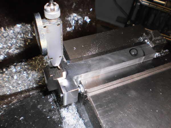

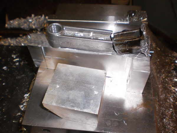

Awhile back I was working in the shop and the compressor kicked in and boom made some really load snapping noise.

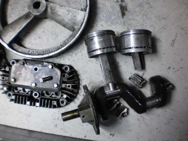

I pulled it apart and found it had snapped one of the rods first I thought ah crap there goes about 800+bucks to replace it.
Then I thought oh what the heck I have nothing to lose I'll attempt to make a replacement as I was told that there were no replacement parts to be had.
What I found when tearing it down.
I think there is a rod in there some where.

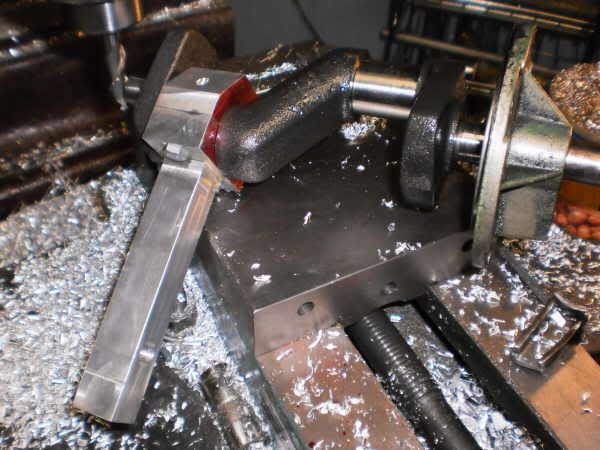

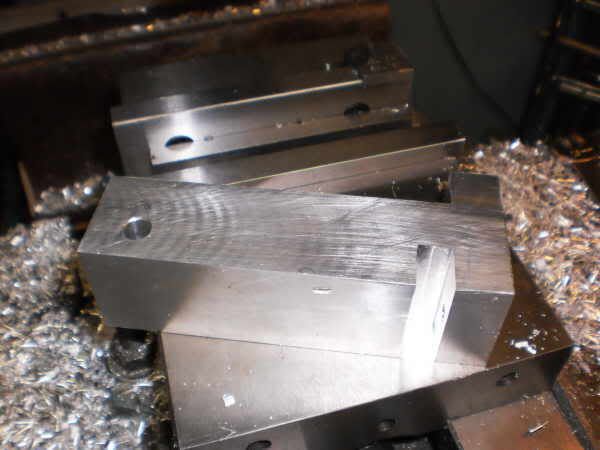

Made a piece to bolt on end as rod cap.

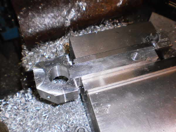

Remove rodcap pickup edge. Put cap back on and bore crank shaft hole.
First fit check to check the bore size feels ok good to continue.

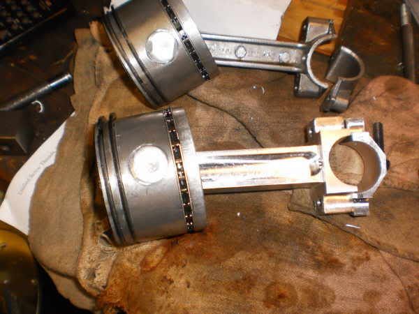

Try to take some weight away.
It worked out really well its been in service for almost a year now.
George

Now I know how to use "chair", just over picture caption "Remove rodcap pickup edge. Put cap back on and bore crank shaft hole.".

George, do you have any idea why it snapped? It seems an odd failure mode if nothing else was damaged. No sign of the main bearing or piston seizing?

« Reply #20 on: March 11, 2016, 05:41:15 PM »
HI All,
Nice Job :clap:
My thought on the failure is that theres a fairly sharp corner where the rod and big end meet
Usual conrod design is to have a large radius there??

« Reply #21 on: March 11, 2016, 07:14:44 PM »
I am not sure why it failed I'm thinking it had a crack and it just kept growing until it failed. When it failed it had been running quite a bit that day. It was not low on oil and the journal area was not scared up so who knows why?
George
