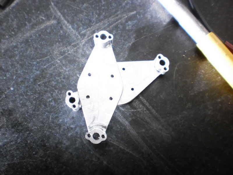

Ok I started the water pump assembly. I ended up only getting about an hour and half in the shop (always something) Anyway did get the first side done.
George

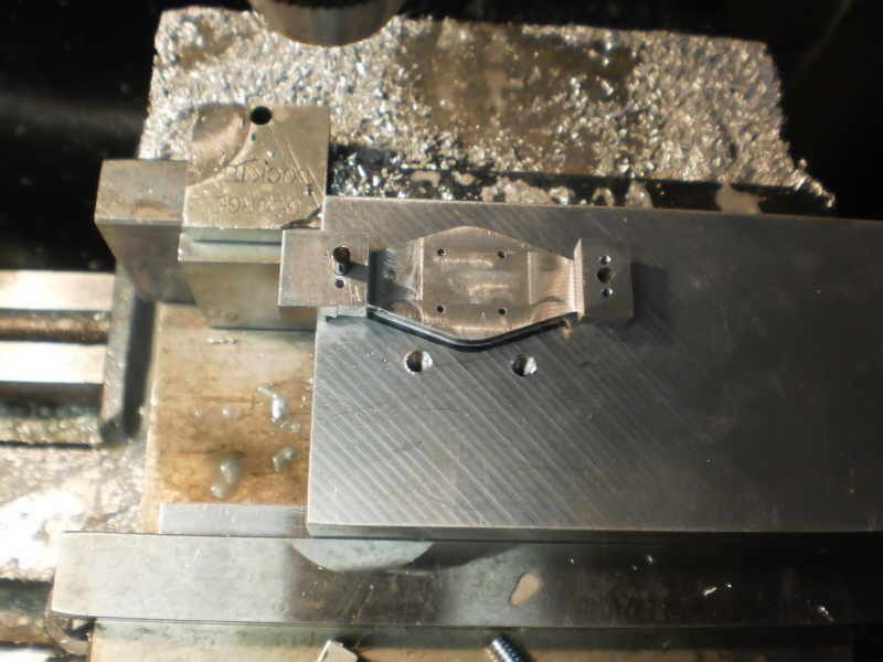

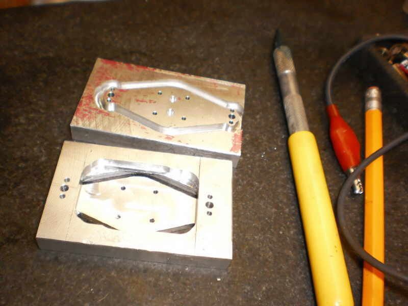

Ok got the first half of the pump done to day and got the second half all modeled up and the first operation for it programmed.
On the first half of the pump I flipped it over and milled a pocket on the back side.

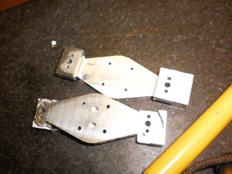

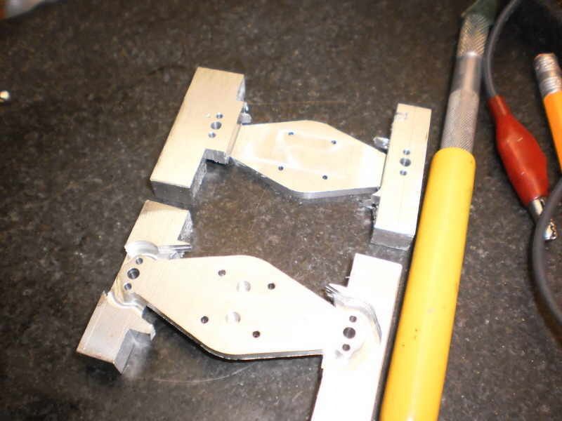

Then cut the side pieces away.
And then cut the tabs down on each side.

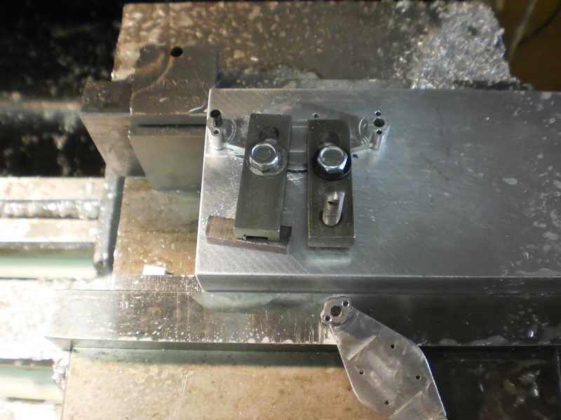

I made a little fixture plate to load on the water passage holes I drilled them to .125 instead of .1 to locate on them.
I'll probably do the second half about the same way.
