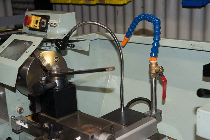

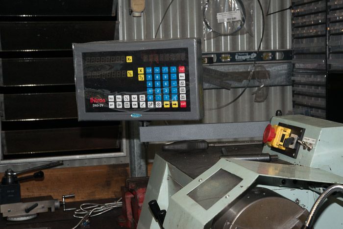

I ave spent the last few days doing upgrades to my lathe as I fitted a DRO to it. While I was at it, I revisited the flood coolant and light.
Anyway, as promised, here is what I tidied up today.
The pipe riser, tap and nozzle came with the coolant kit which I fitted about 6 months ago. Pipe is 3/8"
the light is a cheap $14 LED reading light I got from Officeworks in Oz.

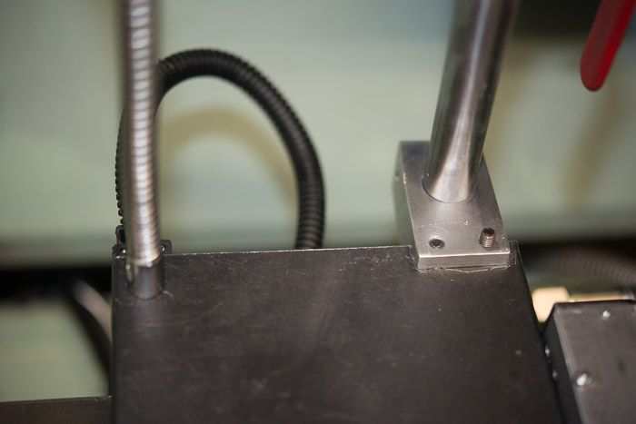

The cover on the back of the cross slide is just pressed metal. The light was easy to fit, it just needed a 10mm hole to mount it up after I removed the clamp that was fitted to the light.
Here is a closeup of the mounts (I need to get one more 8mm screw)  :loco:
I used black split conduit to protect the light wiring. I wish I could get conduit like the DRO cabes
the OD of the pipe riser is 17mm and I did not have a drill or endmill that size. The closest I had was an 11/16" one (17.4mm). I split the housing with two cuts of a slitting saw and left a 3mm slot. Placing it in a vice squashed it in enough to grip.
I had to add an elbow so the hose did not hit the splash guard when it was right to the rear.

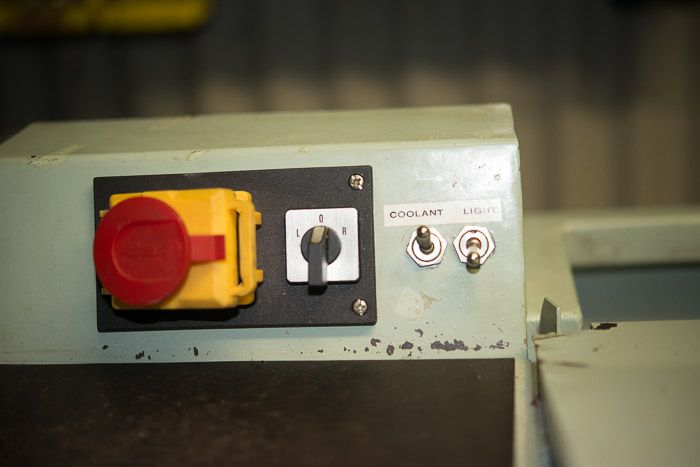

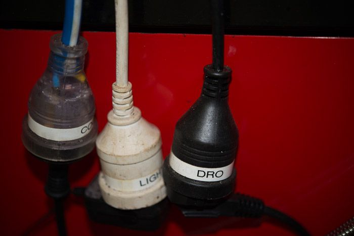

You may have noticed a couple of switches in the background
these go  to some leads at the back of the lathe
The DRO is always on and has no switch.

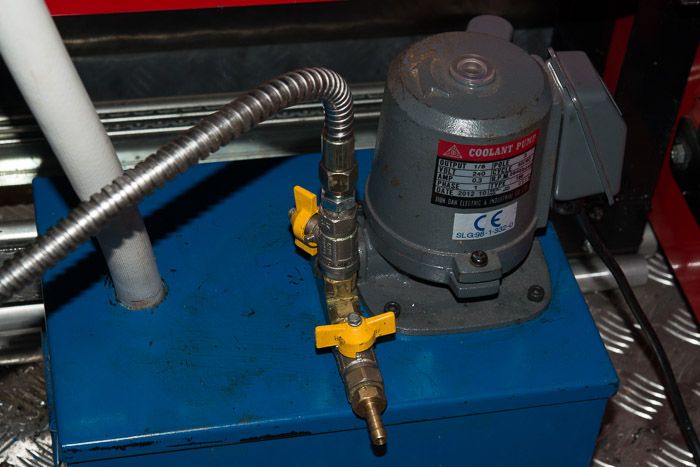

Hi Folks,
I like the variety on here, and the many ways of killing mice, gladly don't suffer from those though.
Wondered if you might like to see an alternative approach to flood cooling...
I use a Central Heating Circulation pump, just loosely placed in the motor housing on my Master, I welded an outlet into the integral coolant tank, and attached a valve.
The rest is pictorial really, the drain from the miller goes straight onto the Master tray...
I should also add that to relieve pump pressure I split the black rubber hose, aimed down into the fluid below..
It's not possible with my VFD setup to use both machines at the same time but the flood coolant doesn't know this.. :lol:
