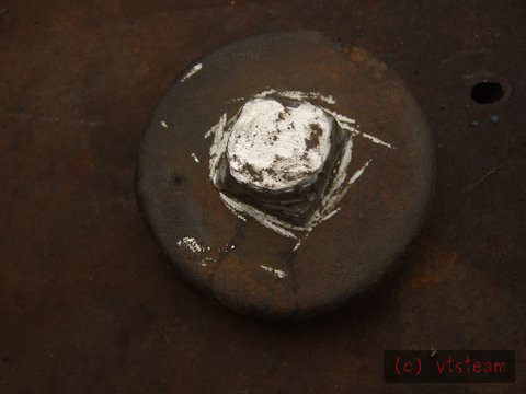

So the first real project of the day was to drain the oil. That proved a real bear! I could not get a wrench to turn the oil drain plug.  You know how it is, lying on the dirt under the tractor, trying to stay far enough away that an accidental oil gusher misses your face, trying first an open end wrench -- no size seems to fit, or turn the plug, everything is too large or too small. Then trot up to the house to get a pipe wrench, since this seems like it must have been a square plug at one time, now rounded over. That doesn't work (a first -- it will even turn pipe, how can it not grip this plug?) then vise grips. They clamp, then slip.
Doggone it! How do I get this off. Then I notice chisel marks along the rim of this weird plug. Oh so that's it! Bang it round with a chisel.
So I dig around in the shop and return with a cold chisel and a hammer and start banging. Not easy hammering in that position, and I hit my wrist a good one at one point. Eventually the plug begins to budge but takes three more hits to really come loose.
Once it's out I can see the problem, It's just a soft cast iron plumbing drain plug with a rubber washer, and all of the square corners worn off -- it's huge by today's standards -- 3" across:

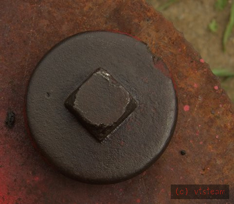

Well I don't want to put that back in and have to rely on a chisel to drain the oil in future. I briefly consider milling the sides straight again, but realize the square plug is cast hollow, and there isn't enough meat to mill off the rounded corners.
So I decide to fill in the corners with new weld metal. It's a small piece and I think I can get away with using 7018 rod to build it up, without cracking. So I clean it in MEK first and use the grinder to get to clean metal preparatory to welding:

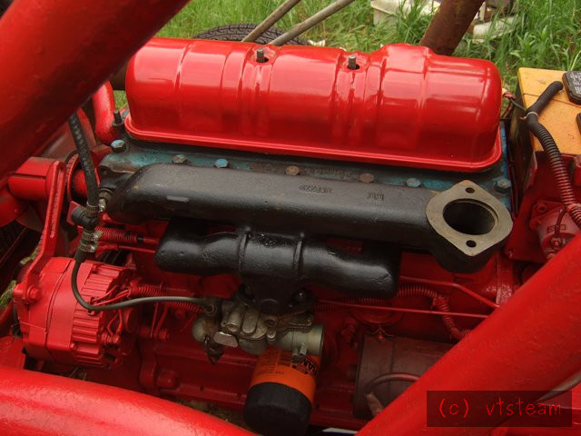

The welding went successfully, and I ground the sides and corners square again. Sorry I forgot to take a photo. I painted the plug, and an hour later reinstalled it in the oil pan. A 1" open end wrench fit it perfectly.
Because the old oil was such an evil looking mess, I decided to give the engine a rinse with some kerosene. I poured two  quarts in and let it sit a couple hours before draining again. I think that really helped clean the pan better, from the looks of it. Finally I re-tightened the drain plug and added 5 quarts of fresh oil to the crankcase.
I also changed the oil filter and started the manifold onto its studs:

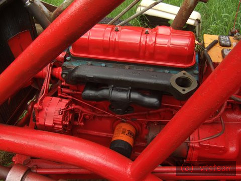

I put the Zenith back together again, and decided to torque the manifold first before mounting the carb. Another simple job that took longer than anticipated. The old manifold had come loose easily with just a socket wrench and extension. But the new one (made in Turkey) seemed to have bigger passages and thicker cruder castings.
As a result, the socket wrench could no longer be used for all the bolts. Some needed a box end wrench, some needed an open end, and there was barely enough room to turn some of the nuts even then. One washer had to be omitted because there just wasn't room for it. I couldn't torque it because I couldn't get a socket on all the bolts. So in the end I just had to estimate.
At about this time my weather/emergency radio started beeping furiously in the shop. I at first thought a piece of equipment was sounding the alarm -- though I actually don't have anything like that! Finally I realized i was the emergency radio. I hit the button and got a message from the emergency management system that a really bad thunderstorm was approaching the county just to the north of us. 60 mph winds, and golf ball sized hail they said! Also it was in slow rotation, and they would issue additional warnings if a tornado started to form.
Time to put away tools and cover the tractor. I had just got the carburetor mounted, and grabbed a photo before chasing down the tarp, which the wind had moved to a nearby bush. Here is the tractor at the end of the day:

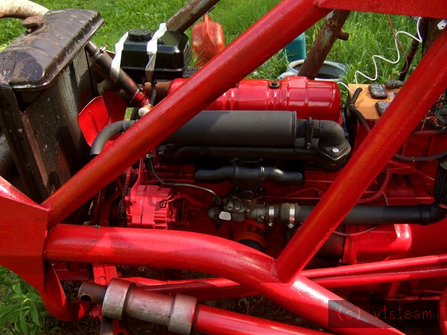

Today I got the muffler and headpipe off the old manifold an put it on the new one, connected up the thermostat housing with a new gasket, reconnected the radiator and a new temperature gauge and a new oil gauge, and then spent a good long while adjusting the valves.
You do this by turning the crankshaft with a wrench and watching the valves -- the manual spells out which two should be open, to adjust a different pair, then turn crank and repeat for another pair, etc. four times. Spec said between .016 and .018 so I used both those feeler gauges for go-no go setting.
Ran into a problem with one adjuster that had some kind of thread locker or something in it, don't know why, these all have lock nuts. Anyway got that cleaned out and cleared up.
Put new grommets on the valve cover studs, new cork gasket in the valve cover. Cranked that down. Then I went and found a new small engine gas tank for testing the motor -- I didn't want to mount the tractor tank quite yet -- it makes access a lot harder and the valves are supposed to be readjusted again hot (and idling!) Looks like I'll need 3 hands for that -- one on a screw driver, one on the lock nut wrench and one holding the feeler gauge while getting burnt on the exhaust manifold  :scratch:
I mounted the small temporary tank with fiberglass strapping tape (the new bailing twine) added a new fuel filter to the line and added about a cup of gas, feeling a bit conservative. Poured water in the radiator to fill, and then tried to think of what else I should do, besides press the starter button.
