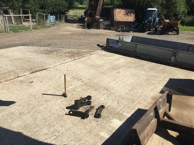

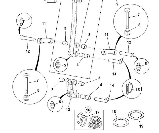

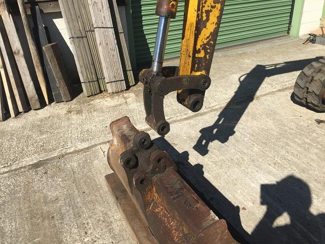

So today's job was to remove the old bushes from the dipper, along with the 'banana links' and the 'bucket 'H' frame'
This is the general arrangement:

« Reply #32 on: June 30, 2015, 02:59:14 PM »
First job, drop the bucket - then strip everything off
  • Posts: 8967
Re: JCB 803 Saga
« Reply #33 on: June 30, 2015, 03:09:24 PM »

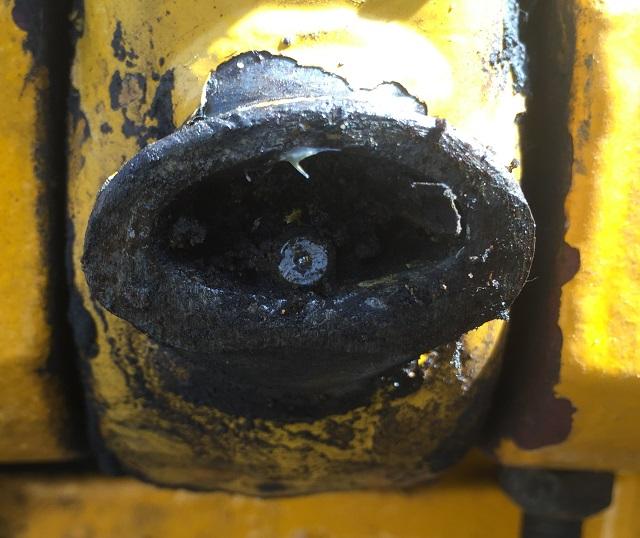

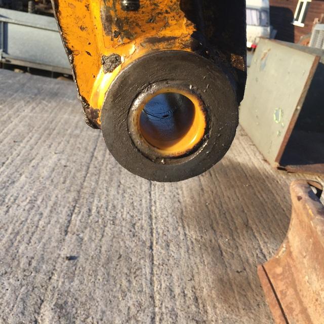

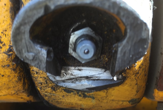

So not too bad really just rather mucky. Now that lot were off I could inspect the various bits that wear. The bush location in the end of the dipper arm was worst being somewhat ovaled, as was the rod eye on the bucket ram to a lesser extent.
Long term both these will have to come off and (somehow  :bugeye: ) got onto the Bridgeport table and bored oversize for bushes to be loctited in, but to keep the job going forwards, for the time being I turned up a bush for the rod eye that largely lost the wear, and used magic on the dipper end  :ddb:
Magic in this case being Devcon Titanium loaded epoxy putty. The wear bush is a nylon sleeve, the original having completely vanished !. New one was a reasonable fit except for the outer inch or so where it bellmouthed. I pressed the bush in and packed the Devcon around and into the wear cavity, making sure that the grease passage was still free. I very much doubt it'll last long, but the stuff is rated at 105 Mpa compressive force and specified for building up bearing housings so we'll see  :scratch:

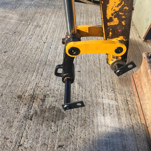

  • Posts: 8967
Re: JCB 803 Saga

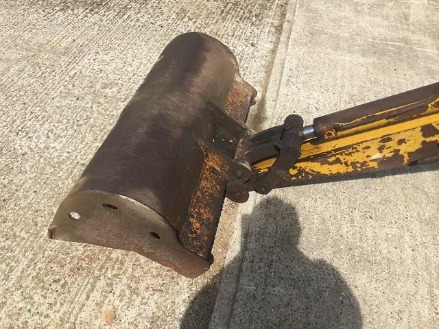

« Reply #34 on: June 30, 2015, 03:22:01 PM »
The Devcon has already set rock hard on my 'control sample' that I left on the bench, but I'll still leave it a full 24 hours before I re-swing the bucket.
Pressing the second nylon wear bush into the end of the bucket H frame compressed it enough that it would't pass a 35 mm bucket pin  :bang: Fortunately I have a 35 mm reamer, albeit on a 4 MT, so I passed that through the bush with a spanner on the tang - it's still very tight but no doubt a bit of use will sort that out  :clap:

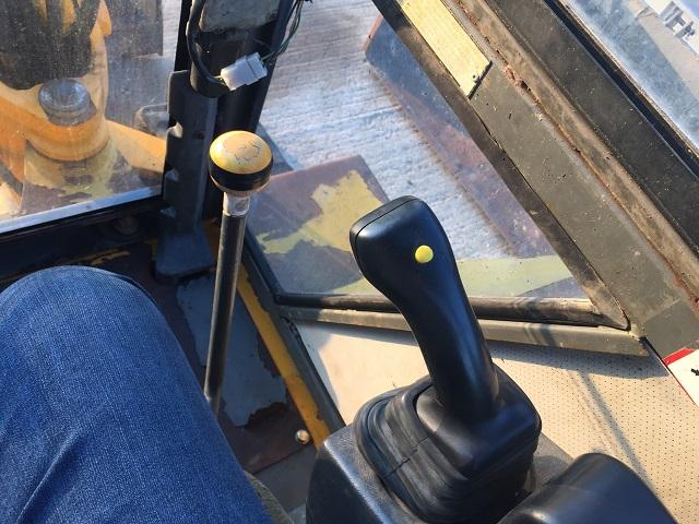

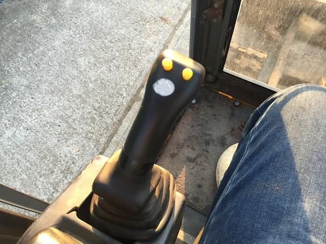

Then after I'd cleaned up a bit and fed the pigs, fitted that replacement right hand handle complete with it's custom moulded button, and also put the jazzy button tops on the left hand handle

Steve, that's very encouraging. My concern is how far I managed to force the putty down the side of the bush - its quite stiff and there undoubtedly will be voids. It's a nylon so wont be able the bridge cavities !

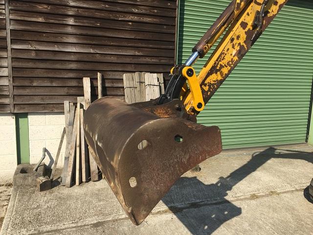

Put the wide ditching bucket back this morning before  breakfast, and it's all remarkably tight with virtually no wobble. A bit unsettling as I've only used diggers with wobbly buckets before where positioning was a bit hit and miss.  bit of use and the play will come back I'm sure.

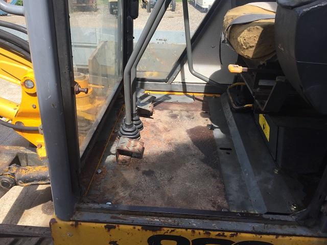

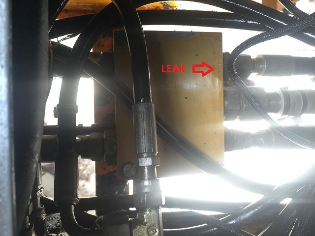

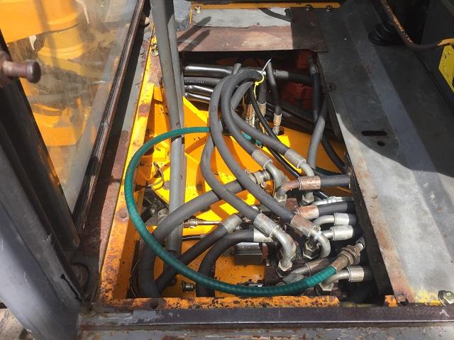

The bad news it it's developed another oil leak  :bugeye: - I noticed oil dripping onto the left hand track. After a lot of fumbling about and wrapping dry towel around fittings one by one I've located it on the Main Relief valve block where the input from one of the pump sections enters. (This machine has three hydraulic pumps all on the same shaft on the engine). It's either the 'O ring' in the face seal on the pipe or the bonded washer seal where the pipe adaptor screws into the valve body.
Fortunately there is a removable section of floor to the left of the drivers seat giving access from above, and it's fairly open below if the cab is slewed to 45 degrees so that it's between the tracks. However try as I might I cannot get the fitting unscrewed  :bang: It needs special pipe fitting spanners.
Special man with special spanners coming tomorrow (same chap who did the hose on that Hedge Flail last year.)

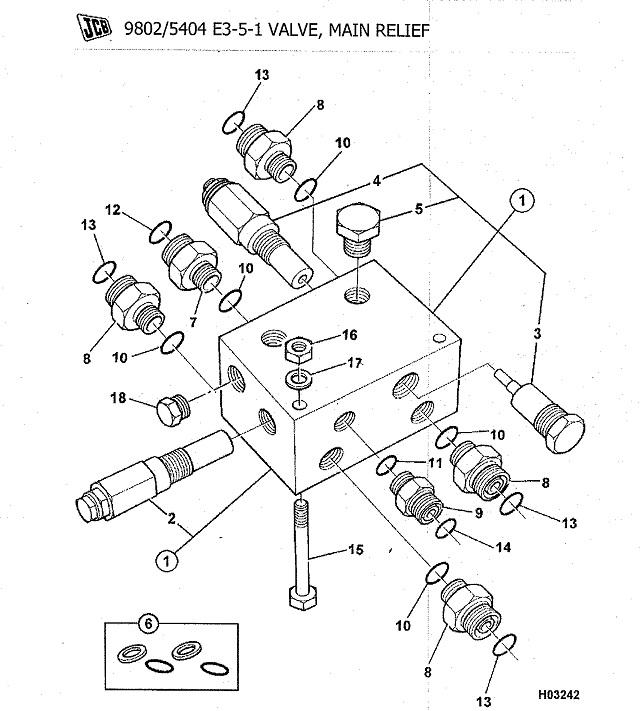

Well this is going from bad to worse  :bugeye:
Mr Spanner had van problems (Ford ECU packed up) so only got here today at lunchtime - got the fitting out only to find that the actual leak is the main aluminium housing having a crack adjacent to the fitting  :bang: :bang: :bang:
Needless to say they are like hens teeth, and every machine being broken currently seems to have been robbed already. JCB want about a grand for just the block without any of the gubbins.
Theoretically it should be possible to reverse engineer the existing block and make a copy, but in practise there are so many interconnecting threaded bores, most with a seat cut at the inner end for a relief valve or pressure setting valve that the chances of success are slim. It runs at 3000 psi so needs to be sound.
Talking to specialist breakers this seems to be a known problem, especially in hot weather. When did it happen - hottest July day on record  :(
At the moment my hope is with a breaker in Wales who thinks he may have one of unknown goodness, but still £250  :bang:
It's tempting to strip it down and attempt a repair using one of the low temperature aluminium solders - probably mill a channel with a ball ended cutter and fill the trench. (I think TIG welding is likely to distort things too much).
If the breaker turns up trumps, I'll fit his, and if it works use it, and if not attempt a repair on one of them.
In all not a good day  - the replacement tracks, idler sprockets and drive sprockets arrived yesterday so I'm in too deep to stop now - it's a bit like the addicted gambler who has to double his stake every time he looses to keep up with his stake :scratch:

Matthew I'd be very wary of tigging or any other high temperature method unless I had a second block to fall back on. There are (seemingly) reamed bores in there for the various valves to seal onto that can easily be distorted, and I suspect seats for valves at the base of some bores.
Until the whole caboot  is stripped I cannot be sure exactly how things connect up in side. There is a 'main pressure release valve', a (logically) T shaped one way valve pair, and a bit I don't fully understand that changes the pressure setting dependant on how much oil is demanded from each of the three pump sections - I have the hydraulic diagram but translating it into physical reality isn't simple.
I want to try and set up my Gopro camera pointing at  it to see exactly where the oil emerges as once it starts everything gets covered and the forensic trail gets blurred  :bang:
It's been suggested that I could replicate it using standard hydraulic components 'off the shelf' but I have a feeling it's made as it is as it's operation is more subtle that that approach can achieve.
