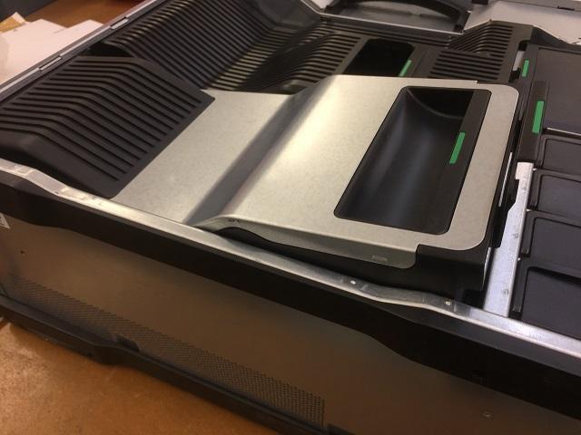

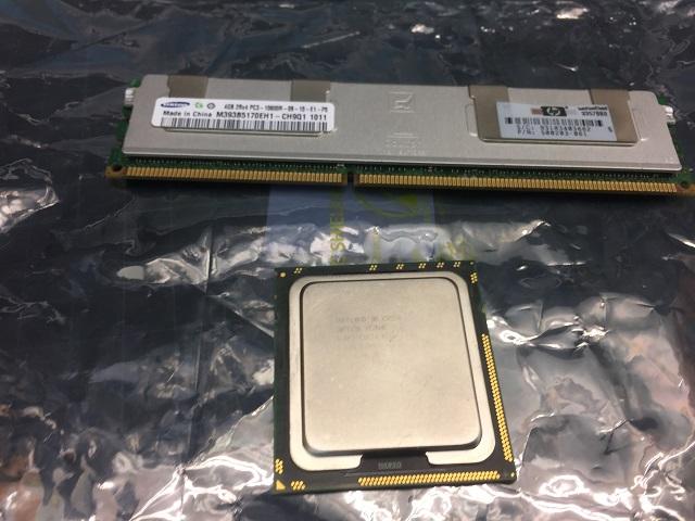

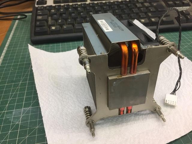

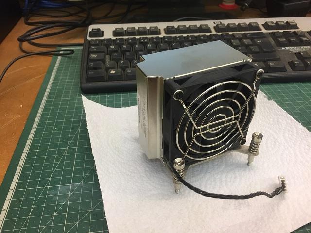

So my CPU fans, six off 4 Gb DIMM's and two  Xeon X5550 cpu chips arrived today along with the obigatory Anti Static wrist strap and some sachets of thermal paste.
Should be a nice easy upgrade - open the case, remove all the cooling air ducting, pop the DIMM's in the right slots, remove the protective cover from the extra FCLGA1366 CPU socket on the mother board, pop on the X5550, some heat paste and the cooler. Put back the ducting and boot it up again.

Re: Windows 10 Pro Classic Shell
« Reply #15 on: June 14, 2017, 09:44:40 AM »
Heatpipe thinggy?
  • Posts: 8970

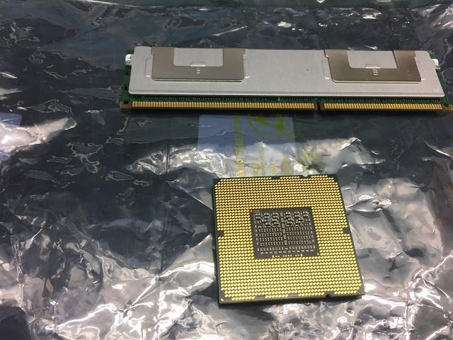

So boot it up, and I get a bios report of "CPU1 DIMM3 Incompatible"  :bang:
No big issue - they were cheap secondhand (though genuine HP spec) units and I can only fit five of them anyway bringing the total complement to eight x 4 Gb = 32 Gb - so replace the DIMM with the spare.
..... SAME error report  :bang:
Swap DIMMS about in case there are two faulty ones - SAME error report  :bang:
OK who says it's the DIMM memory unit itself at fault - it could be the newly installed XEON X5550 CPU, after all it has umpteen channels direct to the memory.
So I pull it all apart again, remove the air ducting AGAIN, whip off the CPU cooler, remove the cpu and give everything a very close examination with a magnifying glass to reveal this :

Heatpipe thinggy?
Yes I assume so Pekka

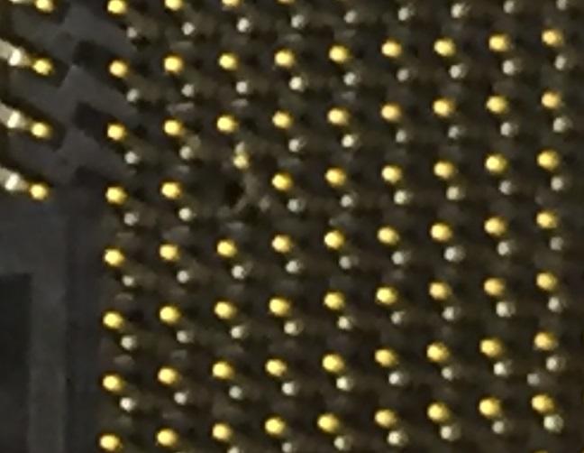

If you look VERY carefully at the pictures of the (confoundedly tightly packed) FCLGA1366 socket one of the pins is bent  :bang:
Now this motherboard was originally never equipped with dual CPU's and the socket had a protective cover over it, but at some stage in manufacture it obviously got damaged.
Glad to say I managed to find a microscopic pair of tweezers and actually straightened it AND IT WORKED  :ddb: :ddb:
I must say I didn't expect that good result  :wave:

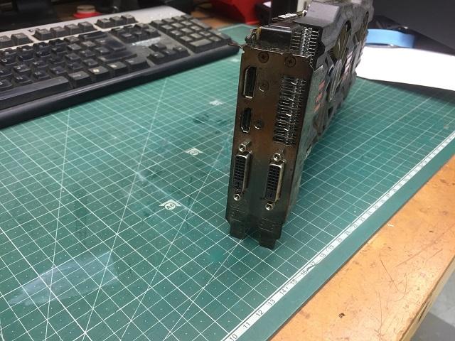

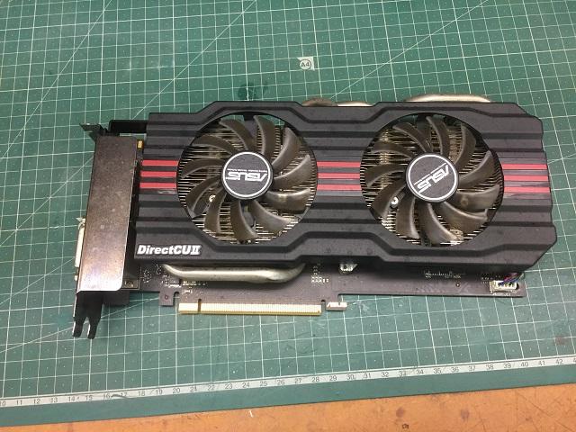

So the pigs are fed, and enjoying their hydroponic pig cooler, so back into the workshop to get this graphics card installed. It's quite a beast, occupies two slot widths and draws an amazing amount of power - 140 watts as I understand, and needs an auxiliary power feed - 2 Gb ram on board.
So get it unboxed.

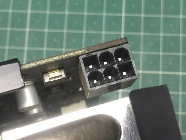

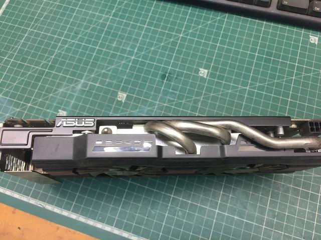

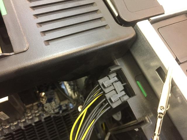

I had been concerned how to supply the auxiliary 6 pin power socket as there were no loose cables in the case to rob, until I realised that those clever chaps at HP had made a moulded in clip to park the unused cables in  :ddb:
  • Posts: 8970
« Reply #20 on: June 14, 2017, 11:36:41 AM »

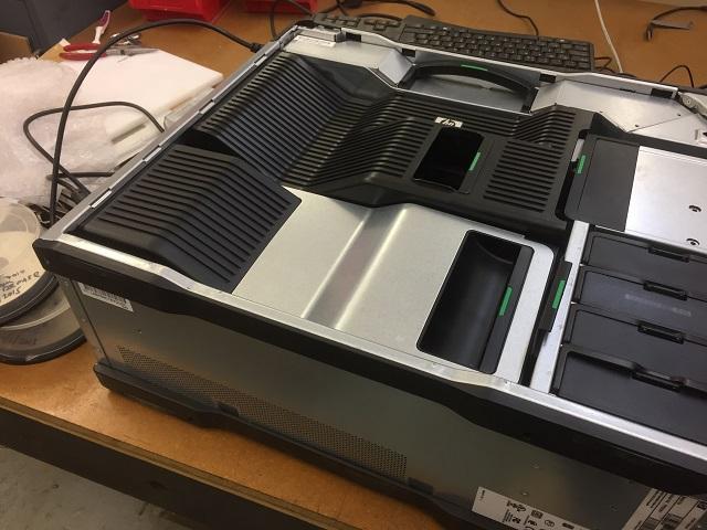

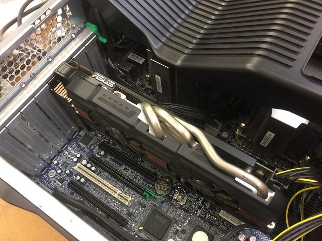

So out with the old and in with the new.
Very simple, the only problem is that the video card fouls the air duct - cards this size were not envisaged for this PC which after all is a workstation not some mad gammers turbo nonsense.
I'll probably have to do a bit of pruning of the plastic to get it to close up properly
  • Posts: 8970
« Reply #21 on: June 14, 2017, 11:53:52 AM »
I'm not in the habit of taking an angle grinder to high tech expensive equipment, but in this case a 1 mm cutting disk did the job admirably removing offending bits of plastic to allow the duct to seat over the bigger card.
The original design of the duct was not only to direct cooling air, but also give support to heavy cards - lucky as it flexs slightly when it meets this monster  :lol:
