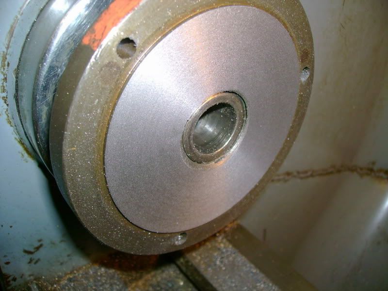

Next I worked out what I needed to take off the shoulder, luckily it was bigger than the register in the new chuck so I didn't have to start from scratch, just had to make it smaller diameter. I converted the amount needed to take off into imperial  :smart: so I could use the handwheels on the lathe.
I initially went 0.10mm oversize then kept trying the chuck taking cuts of 1/2 a thou off:
http://img.photobucket.com/albums/v287/NickG24/Fitting%20New%20Chuck/2009-06-0621-01-42_0014.jpgFitting New Chuck to Lathe
Bingo, a the chuck is a good snug fit on the shoulder as can be seen by the fact it's staying there by itself! I shouldn't have taken that pic, it could have fallen onto the lathe bed ... knowing my luck the camera would have taken the pic at the point of impact!!  :bang:  :scratch: Luckily it didn't fall!
http://img.photobucket.com/albums/v287/NickG24/Fitting%20New%20Chuck/2009-06-0621-03-07_0015.jpgFitting New Chuck to Lathe
Now I had to skim the face on the back plate where the back face of the chuck fits to ensure that was running true, I was careful not to take too much off, otherwise the shoulder could become too deep:

Next I had to mark out the 3 mounting holes in the right places. This is the method I used, put a centre in the headstock taper and set the cutting tool inline with it.
http://img.photobucket.com/albums/v287/NickG24/Fitting%20New%20Chuck/2009-06-0621-11-50_0020.jpgFitting New Chuck to Lathe
The spec said 108mm PCD for the mounting holes so a quick  :smart: revealed that I needed to wind the cutting tool 2.126" back. (I double checked the PCD with a vernier and it was near enough right.) With the spindle running slowly I touched the sharp corner of the cutting tool onto the backplate scribing a line all the way around at 108mm PCD.
http://img.photobucket.com/albums/v287/NickG24/Fitting%20New%20Chuck/2009-06-0621-15-19_0021.jpgFitting New Chuck to Lathe
Here you can see the scribed line:
http://img.photobucket.com/albums/v287/NickG24/Fitting%20New%20Chuck/2009-06-0621-15-54_0022.jpgFitting New Chuck to Lathe
I then thought, how am I going to get the 3 holes equispaced 120 degrees apart?! Well I'd done this before, I don't know why I removed the back plate from the spindle, it needed to stay on there. I used the holes that were already drilled in the back plate to get my 120 degree offsets. I lined one of the existing holes up with a mark on the head stock by eye with the aid of a straight edge (cutting tool). This could have been improved by putting something through the hole I guess ... just thought of that though! Anyway, once lined up I scribed a short line with the cutting tool intersecting the 108 PCD line. This was then repeated with the other 2 holes.

Next, the holes had to be centre punched, centre drilled and opened up to 8mm clearance.
