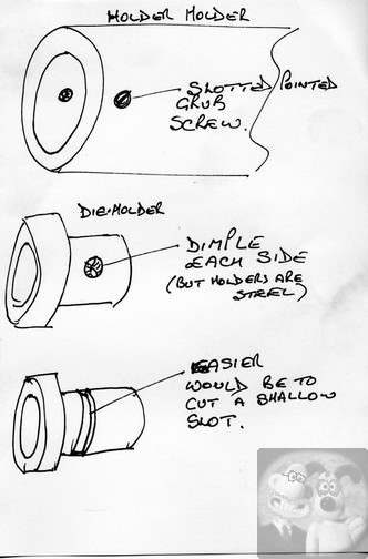

Next I have to dicide how to attach the holder to the holder-holder my Idea is to mill 2 small flats on the 26mm part that 2 grub screws could locate on positive.  That would stop any rotation but olso prevent the parts from locking up as the grubscrew makes a burr on the inner part and preventing them from coming apart again. (exept with violence)

It's looking really good, Gerhard. Might it be an idea to turn a shallow groove 5mm wide on each 26mm part, for the grubscrews to bite into? Then, you wouldn't need to worry about positioning flats under grubscrews before tightening up. That said, I suppose flats would be better at preventing unwanted rotation.
bogstandard
Re: Tailstock tap and die holders.
« Reply #13 on: November 14, 2009, 12:43:49 PM »
Gerhard, I was drawing up and posting about the same time as Andy, so it looks like the same solution.
Because yours are ali, you are going to have to be very careful with your choice of screws. If you can, get dog nosed, they have a perfectly flat end. Or if you use a countersink in the holder holder, which my steel ones uses, then you will need pointed.
Or just drill holes thru both and let the screw penetrate into the hole in the holder holder.

The holder and the holder-holder is made of ali -And is a really snug fit so the dimples /flats / groove would only be to prevent rotation.  That makes me think that a dimple or flat would be better.  The grub screws are steel and have a blunted point on the end??????
