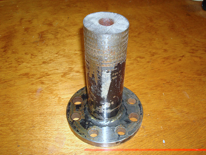

This is the last part of my interchangeable tooling that needs to be done. After this, I will have the complete versatility to swap over between my lathe and RT on the mill.
This won't be a warts and all post like usual, just a quick skim thru showing some items that haven't been seen before.
This has been shown on here before by Arnold, but he tended not to show how a few things were done.
First off, I got a lump of the tough hydraulic ram material. If I knew the problems that this was going to cause later, I would have used another material.
I measured up the hole at the bottom of the ER32 holder, and that size was bored thru this piece.

This was where I hit major problems with the material.
I thought I would finish off the last couple of thou depth of cut with the cheapo taps I had bought. These taps would be great for free cutting mild steel, but not the stuff I was using here.
I managed to finish off the threads with them, but it was very hard work.
http://i202.photobucket.com/albums/aa102/bogstandard_photos/MyfordtoER10.jpgMyford to ER32 collet
This is a piccy of the threads. They look absolutely awful, but in real life they are perfect. I think it is a combination of oil and flash photgraphy that made them look so bad.
