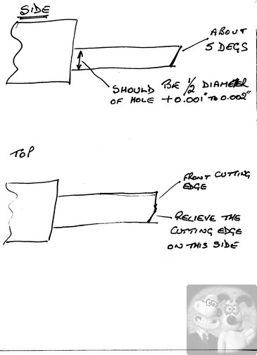

This bit might be a little more interesting, because it shows how to make a most underated tool, the lowly D-bit.
Just to explain a little, a venturi nozzle can be very difficult to design and make, because there are so many variables, and I couldn't even start to be anything but a total novice in the design of one. But there are a couple of basic figures that I know will give me a design that works. These are shown in the C-o-C.
I will be chopping off the front cone part, and it should work well enough to give me a usable spray nozzle.
http://i202.photobucket.com/albums/aa102/bogstandard_photos/Spraymist11.jpgSpraymist
I want to make the back cone, and at this time I will make it adjustable, so I can find the optimum position for the inner nozzle itself.
But how to cut an internal taper as small as I want it? A boring bar is out of the question as it would have to be so fine, it would be almost guaranteed to break. I could get a reamer made to the angle I want, but it would cost lots of pennies. The answer is a D-bit, and if well made, is just as accurate as a commercially made reamer.
I am going to show you how I make one to continue with this job.

The bar was accurately measured up (this was 3/8" or 0.375"). Then it was divided by 2 and the figure rounded up. It was at this stage I changed my normal making practice. I would harden at this stage and grind the end down on my surface grinder. But because most people don't own such a machine, I am going to do it the normal way.
http://i202.photobucket.com/albums/aa102/bogstandard_photos/Spraymist17.jpgSpraymist
Mounted up perfectly level in the milling vice, the bar is reduced down by not quite half it's diameter. One or two thou larger is ideal.
http://i202.photobucket.com/albums/aa102/bogstandard_photos/Spraymist18.jpgSpraymist
Mine measured up when finished at 0.1885", one thou over half size.
http://i202.photobucket.com/albums/aa102/bogstandard_photos/Spraymist19.jpgSpraymist
This is what it looked like close up. The machining marks are only tenths of a thou deep, so no worries over those. I would forget about deburring, as you can easily take too much off the edges and prevent it being sharpened.
http://i202.photobucket.com/albums/aa102/bogstandard_photos/Spraymist20.jpgSpraymist
It was now time to get things warmed up and hardened.
Just the part that was machined was heated up to cherry red, and held there for a minute or two, then it was quickly quenched in water.
This should make the tool as hard as glass. I don't bother tempering the tool, and that is just a personal thing.
http://i202.photobucket.com/albums/aa102/bogstandard_photos/Spraymist21.jpgSpraymist
The machined face is then gently smoothed down on a smooth oiled stone until the machine marks are gone. You should end up with edges as sharp as a razor.
http://i202.photobucket.com/albums/aa102/bogstandard_photos/Spraymist22.jpgSpraymist
You tend to hoard the good and more useful ones that you make. Just in case.
http://i202.photobucket.com/albums/aa102/bogstandard_photos/Spraymist23.jpgSpraymist

You are spot on Chuck, D-bits can get you out of those silly situations you tend to end up in where there is no easy way out of.
If care is taken, they are a fine replacement for a reamer.
The one I have made doesn't have to cut on the nose, so to give you some idea of what it should be like with a cutting nose, say for a blind hole or as a reamer, I have done a C-o-C sketch.

Time to break out the D-bit I made the other day, in the hope that it works (not really, if you make them to the basic dimensions I showed, they are almost guaranteed to get the job done)
I had marked it up so that it would penetrate to about 35mm. The lathe was set to it's slowest speed of 65 RPM.
http://i202.photobucket.com/albums/aa102/bogstandard_photos/Spraymist25.jpgSpraymist
It is then a matter of pecking into the hole and clearing very often. As you can see, it is doing a lovely job of scraping the shape out of the inside. As I have said before, if you can make a good one, they can be used instead of a reamer. But that 1 or 2 thou thicker than centre and razor sharp edges are critical.
http://i202.photobucket.com/albums/aa102/bogstandard_photos/Spraymist26.jpgSpraymist

If I understand it correctly, then the tapered D-bit is cutting only on the left edge, so you needed to offset it a bit on that the right side wouldn't rub.
I think both sides are in contact with the work and that is how D-Bits maintain their accuracy.
Normally D-Bits are used for drilling true/straight holes at specific dia where drill bits have little chance of either.
bogstandard
Re: Spraymist
« Reply #11 on: December 01, 2009, 09:57:48 AM »
Kvom,
Darren is correct in that both sides remain in contact, and that one or two thou above centre helps to keep it locked down onto the bore. Only when you have a front cutting face do you relieve the right hand side on that front cutting face.
Nick,
With a little care, you can easily make yourself a set of D-bits until you can afford reamers. Where they really score is what I have used one for this time, cutting tapered holes, but also they are very good for flat bottomed holes or curved bottom holes, usually difficult to do with a normal reamer.
If you have a toolpost grinder, you can always resize them as well if needed, as the centre height isn't altered if you grind the cutting area.
For short holes, you can easily make four or five D-bits from one cheap piece of silver steel.
If you want I can take a piccy of some of the shapes that I have made over the years, just to show how versatile they really are.

That is the main thing I had seen them for John, flat bottomed holes. but also the instructions for sweet pea call for one as a sort of form tool to give the axle boxes a radius.
