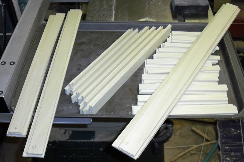

We got some of the pieces for the smaller whistles cut out today. I think you have to reset the saw on just about every cut. Here are the pieces in stacks of four. We'll sand the edges and make one more cut. Then we can start gluing these together\o/
http://img.photobucket.com/albums/v652/Powderkeg3418/Hand%20cranked%20organ/Whistles001.jpgHand Cranked Organ winter project
The wood strips are getting used up fast to. But I think I have enough.

I forgot the picture. Here are all 20 pipes. I think the 5 biggest ones will be mitered after they are glued togather. This will make them fit in the case.
http://img.photobucket.com/albums/v652/Powderkeg3418/Hand%20cranked%20organ/Whistles002.jpgHand Cranked Organ winter project

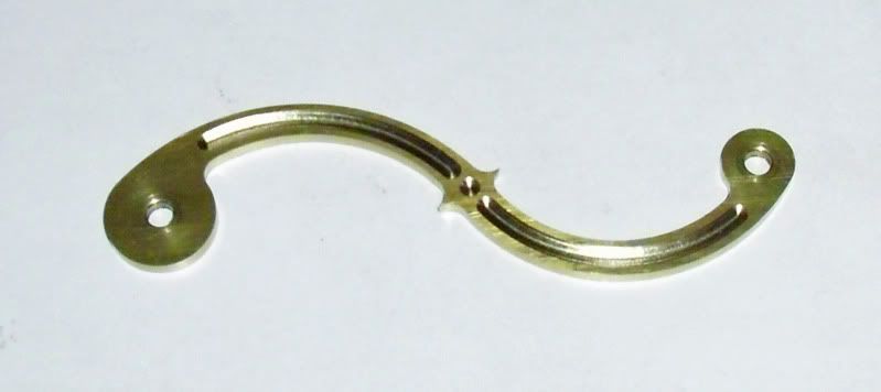

I had a chance to draw up a fancy crank handle. I wanted it to look old. I'll machine this out of Brass and machine a brass hub for the big end and a wood handle for the small end. I'll make it on the CNC after work one day this week.

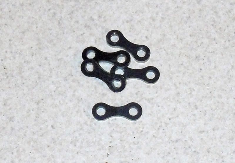

Tonight I stayed after work and made a jig to hold my crank handle. I had a couple of problems with my program. But I got it. Took about 15 min to run all togather.
http://img.photobucket.com/albums/v652/Powderkeg3418/Hand%20cranked%20organ/Handcrank001.jpgHand Cranked Organ winter project
I'm planing on staying tomorrow to. The crank for this is built up and I want to machine some fancy webs for the throws on the crank.
I'll try and get a video.

Thanks for the links PT. They will come in handy. I almost didn't build this. One reason being, I have never read sheet music before. Don't know the first thing about it. I'm still a little nervous as to whether I can make music or just noise :lol:
The crank shaft is made from welded up parts. I decided to make the webs a little fancier than the sketches showed. I drilled the holes in one operation then used some cap screws to hold the pieces to machine the profile. I have about 5 min into each one. Ill machine the shafts to length and champher the ends so I can get a nice weld.
http://img.photobucket.com/albums/v652/Powderkeg3418/Hand%20cranked%20organ/Crankshaft001.jpgHand Cranked Organ winter project
There aren't many more metal parts on this thing. I have the plywood ordered and the Ash sanded down to thickness. I'm going to try and get some of the whistles glued togather this weekend.
