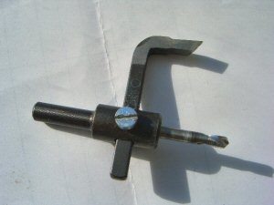

I need to cut 8 rings 3 - 3/4" OD from 1.25mm black plate, the internal is OK I have a 3" hole saw (my biggest).
I should be able to hold the plate in the lathe before I cut the centre out, but I'm unsure of the best way to do this. :bang:

For a lathe, this is a trepanning tool:
And for a drill/mill, this is your ticket:

So it's like a parting tool, only 90 degrees different ?? I hate parting tools, except in brass.

I then attacked it with this little tool, which I seem to use a lot.
http://i160.photobucket.com/albums/t184/oldcranker/MM/100_2922.jpgRings? Sorted!!
That worked well and I soon had a nice circle.I drilled 2 more holes and bolted the lot together.(and forgot to take a photo :bang:) I could then remove the centre bolt and finish the job with my holesaw.
