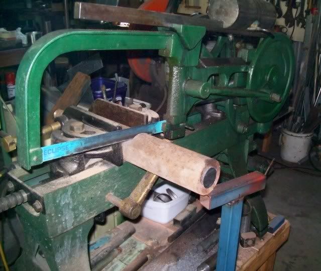

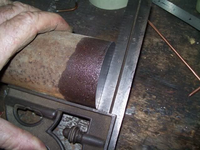

I measured the spindle of the mill at 1.600" so I knew I would be able to adapt the light with no problem. The first step was to remove the bearing cover from around the spindle to get some idea of how to proceed. I found a recess in the cover 55mm in diameter and 5mm deep. This would be my starting point. I looked around my scrap box and found a bit of 2" schedule 160 pipe that would do the job nicely. For our International members schedule 160 2" pipe has an OD of 2.375" and .437" wall thickness leaving an ID of approx. 1.500". This pipe is used in extreme pressure applications in steam plants and in hydraulics.
