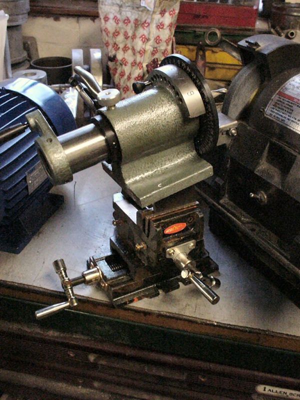

Allow me to present for your amusement and perusal the El Stevo Tool and Cutter grinder MK0.5.
Now please bear in mind that these two pictures are staged shots only outlying the principle and are not to be taken literally .
Basically you take one of those cheap Chinese X Y tables and into the vise you grip a form of tilting plate which is bolted to a 5C spin indexer.
Somehow and not shown is a base that holds the X Y table and a normal bench grinder without tool rests as they are not needed [ I did say it was a staged shot ]
The X movement gives the infeed, the Y movement gives the travel across the wheel, the tilt gives the correct angle and the 5C indexer gives holding and indexing capabilities.
Now this has been posted before on other forums to much mirth and merriment and piss taking but it works.
So far I know of three that have been built in a matter of a couple of evenings for little money given that some of the components may already be in the workshop.
John S.
[EDIT] Due to the state of the economy the two pictures have been reduced to one.

« Reply #7 on: May 31, 2010, 04:23:25 PM »
To/from John Stevenson: "Allow me to present for your amusement and perusal the El Stevo Tool and Cutter grinder MK0.5."
This rang a bell. Now wtf have I seen that thing before  :doh:
One LED goes blinking frantically - ARC Euro Trade!      http://www.arceurotrade.co.uk/Catalogue/Collets/5C-Fixtures
about halfway down the page, we have this, with this title
Stevenson's 5C Indexing Head with ER32 Nut and Adaptor
Might I be correct in assuming you are the instigator of said item appearing in that page?
I like the indexing head, especially because I already have a fair number of 5C collets. I like rather less the bench grinder, a dedicated grinding spindle, and a diamond disc, would be closer to ideal. And I like least the chinese X-Y table vise. I don´t know what TPI (mm) the screws are, but they don´t seem exactly micrometer quality.
Anyway, I´m going to trot along this path for a while, I ordered the Indexing head, should be here next week (unless there´s another volcanic eruption in Iceland again), and meanwhile I´ll do some ebaying about the grinding spindle/motor and a bit more sensitive X-Y table.
But I´m still open to any brilliant suggestions about getting my end mills sharpened  :scratch:
