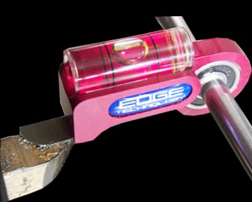

Offline Jonny
  • Posts: 780
Re: Improving a chinese bandsaw
« Reply #13 on: January 23, 2011, 03:59:47 PM »
Anyone know where you can get the replacement guides?
Havent used mine for 11 years chews the blade up within seconds.
If its just a case of replace the off the shelf bearings and adjustment i would do it that way in a few weeks. Any tips for alignment.

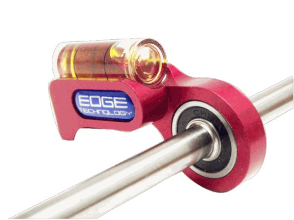

Offline maybecnc
  • Posts: 21
« Reply #14 on: January 23, 2011, 04:29:24 PM »
See if this can be any good for your saw. It makes blade alignment very easy:
http://www.toolsandmods.com/blade-guides.html
Be sure that bearings are not contacting with blade teeth.
To align the blades I use to cut two 7cm wide plywood parts at a time, placed vertically on vise and separated by 10cm (with some stock between to separate). The cut on each plywood shows any missalignment on the blade guide closest to it.
Jose
