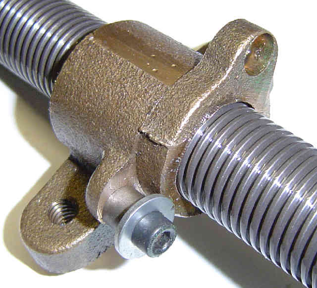

Actually, if you sort the nuts out and clamp the head tight, the machine is just about rigid enough to cope with light cuts.
As a quick fix, I cut the nuts across the split, faced the cut ends and reassembled thus...
