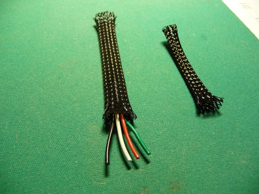

But before doing anything, I had to prepare the stepper motor and power supply because as you build up the boards, you are required to check for voltages and correct operation. I bought my stepper from Arc Euro, about the cheapest place I have found. In fact I bought almost every extra that I needed from the same place.
http://www.arceurotrade.co.uk/Catalogue/Stepper-Motors
The little plastic box had a D shaped cutout put into it, to fit around the rubber grommet on the stepper. The back of the box was covered with strips of VERY hi-grip double sided tape (used to fit outside trim onto cars), and the box was 'stuck' onto the side of the motor.
http://i202.photobucket.com/albums/aa102/bogstandard_photos/From%20June2010/DM07.jpgBuilding the Division Master and modding my RT
After trimming all cables to length and getting everything tidied up and into the box, and a small wipe over with petroleum jelly onto the box joints (in an attempt to make it splash proof) the lid was fitted and the kit supplied plug was fitted to the other end of the cable. The stepper was now ready for use.
http://i202.photobucket.com/albums/aa102/bogstandard_photos/From%20June2010/DM08.jpgBuilding the Division Master and modding my RT
The power supply was off an auction site for 8 squid, brand new. It needed a new extended output cable and relevent plug fitted.
http://i202.photobucket.com/albums/aa102/bogstandard_photos/From%20June2010/DM09.jpgBuilding the Division Master and modding my RT

just what you need if you don't have the equipment to program the ic or  make the pcb for a diy indexer
(another plus not having to buy the bits from  several suppliers - usually I have to use 2 or 3 for most of my projects )
the green solder resist  on the professional looking  pcb's will help you to avoid short circuits , if some tracks pass between the ic pins !
something you miss on diy boards
I like the way you have extended the motor leads with the 4 core mains cable
I'll have to copy that when I eventually make one  (it may be some time before I have a milling machine )
is the dc power connector a locking type ?   (   like  rapidonline's 20-0892  )

Like I said at the start, there are other ways to achieve the same results, but it is up to the individual as to what course to take.
Both Kwackers and John S answered all my queries, and with that info, I decided to go the kit route, mainly because it would be easier for me, and because I didn't have room for the extras required in my shop, namely a laptop.
Arc Euro were out of the normal cable when I was getting the other bits together, so a trip to B&Q came up with some 0.75mm 4 core central heating cable, and I just made a note of where the new colours went to, but is in fact, a little more expensive than Arc's offering (which was back in stock the last time I looked). I actually have a 2 metre long cable on the stepper, as the DM box will be mounted onto the side of my mill's head, not trailed about as normal. The power cable plug isn't a locking one, I just rooted in my shop for one that fitted the socket supplied. It shouldn't be a problem for me as the box should remain almost stationary, and won't be able to be pulled out easily, especially as the power supply will be permanently fixed to the wall behind the mill.

I did my cables this way,I wanted long cables so a clever frend worked out the min cable size and I got some with a bit to spare in case i drew a bit to much current and used cable mesh avalable from http://www.heatshrink-online.co.uk/heatshrink/cat_147046--019-Black-Expandable-Braided-Sleeving.html    good service also handy for things like heat shrink with Glue and ribbed heatshrink.
