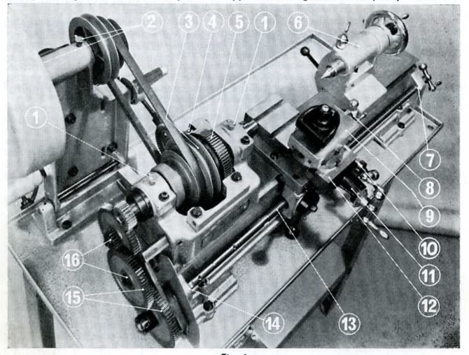

Interesting one for all other lathes too, however you think the casting is rigid there will be a degree of flex more so with the asian builds and a certain German small machine builder, unreal. Beds can sag or even twist certainly looking at sketch below if 36" crs.
Harrison made a big song and dance over these issues on substantially beefier machines, painstakingly setup on stand at factory and shouldnt be disturbed.
Myford ML7 sit on alloy blocks on top of the tray then welded sheet stand, one bolt either side 4 in all.
Pretty much a must to bolt down tight on to something rigid between feet, metals are hard to stretch and would act as a form of brace.
If that dont cure could botch a jack up between the two feet :loco:
For reference and lifted from lathes.co.uk
