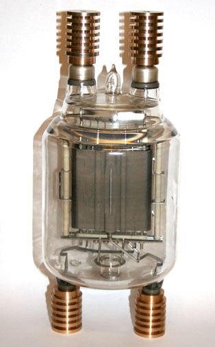

As promised here is a picture of the valve that I'm designing a base for. In the picture you can see some bases and top caps that I made over a year ago.
I decided that for the final build of my amplifier I need something with a more "engineered" look as well as function.
More pic's coming soon, this is just a teaser.......  ;D

Well to go into it deeply would be a whole new subject, simply I build valve amps for stereo hifi reproduction. Been doing it a while and this valve is one of the "Big Boys"
It's an 833 triode, operating voltage in this picture is 1,100 Volts DC, DC is far more dangerous than AC btw. It produces a glorious sound that has to be heard to appreciate fully.
Ok, so what have I been doing in respect to this, and what does it have to do with forum. Well as I said earlier I've been making some new bases for the valve. It needs something to make it stand up and somewhere to connect the cables to.
I found this forum after I'd started so the pics are a little jumbled. I'll put some info up bit by bit as I sort some photo's and all will be revealed slowly.
Everything in this mini-project is machined from a 20mm 303 stainless bar.

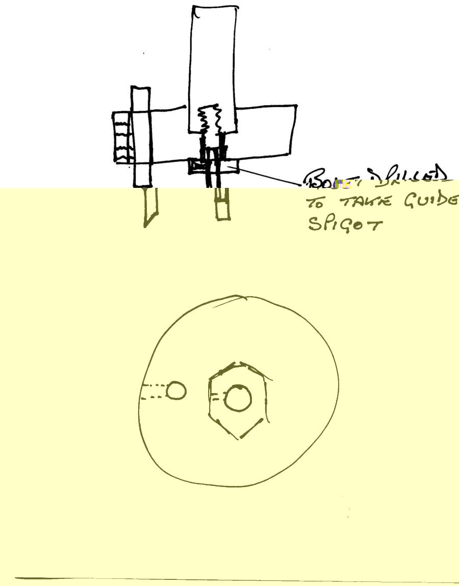

Hi Darren
Another way to open the hole out would be to mount it on a face plate up against a sacrifical plate and just bore it out, the technique has been shown elsware on MODMODDER I think it was Bernd who posted it, but I stand to be corrected on this.
Have Fun
