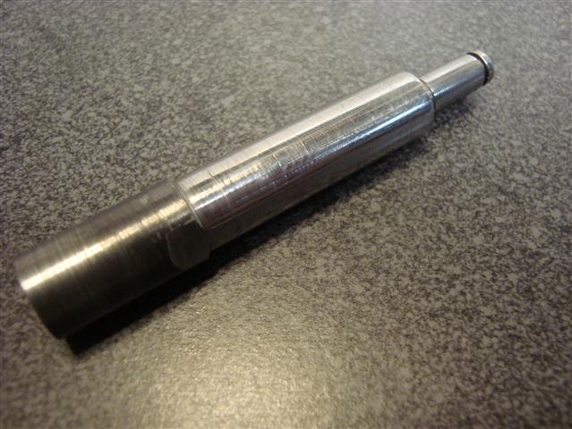

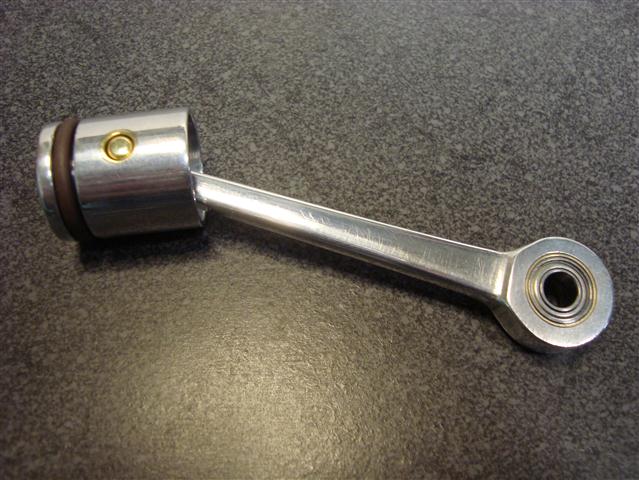

2 months ago I could hardly spell "lathe" but I wanted a new hobby, so I found a lightly used, but broken 7x12 on craigslist for $200 with some tooling, bought a replacement board from LMS, and started making swarf.  The internet is a great place to find ideas and how to's so I started searching.  I came across Joe Websters free 4 stroke plans: http://home.comcast.net/~webster_engines/... and I was off.
I first made a bolt... and was pretty proud of it, then a little wobbler, it worked well, but I wanted something that made fumes....  so I started on the Webster.  Luckily there is a Metal Supermarket 4 miles from my house so I purchased the raw stock needed for the Webster and started turning.
The cylinder and piston were first, then the head.  It was fun over Christmas to show my friends and family what I had created.  Everyday I made another piece and I got a little closer to "first pop". It happened on January 9th, after 8 build days in the shop.
All the parts shown with the exception of the bearings, plug, bolts, ignition coil, and finned flywheel were made from scratch, some based on the basic plans.  I did not want to go the points and condenser route because of the luggage you have to haul around in order to run the motor.  I had found a dead weedeater on the side of the road 2 years ago and I tossed it in the "to be used someday" pile.  I works VERY well and I plan to use this type of ignition in the future because it is so reliable and cheap.
The vapor carb is based on Jan Ridders idea, but completely designed and built by myself.  I used a carb off my old RC10 GT nitro car and it worked ok, but was a pain to adjust and not reliable, so I use the vapor card exclusively now.  I can adjust the mixture with a turn of a long nut that covers and uncovers a hole on the intake tube.
I am currently running straight Coleman fuel with a few drops of marvel mystery oil, but have used nitro methane, denatured alcohol, 87 oct gas, butane, propane, rubbing alcohol, and mapp gas (stinks...).  the coleman fuel can be run in the house for short times and it has a pleasant odor like I am camping...
The ignition timing can be adjusted by moving the coil up and down thus changing the spark from 20 degrees BTDC to 20 degrees ATDC.  A neat effect of this is that you can adjust the idle from 1000 RPM to 4000 RPM just by changing the timing.
It will start with a swift turn of the flywheel, but this gets old quick so I installed a one way bearing and nut from an old RC rope starter and I can use my drill with a 12mm socket to start it.  It just takes 1 or 2 revolutions to fire and then revs to full RPM.
I might add a rope starter pulley and a PTO pulley some day, but for now I am done with modifications and am starting on Jan Ridders OTTO engine.

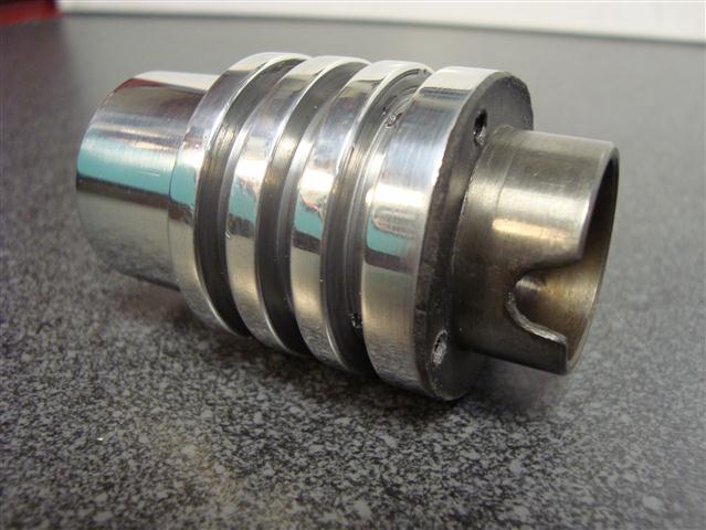

This is a pictorial of the finished parts....
« Last Edit: February 14, 2011, 01:09:24 PM by dbvandy »
"if you can pay someone to do it, then you can do it... just might cost more and take longer."  ~Grandpa Vanderbilt
Offline dbvandy
  • Posts: 170
Re: My webster build
« Reply #1 on: February 14, 2011, 11:43:45 AM »

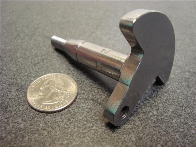

here are some pics of the completed parts.
Offline dbvandy
  • Posts: 170
« Reply #2 on: February 14, 2011, 12:08:27 PM »

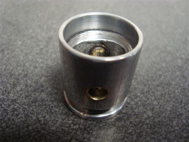

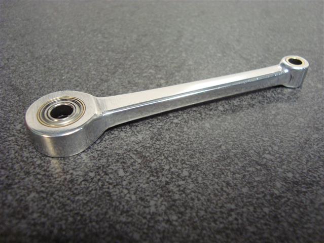

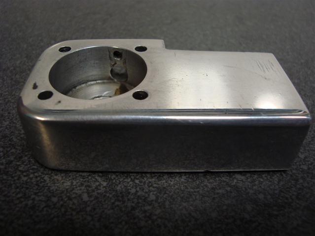

More Webster parts....
Offline dbvandy
  • Posts: 170
« Reply #3 on: February 14, 2011, 12:15:12 PM »

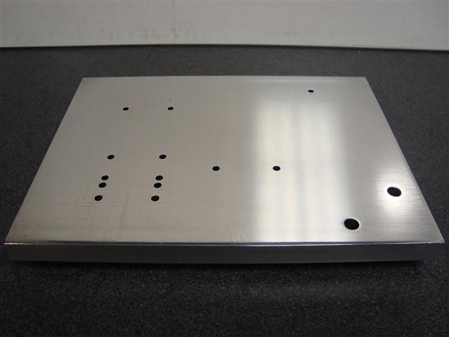

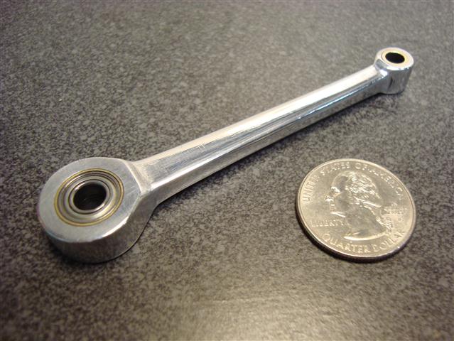

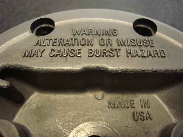

Some more Webster pics mid-build.  I did not take a ton of pics while I was making chips, just concentrating on dimensions, I guess...

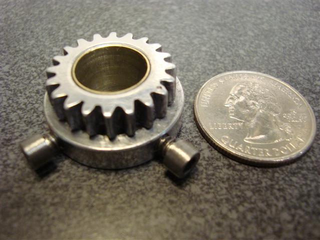

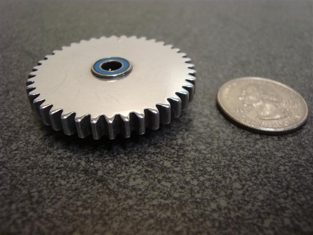

Here is what I did to cut the gears.  The actual blank for the 40 tooth on the motor was thicker and had a small hub for mounting the cam, but you will get the idea (I had some 3/16 inch plate laying around...)
I turned the blank to the correct OD for the 40 tooth gear that I was copying from the change gears on my 7x12.  If you don't have a gear to copy, you can easily cut a circle into 40 even slices buy using excel and putting in 40 1's then pie graphing it.  presto...  40 even divisions, you can see the printed pie graph in the pic with all the parts.  I did not need to do this for this build, but have used this in the past for other times I needed to divide a circle.  Then you double tape it to the blank, centering needs to be very close, but perfection is not critical.  You could tape it up before you cut the ID in the blank and it would be perfect...
I turned an arbor to match the ID of my sample gear and drilled the same ID into the gear blank.  (Later, after the gear was cut, I chucked it back up on the finished OD and turned the ID to match my bearings and the cam hub OD to match the ID of the cam.)
Then all you have to do is start cutting teeth with the cutoff wheel.  I chucked mine up in my lathe (and put some shop towels down to protect the ways) just because it was easier to hold the Dremel steady when I rested my arms on the table the lathe sits on.  The 20 tooth was done first (and then a large piece was pressed over its hub part so I had a place to put in the set screws).  You can see where I got a little deep by the cuts in the washer on my arbor.  That was during the "learning phase" when I was trying to do it with a file. (bad idea, no control and takes FOR-EV-ER!!!)  45 minutes and 6 teeth later is when I decided to use the Dremel.  Great decision....  it only took about 15 minutes after that to finish the 20 tooth.  Then I made the 40 tooth with the same process.  I did then go back with a small hand file to even out the teeth and make them pretty.
I had a sample gear so I could duplicate the depth and profile radius of curvature, but for this motor it is not SUPER critical as it is low speed and next to zero pressure on the tooth face.  Just look at any other gear and try to match the basic shape.  You could also look online and there are programs that tell you how deep the tooth should be and you could put that dimension and the OD dimension on the pie graph with a compass before you mount it to the blank.
My gears:
20 tooth:  .864 OD   .682 depth of tooth
40 tooth:  1.653 OD  1.508 depth of tooth
This might not be the way a "real" machinist would do it, but without making a ton of tooling and lacking a true milling machine and a rotary table, this worked just fine for me.  Total time for the three teeth shown was about a minute of cutting.
Hope this helps...  feel free to ask questions if needed... I am pretty easy...

Wow - I bet not many people have though of this and nobody can argue that it has given good results. Well done and thanks for showing.
