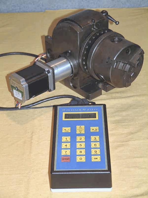

Re: Another manual RT to stepper control
« Reply #11 on: April 05, 2011, 05:09:19 PM »
Fits well to a BS0, uses virtually the same gear as the Vertex tables.
John S.
« Reply #14 on: April 06, 2011, 03:48:53 AM »
No, all I did to mine was to cut the thread off where the nut goes on, [ I can tap it and fit a stud if i want to make it manual again ] bore an Oldham coupling out to fit over the flatted shaft, 12mm Ø if i remember correct and make a top hatted closed end sleeve up with 3 holes that pick up the division plate holes.
This sleeve is bored 1 1/2" at the outer end to accept the stepper register but then it has to open out internally to allow the 3 cap screws to sit in the 3 holes.
That was it.
John S.
