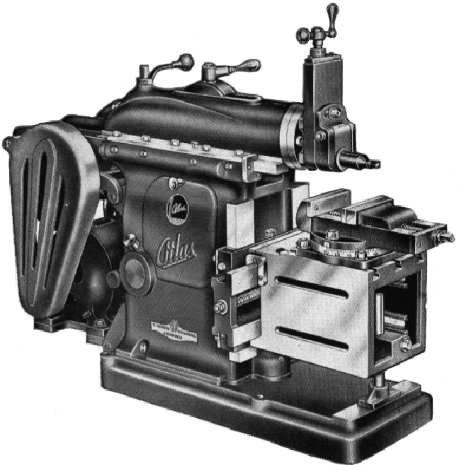

It turned out to be an Atlas/Acorn shaper, later model 7" with a 9.3" bed travel.
On a proper stand too, though the bottom section is filled with concrete. We split the machine off the stand, just four bolts and it's now in the back of my car waiting for help to get it out.
The stand was the heaviest bit !!
Will take a pic later but for now this is it

« Reply #13 on: December 13, 2008, 08:37:04 AM »
 I had one of those 7 inch atlas shapers in real good condition. Never used it once in the several years I had it finally sold it to a kid that had the big interest in Atlas machinery..Now I would appreciate having one for use cutting the mortise for falling block rifles......but I built a contraption that fits on my vertical mill for arm powered shaping of the odd internal shape and so dont need to make space for a full sized shaper.....

« Reply #15 on: December 13, 2008, 10:50:10 AM »
I'm jealous Darren.  :(
Nice machine. I don't think you'll regret getting it. :thumbup:
