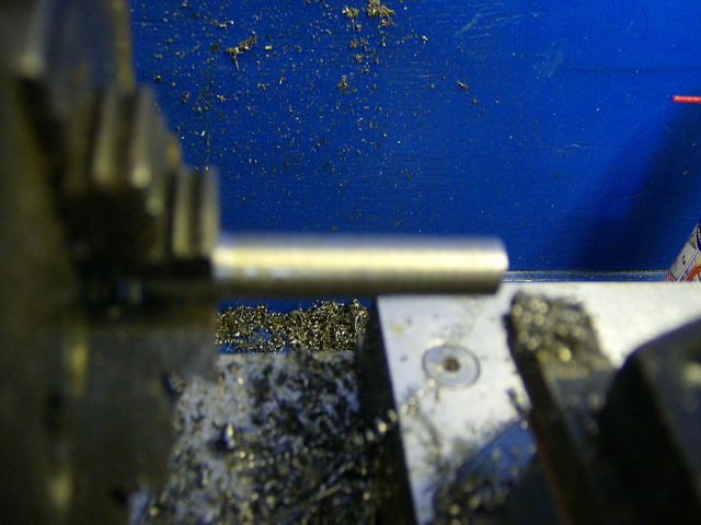

I have a one on the quill of my mill
The x y axis has a Newall dro which has given me no end of problems
Trouble is once you have used one they become very adictive :bugeye:
http://i261.photobucket.com/albums/ii63/john970s0/DSCF2625.jpgminimill dro revisited.
