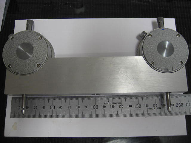

Hope you don't mind me asking, how do you measure the outside end of the internal taper? I find it hard to measure accurately.
Thanks.
Wong
  • Posts: 2492
Re: General purpose ER 11 collet chuck
« Reply #14 on: October 31, 2011, 07:48:07 PM »
I'm glad you asked that Wong, I have the same question...
Nice work as always Arnold, I  may have to make one of those (only ER25) for my lathe...
Offline arnoldb
  • Posts: 515
  • Windhoek, Namibia
« Reply #15 on: November 01, 2011, 05:16:34 AM »
Hi Wong & Ade
I just measured the end with calipers.  The 11mm outside end does not need to be super precise; it can easily be up to 0.5mm under or over.  Slightly undersize is better; then you can skim the taper bore later if it becomes damaged.
If you want to measure it a bit more accurately without resorting to all kinds of fancy measurements you can do the following:
Before you start turning the collet chuck, take a bit of scrap round bar that is larger than 11mm and turn it down to 11mm for a section of about 20mm. Then turn an 8 degree external taper on it for about 12 to 15mm.
You now have a gauge you can use to check the taper in the chuck as you turn it.  When the section on the gauge where the taper ends fits flush with the front of the chuck you're turning, you're on size.
Once again, this is not super accurate, but will be close enough in this application.  Ade, for an ER25, the sizes must be increased appropriately.
If you turn the gauge carefully and the taper on it accurately (it's easier to turn an accurate outside taper than an inside one), you can also use it to check that you have an accurate taper on the inside of the chuck while boring; a bit of engineer's blue smeared on it can show you if your internal taper is off a bit and you can compensate before reaching final size.
Hope this helps  :thumbup:
