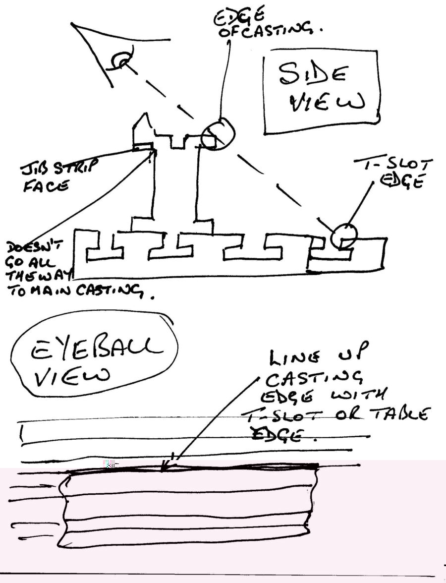

Right, I said I might be back with a bit more, but a lot of you will find it totally boring. I spent two hours checking the casting over, just to see what exactly the problem was. Also you must excuse the pics, I can't quite hold steady enough nowadays, but I managed to get enough that weren't too out of focus or shaky to make up a bit of a post.
I popped the casting onto the mill table, and immediately noticed that the whole casting had a twist in it. It was 'rocking' on the machined bases, I measured it and there was roughly a 0.010" (0.25mm) gap under one edge. So I got a 3-2-1 block, put it onto the top faces and checked for rock on there. Sure enough, the block rocked (just like madmodders). The decision now had to be taken whether to carry on or give up and call it a day. So to give it another chance of life, I decided to clamp it down and see what happened.
http://i202.photobucket.com/albums/aa102/bogstandard_photos/Darren6.jpgFixing Darren's lathe
Once clamped down, all rock disappeared on the top faces. So I have decided to give it a reprieve and machine it up, if everything else checks out. This will mean Darren will have to bolt the lathe to a flat section of either 4" thick walled square tube or a length of u-shaped girder. Just to keep the twist under control. Unless of course he can come up with a nice piece of thick Welsh slate to bolt it to.
I suspect that during it's life it has been resting on an uneven surface, and because there is no strength in the drip tray it was bolted to, and only supported on four rubber feet, it has taken on a permanent twist.
http://i202.photobucket.com/albums/aa102/bogstandard_photos/Darren7.jpgFixing Darren's lathe

So now comes a major decision, machine it on the spot and hope that the casting hasn't been hardened underneath where the jibs run, or mount it onto angle plates and machine it with a known cutter that I know will hack the material off.
I can use the side and face cutter, hoping the material isn't too hard and do it in situ, or use the solid carbide which is guaranteed to work, but will require two more precision setups using angle plates.
http://i202.photobucket.com/albums/aa102/bogstandard_photos/Darren15.jpgFixing Darren's lathe

After giving it a long thinking through, I decided that I would give the side/face cutter a go at it, then if that didn't work, I would take the difficult route.
First the problem.
I don't have enough movement on the x axis to do the job in one hit, so two shots will need to be done. But because I am working off the feet bottoms as a datum, if I do a good cleanup between operations and make sure everything is clean, I should be able to keep within my self imposed tolerance of 0.001".
I have decided to go with a slightly smaller cutter to help keep everything a little more rigid.
I also decided, because the rear side had up to 0.011" variation, to actually put cut on of 0.015" (0.4mm) and hope the area can be cleaned up in one quick swipe.
Once the cut was set for height, both z axis' were locked up rigid, and the DRO set to zero. From now until the end of the job, all areas will be cut at this setting.
This pic shows the start of the exercise, and to my great delight, the underside wasn't hard skinned, and gave a nice steady, smooth cut.

Bernd,
I did not need to have it any more accurate than a few thou, due to the fact the jib strip face doesn't go all the way back to the main casting body. I just needed a machined area for the narrower jib strip to run on.
When I moved the casting from one end of the table to the other, the cutter was moved out of the way in the Y axis. The casting was then put to the other end of the table, lightly clamped down, and then tapped by hand, so that when eyeballed along one of the machined side edges of the casting, the edge was aligned with one of the edges of the t-nut slots. By aligning by eye over a long length like this, you can usually get to within a few thou of being parallel to the table. But it doesn't work if you are cross eyed. It is better if you can do it with just one eye, I normally take out my glass one, but you could just close one of yours. :borg:
The clamps were then tightened up and the cutter moved back into position for carrying on with the cut.
C-O-C attached to describe by piccy. Once you do it you will wonder what all the fuss was about.
