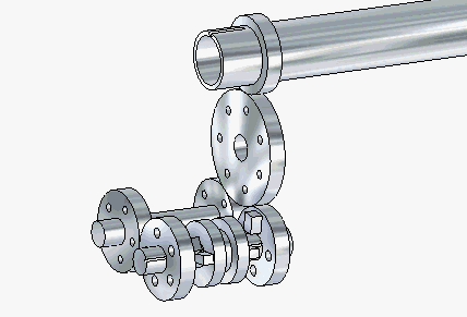

here's where you can get the plans to build yourself my idea for reverse tumbler gears for your lathe. I hope this will help you guys with a lathe that doesn't come with the reverse tumbler gears.
http://www.projectsinmetal.com/normans-reverse-tumbler-plans-for-a-grizzly-g0602-10x22-lathe/

Norman,  have you considered making a  hardinge type dog-clutch  for these lathes?

No Bill I haven't. Do you have one on your machine? If so post it, I'm sure everyone would like to see it I know I would.
 I do not know much about them, I know you asked me that on a different forum. I still don't know if I could or would want one on my lathe. I do find it interesting.
I'd be more inclined to try making a power cross feed but then I'm not sure I could make it. I've seen lathes that are close in size to the g0602 and I think they do have the powered cross feed.
Yes, but  it is a Hardinge HLV-H so it always had it :)
The advantage it gives (especially with a retractable tool-post ) is the ability to thread without detaching the half-nuts (so metric and imperial threads can be cut without a threading dial) . If a threading stop to disconnect the dog clutch can be incorporated in to the design then threading to a shoulder becomes child's-play.
I think if I were adding a power cross-feed then I'd look to adding it to the rear of the lead-screw using a small servo-motor  without (or with not too much) reduction gearing, so that it would not need mechanically disconnecting for manual use.
