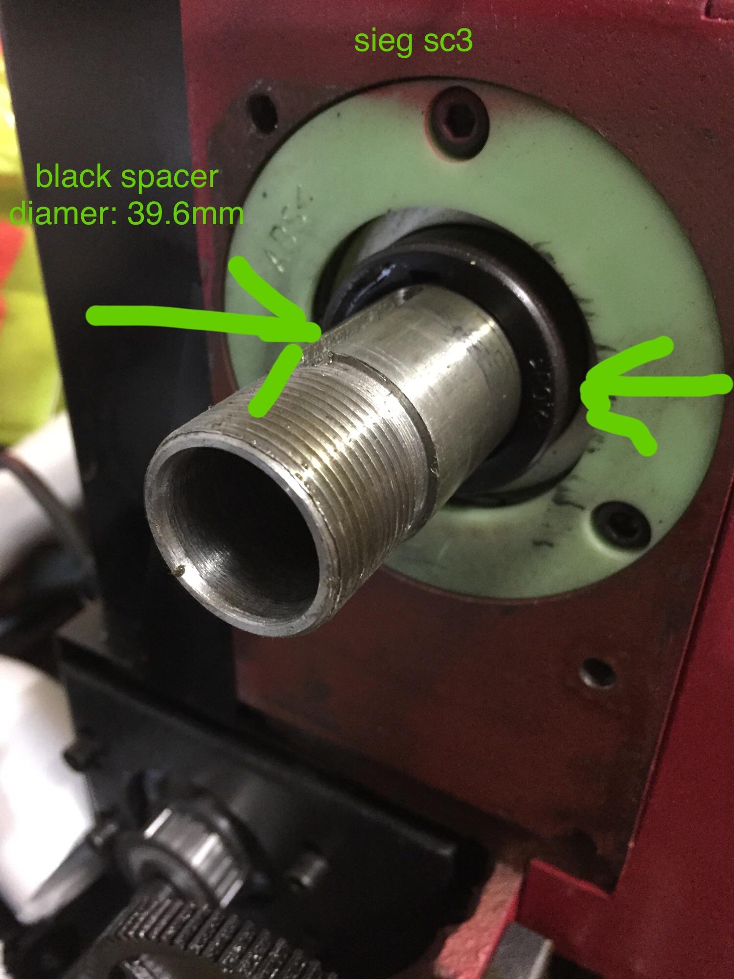

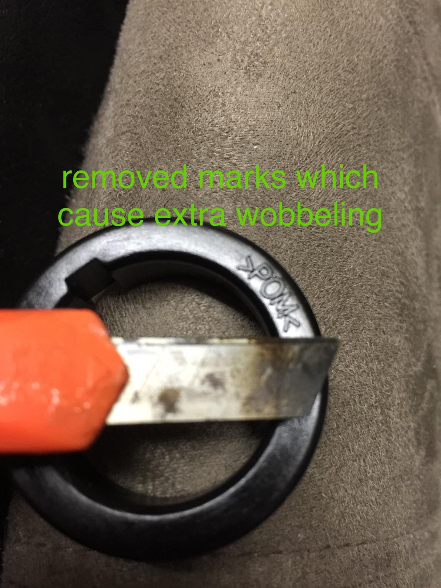

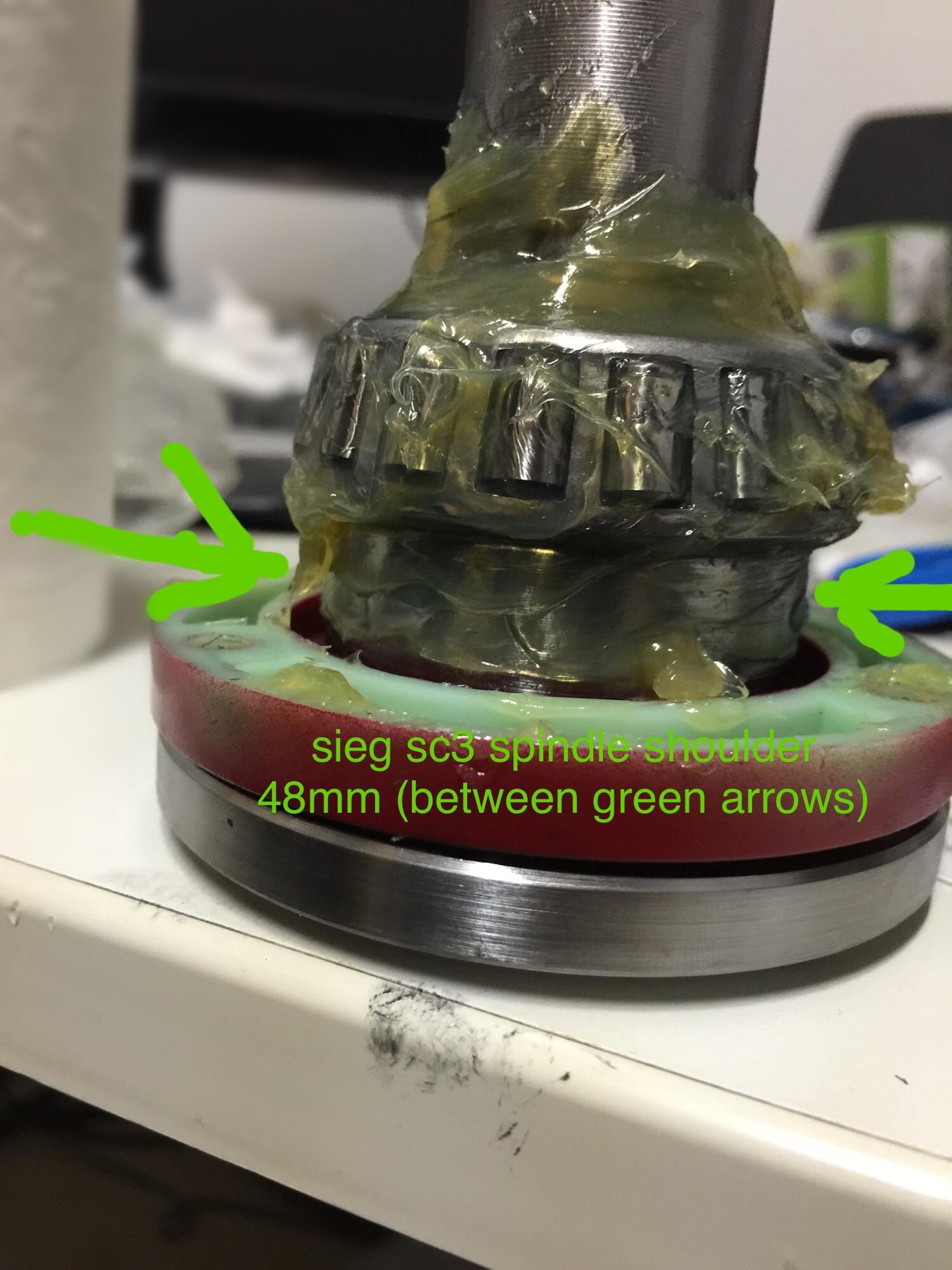

Hi John,
bit late to respond to this thread, but just got my Super C3.
preparing to upgrade to tapered barings myself, and having no second lathe this topic got my interest.
I've machined a nylon spacer as a first run on the lathe, which is now 27mm in diameter on the inside, and 40mm in diameter on the outside (which i could measure without disassemble the lathe) . Depth .. i hope long/deep enough, as i don't know the depth yet.
Does anyone know the exact dimensions of the old spacer? and key-depth/with? in order to prepare the spacer as a preparation on front?
But the real reason i respond to this thread, is that i think a metal spacer isn't the best idea to my opinion. I think it is better to have some more elastic spacer, which is able absorb temperature triggered variations, and acts like a spring for manual adjustments as well. Even more when it gets too hot it may act like a fuse.
So i really think some "soft" plastic is better then all metal spacers in this case. I can't particular recommend nylon for this, as the nylon was some kind of a task to machine, and to hold in the chuck.
What do you think of this thought?

Arjan,
I'll post up the dimensions of the orig spacer......
Not sure I agree with the plastic spacer you suggest and the reasoning....properly adjusted the bearings should be fine....if the temperature rises as you suggest, this would affect the bearing preload using a plastic/non-metallic spacer more than the alloy ones I used.....(plastic softening?)
I'm no metallurgists, so let's discuss.....always willing to learn and exchange views

« Reply #15 on: December 11, 2013, 03:32:30 PM »
Hi John,
if you want to share the original spacer dimensions, yes please :)
In the meantime I'm waiting on my 4" (100mm) spindle, to have all components ready for an upgrade (bearings + spindle).
Bearings are already waiting.
About the plastic or some softer/elastic material or hard metal spacers, I'm not a metallurgist as well, and don't kno what  the barings itself can absorb or give back when needed, it seems logical to me, but the temperature size variations might be compensated by the tapered bearing, which has hollow cones and i read. Maybe you need absolute stiffness for a lathe, and therefore no soft plastic.
Thank in advance for the dimensions.
Arjan
  • Posts: 2554
Re: Sieg Super C3 bearing change
« Reply #16 on: December 26, 2013, 10:03:13 AM »
Ohhhhhh.......
Finally got round to it....
The thickness of the spacer is 11.08mm.....That is the original spacer thickness....
Apologies for the belated reply....
John and others. Ut took some while for me to get the right materials (bearing puller stuff), and now with my spindle detached, thinking on the subject shielding the tapered bearing.
The dust cap will keep the worst out probably, but like a seal more.
It seems the dust cover is build to hold a seal. I ordered 48x3 , 48x3,5 and 48x4 (mm) nbr o-rings to see if i can get it sealed and fit. If that works i consider to create a new spacer with a diamer of 48 too, to be able to use the same construction. That spacer needs to be shortened or re-created anyway.
What do you think?
Regards,
Arjan

With regard to the bearings: For almost all applications that use two bearings (ball or taper) the rule is that one inner or one outer must have axial float. In the case of ball-races this is to prevent axial loading which the bearings are not intended to withstand. For taper bearings it is to permit the pre-load to be set (as has been rightly stated in this topic already). There are some odd exceptions to this rule for certain applications. When the Triumph Bonneville was made by the Meriden Cooperative, they redesigned the rear-wheel to take a disc brake. The wheel hub was re-designed with two ball races and no float anywhere. As a consequence the life of the rear-wheel bearings was less than 3000 miles. It was a pig's ear design with no easy remedy.
I have seen a mini lathe webpage dealing with a bearing change that suggests a 38mm x 4mm O-ring for an additional seal on the spindle. I have the bearings and O-rings ready to go and have acquired the purpose designed LMS extractor kit. The job will, however, have to wait until I've re-vamped the garage.
About the seal, i read that 38x4 seal page as well, i guessed there was made a typo or a different lathe. See my photo's without seals. I ordered some 48 nbr seals to try out, and will make a bigger spacer (black on photo) with diameter 48 too if seems work ok.
A general good thing to do is to remove the remarks on the spacer rings, to prevent uneven pressure on bearings (see photo).
Regards,
Arjan

« Reply #22 on: January 18, 2015, 11:30:36 AM »
 :bugeye: And I thought I was ready to go!  :bang:
I now have 48mm x 4mm seals on order from ebay (where else?)
