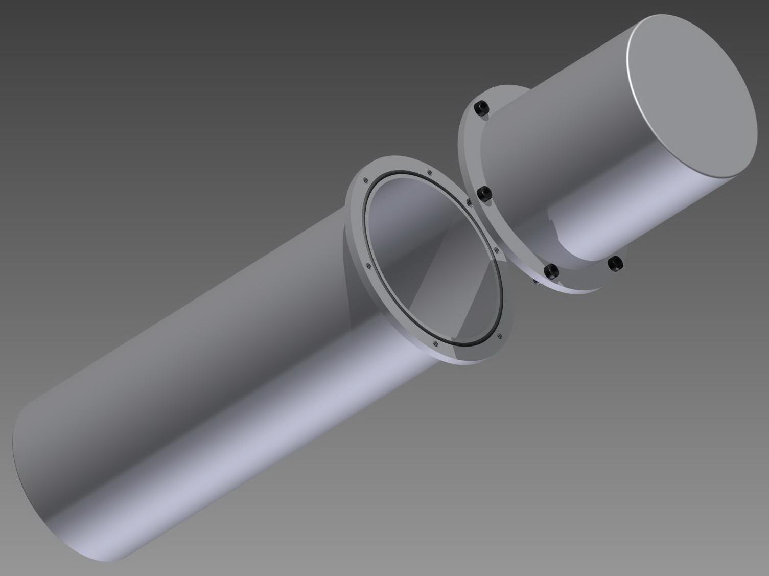

Regarding the 5" tube, I'd like to make the top 1/3rd removable from the bottom 2/3rds ..... so any ideas on how to do that would be welcomed ... it needs to be oil tight but the oil level will be below the joint ...

Darren,
That's an interesting proportion, any reason you want such a narrow tank - is fitting it in a problem?
The reason I ask - 120 quid will buy you a ready-made aluminium alloy one with fittings fitted, and the separator plate already in place, no need to cut-n-shut, or worry about leaky flanges or other medical issues...
If you're absolutely set on DIY'ing a S/S one, you'd be welcome to swing by my place to use the TIG welder, I've got a bunch of stainless rods, again that'll save you the hassle of fabricating fittings, finding o-rings, etc.
If you do go down the fittings route, Ausdier's design would be my first choice - I guess the only difficulty comes back to welding stainless...

Fair comments  :D
The way I see Ausdier's plan working - cut your tank as planned (I presume this is to insert a splash tray/separator tray/anti-surge plate/whatever the hell it's called just above the oil level?), weld flanges around the outside, cut an o-ring groove, drill (& optionally tap the bottom portion if its thick enough), then the two parts just bolt together.
Your "internal lip" idea would also work, you could either cut or swage a groove into the inner lip to hold an O-ring (cut, probably, if you're using 1.5mm thick pipe), you would need some method of holding the top onto the tank in that case, simplest I can think of would be a strap that runs from the bottom piece, over the lid (& through a locating loop, like a belt loop on your trousers), down to some kind of clasp arrangement on the bottom portion. Or weld a pair of ears onto both lid & tank, and bolt through them, like a partial flange.
I might be able to do crap-o-cads if it would help?

That would be great, bit worried about welding such a thing on thin (1.5mm) SS as it warps easily ....

A few (actually quite a few) years ago I worked on a can-am car that had a similar sounding tank (although probably about 10" in diameter).
The top and bottom were joined by 1/4" flanges on each piece, sealed by a large O ring, and held together by a dozen or so capscrews.
One thing you might want to consider is locating the return line into the side of the tank on a tangent and slightly pointing down, to swirl the returning oil around the sides of the tank.  This reduces any splash and helps a bunch with removing the air from the scavenge side of the system.
Hope this makes sense!
