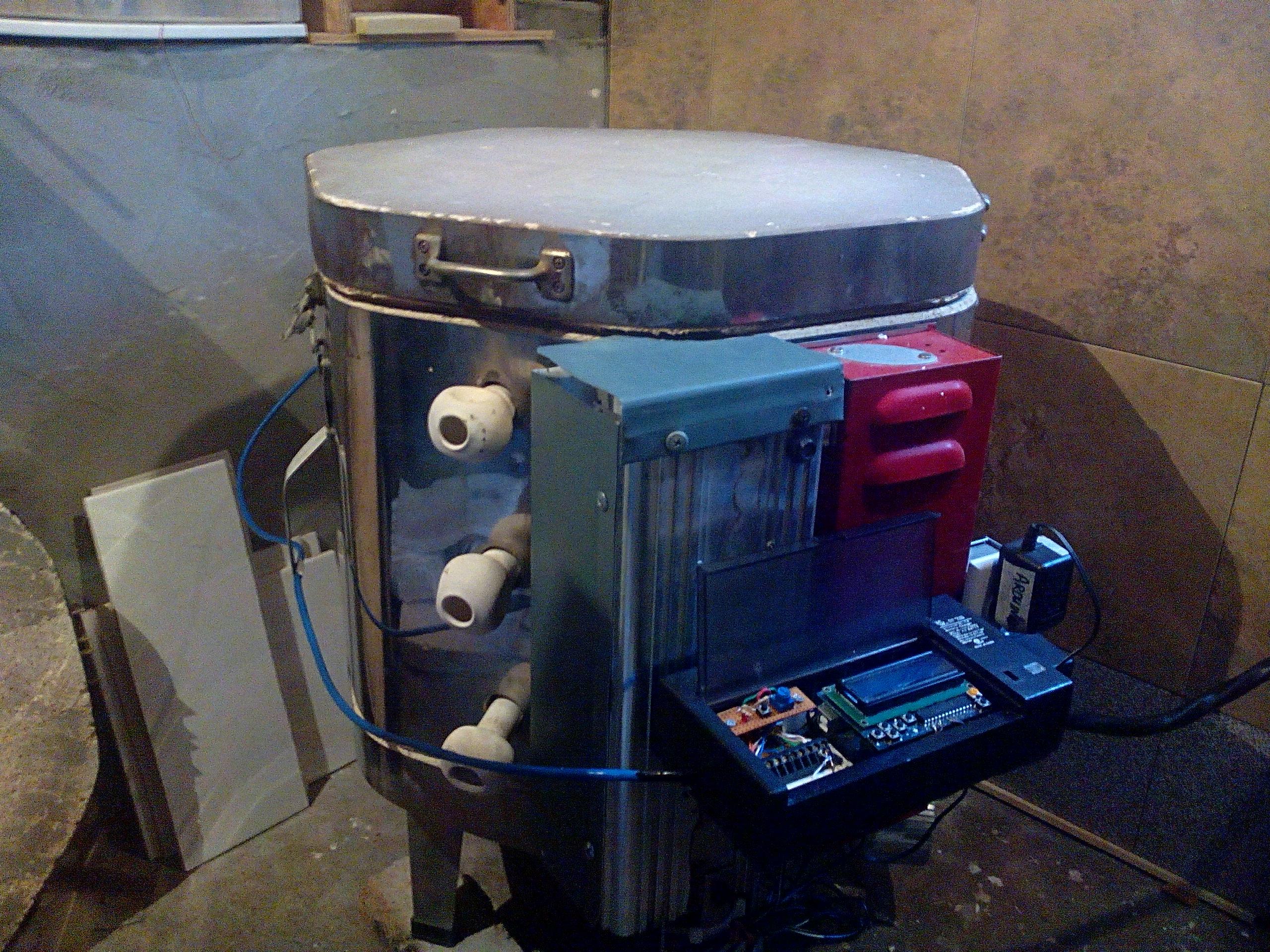

I would like to offer my input for controlling a kiln with an Arduino. I am using an Arduino Uno and a LCD panel 16 by 2 that uses the I2C interface. I also use the max 31855. These are all from Adafruit. I used  a type K thermocouple from a pottery supply company. The thermocouple has to be of heavy gauge wire at least number 14.
On the input side I added a 10k pot and a push button switch. On the output side I directly wired the Arduino  to 2 SSR relays.
There are postings on the Internet to do this with PID control. I found this to be very complex and not necessary for my application. I use it to fire pottery to cone 6. (2170 f)
My kiln is approx 13" dia and 12" deep inside . It is approx 3000 watts. The SSR relays are rated at 40 amp. I put them on large heat sink and run a computer fan to cool them.
The posting on this forum titled oven control is very similar to what I did. I will post my code when I figure out how to do that.
