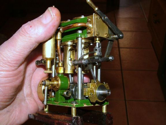

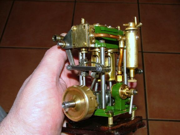

Unfortunately that will be it on projects for a while. I have some work come in over the last few days, and one of them is a rather large project in itself. See attached pics.
It was made sometime in the late 60's by an old model engineer, who has been a long time pushing up daisies. A Marcher slide valve engine, and has been used and abused for the last few years. I am having to give it a good dose of looking at, make a few replacement parts, and get it retimed in so it will last for another 40 years.
Not one to be shown as project material, as it will take all my time sorting it out.

Re: Screwcutting drop in dial revisited
« Reply #7 on: April 01, 2009, 05:34:41 AM »
Thats an interesting engine John I'll have a look at that next time I'm round

« Reply #8 on: April 01, 2009, 12:21:01 PM »
.... Looks tiny!!   :lol:     :doh:
I thought from your description of the engine it was going to be complex and full of intricate parts....  :jaw:    :)
A few pics....? No need for a major write up John.... Just a before (you've done that above) a middle (in bits) and an end (soon to be loverly and shiny ehh?)
Would that be a possibility?   :thumbup:
Looks like you might be a little busy..... But I'm still going to aim for a week day off soon, see if I can't get you to that scrappy   :)
Ralph.

« Reply #10 on: April 01, 2009, 01:21:52 PM »
Interesting looking engine you have in your hand there John
bogstandard
« Reply #11 on: April 01, 2009, 03:18:10 PM »
Yep, must be worth somewhere around a grand now.
I have a similar one to be built sometime.

Offline SPiN Racing
  • Posts: 506
« Reply #12 on: April 05, 2009, 12:51:32 AM »
Wow thats a very very cool looking little piece of kit there.
You do get some interesting stuff to play with!!!
SPiN Racing
« Reply #13 on: April 05, 2009, 03:50:55 AM »
Spin,
Bits 'n bobs like this come thru the shop fairly regularly, but this one has a little more work on it than normal.
It is no different to what you do, I am sure I would be amazed at some of the stuff you get up to.
