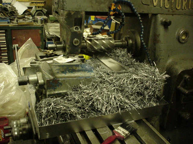

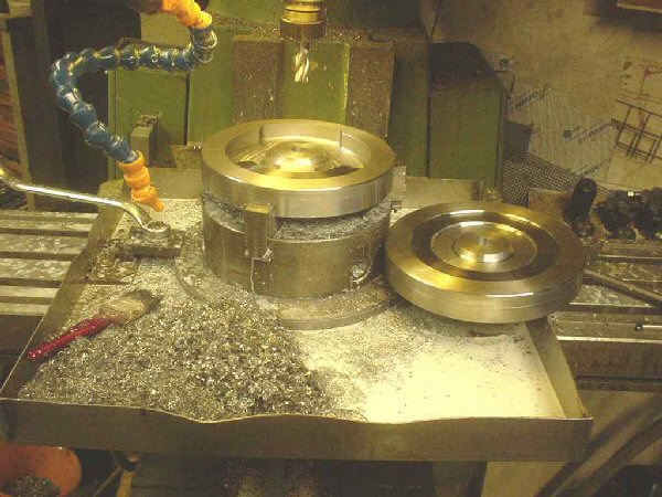

I mount my vises inside a shallow tray as I'm often running flood coolant.
All the holes / slots line up with the tee slots so they drain back.
This one is on the CNC mill and shows what would have pi$$ed all over the floor if the tray had not been there.
This one is on the old horizontal and is not a staged shot, even if it hadn't been cutting heavy the end of the vise, and the same in Bogs first picture is over the table so any coolant can't drain back.
JS.
