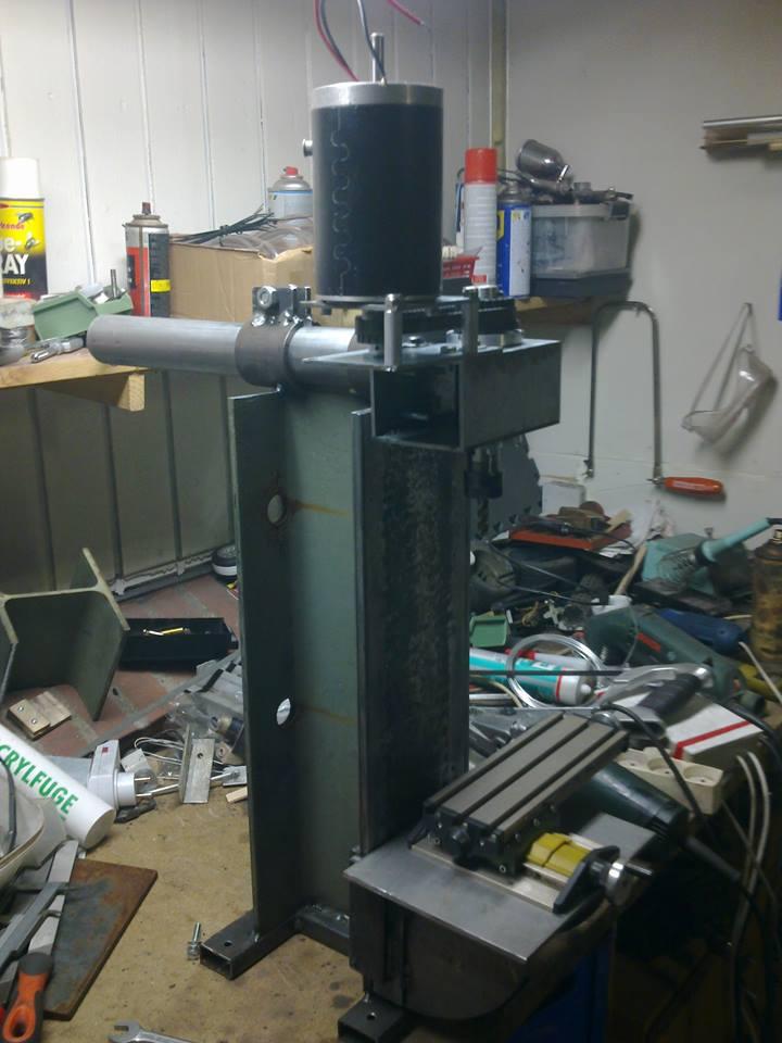

I do have one picture of the mill i build, only with a tiny proxxon cross slide table on it, and a 24 volt motor for testing purpose.
at the moment i am talking with a guy on a danish machinist forum, that when he is done using it, has offered mea scaltools bk45 mill drill at a verry fair price.
its a gearhead, barley used mine for 6000Dkr, cost from new in Denmark 30.000Dkr
But for sure it is a big satisfaction to use a tool that one has made by him self  :thumbup:

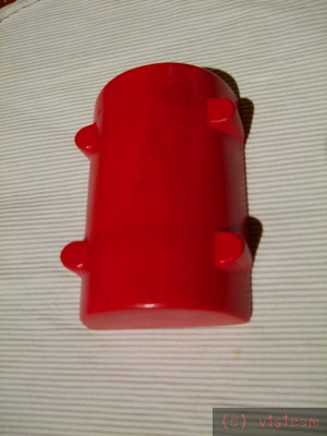

Finally something new accomplished. After rehabilitating my Tiny Furnace, I had time today to make a pattern for the headstock cap.

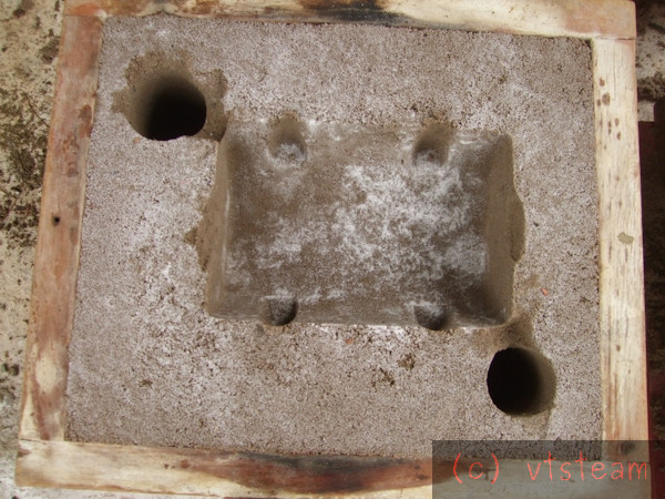

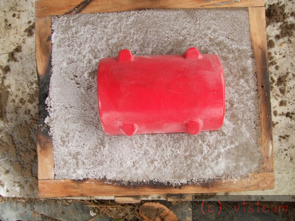

Not a promising day or time to begin casting -- it's rained all day, and I finally cleared a little space under the open shed roof and located most of my stuff, weighed out some zinc and some 6061 aluminum to alloy with it (Zamak-12 -- 11% 6061). I had to run out and get propane as I was out of charcoal. No bench to work on, just the concrete floor. But cast I must! It was 4:30.
Stooped over flippin flasks isn't ideal. But anyway...... Also I realized I hadn't put core prints on the pattern, and I didn't want to machine away the lathe spindle passage. So I thought I'd be clever and try a simple half core, baked and laid on the drag. I decided to experiment and just ram and bake some greensand as the core, rather than the old tried and Gingery molasses and walpaper paste mix. Lots of new variables!
Anyway, here's the start:

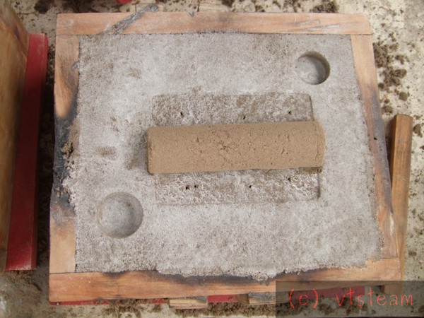

Here's the baked greensand half core on the drag. Actually I was quite pleased with the way that baked out. Decent amount of strength and easy to place. BUT, it was a little too long, as you can see here and I had to cut out the cope a little to accommodate. Unfortunately by doing without core prints, I couldn't invert the flask and make this the cope, because the piece is loose. That reduced the head pressure I could achieve above the casting.

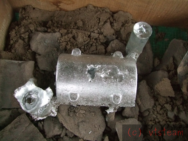

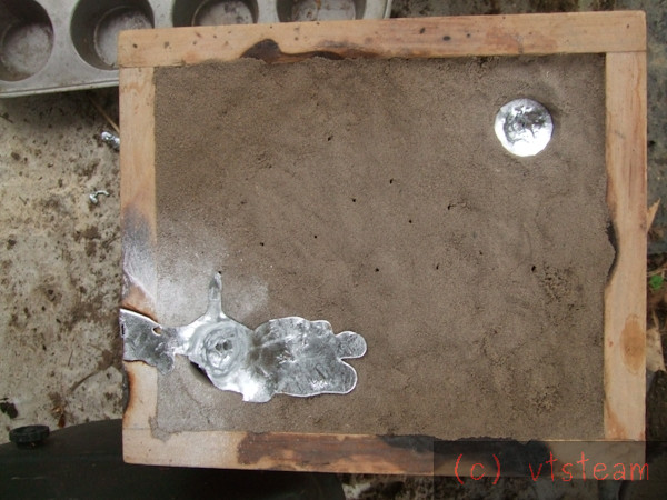

And the pour. I had forgotten how extreme shrinkage is with Zamak. The sprue and riser were both topped up completely before it began to cool.
  • Posts: 6941
Re: Building a New Lathe
« Reply #397 on: May 06, 2018, 07:00:15 PM »

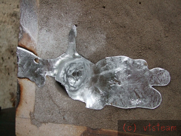

Now that's shrinkage!
  • Posts: 6941
« Reply #398 on: May 06, 2018, 07:01:37 PM »

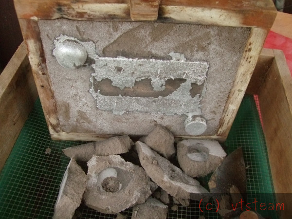

Always hopeful at this point -- first sight of metal in the sand:
  • Posts: 6941
« Reply #399 on: May 06, 2018, 07:08:36 PM »
But no cigar. Nice casting otherwise, but a giant shrink cavity in the center!  :wack:  I should have added core prints and done a proper baked core. Then the flask could have been flipped again putting the casting in the drag instead of the cope, and plenty of head pressure and molten metal to feed it.
Oh well, first time back casting after a couple year lapse, and my planned molding bench would have eased the back ache. But hey I POURED METAL today, and better things to come... :ddb:
