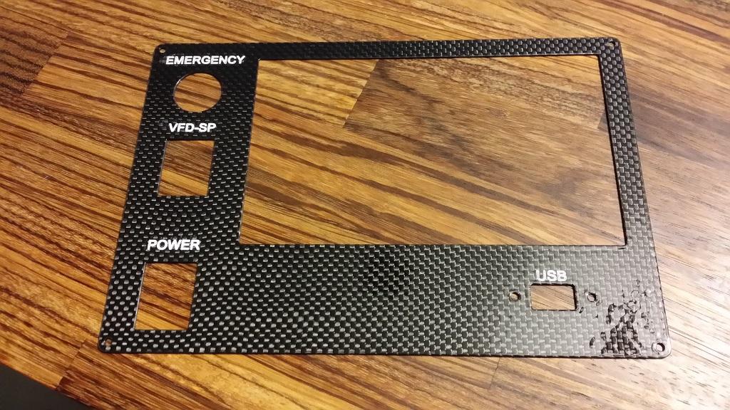

Here is the painted panel guys
« Reply #251 on: November 25, 2016, 06:02:15 PM »
Looking good apart from the bottom right hand corner - what happened there  :scratch:
Offline Merlin201314
  • Posts: 121
  • London
« Reply #252 on: November 25, 2016, 06:03:38 PM »
Nothing,  is just the light 💡  reflection

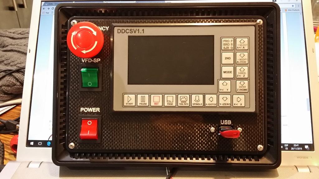

« Reply #254 on: November 26, 2016, 05:51:09 PM »
Hi all,
here is the final result,
i'm not happy at all about how i positioned the spindle switch! :bang: It should be much lower.
Never mind, the next will be much better than this one......... :ddb:
