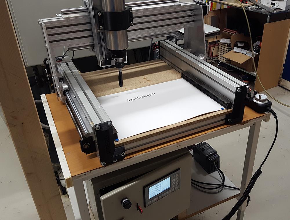

This file is 100% processed on my machine with the DDCSV1.1 - 4 axis controller. Firmware from November 2017.
Sorry for my english, this is Google translator

« Reply #873 on: February 15, 2018, 01:16:42 PM »
Hello all DDCSV user. Im all new to cnc machines and its software, but I like to build and make things so now its time for a cnc.
I have ordered a few things for several months from China to lower the costs, collected aluminum profiles from the job scrap box and so on.thought it would be a machine that can do wood and metal, I´m working in a paper printing factory so manufacturing of klichés in brass are things that I though may be done.
there are still some screws left for the machine to get really sturdy but this week it was time to boot everything up
I use Fusion 360, same as for my 3d printer for modell and Cam. Postprocess /Othermill/
  • Posts: 1310
« Reply #874 on: February 15, 2018, 02:06:29 PM »
Looks like a nice built unit.
