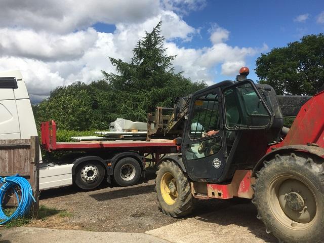

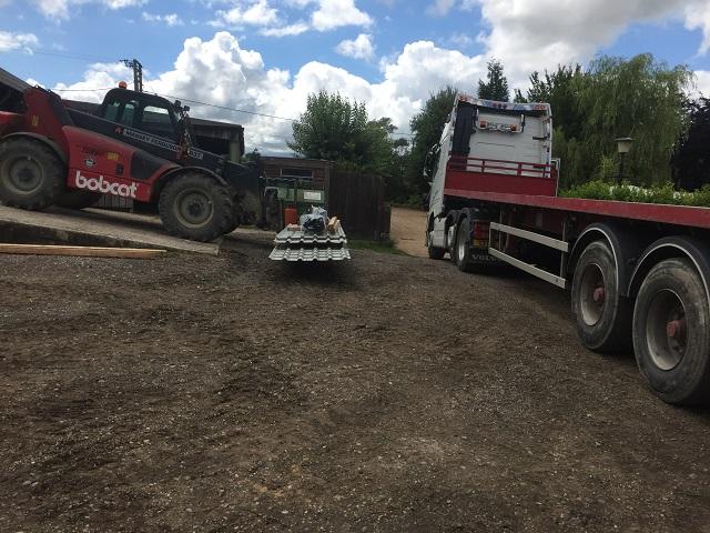

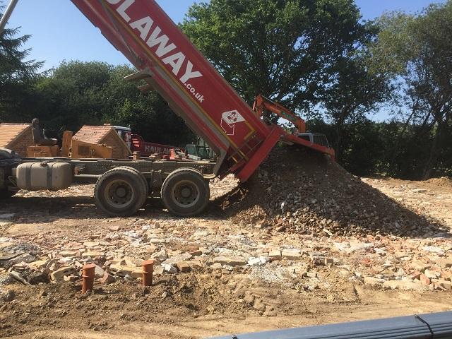

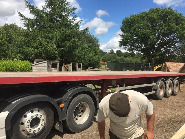

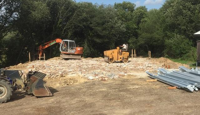

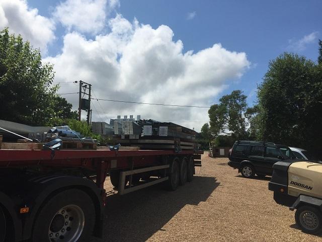

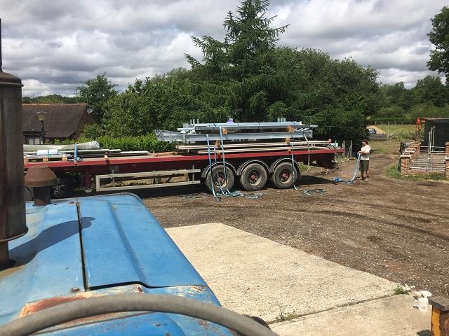

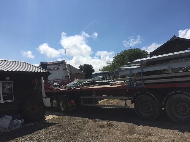

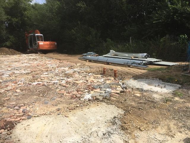

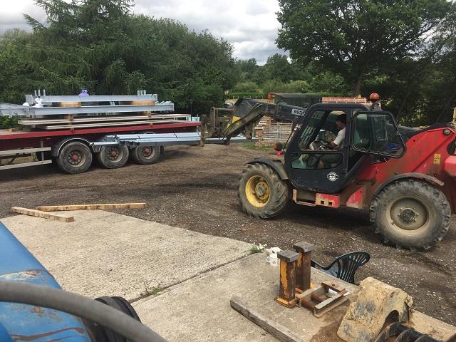

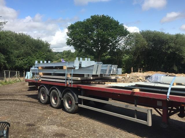

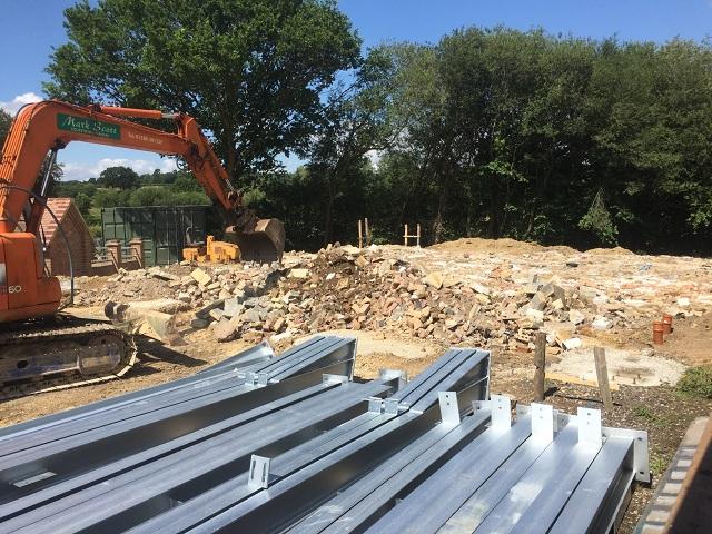

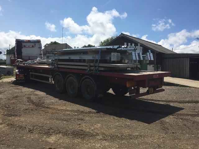

So today was the grand delivery day for the 'Tractor Shed on a Lorry' - supposed to be here about 12 noon, so before that the remains of my 'hardcore pile' was transferred to the shed base and pushed about a bit to get it vaguely level. Still need to add about 100 mm and to that end I have ordered two 20 ton lorry loads, due tomorrow after noon, of crushed concrete '75 mm to dust'. This will make a good finish layer.
In the remaining time Darren continued building up the stream bank to for a roadway access to the triangle of land behind the shed. He incorporated those heavy duty iron pipes that we pulled out as reinforcement, We also 'lost' that huge root that caused me all the grief in the early part of this project.
Then the shed lorry arrived and there was a great bustle about  unloading it and putting it where it wont get damaged.

So with all that done Darren started Vibro-Rolling the hard core.
The 'master plan is to spread a bit of the 'crush'  on it tomorrow to give a good working surface. The shed will then be erected with the 500 mm concrete side panels above the crush a bit which will be made up to 'final pre-floor' level. Then the concrete floor will be laid with about 50 mm above the panels on the inside, and 25 mm on the outside to prevent rain entering. Apparently this is standard construction for grain sheds so I'm happy to go long with it  :thumbup:

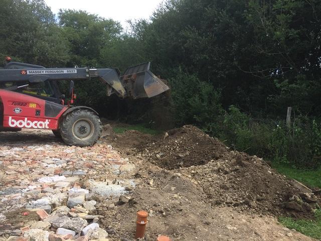

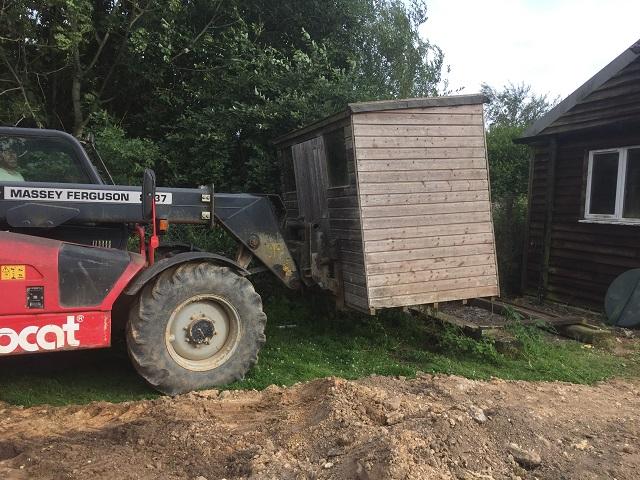

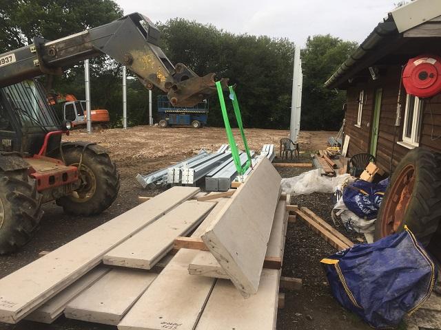

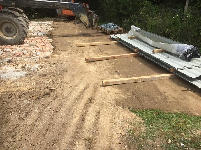

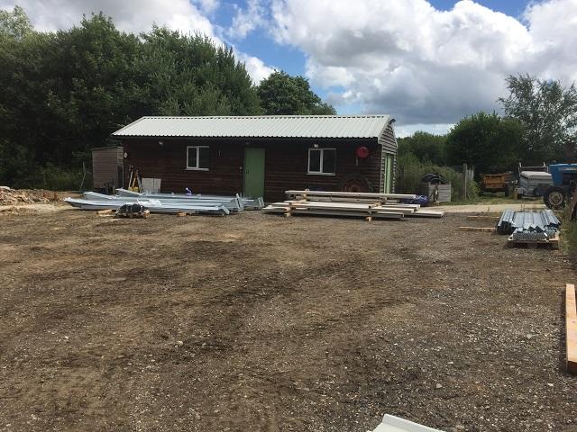

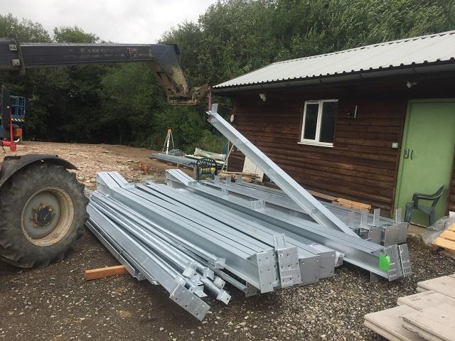

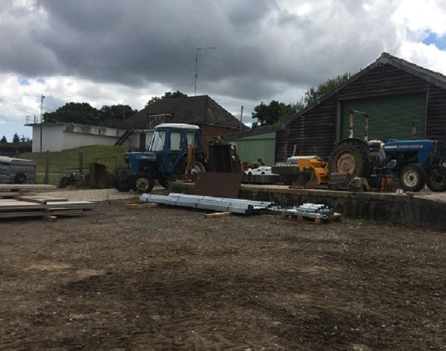

Friday was a bit of a clearing up and tidying day while we waited for the 40 tons of crushed concrete to arrive. We needed to clear a path through to my stock trailer as it was needed at the weekend, and also move an old shed that the grandchildren had a few toys in, before it was 'land locked'  behind the new tractor shed.
So first out came the 'toy shed' on the Telehandler (handy bit of kit, I wish that I had one!) and then changing it's forks for a massive bucket we moved four lorry loads of top soil (80 tons !) from their piles in the field to round the back of the tractor shed. This not only formed a base on which to stack the side sheeting and 'Z Purlins' but also considerably  re-inforces the built up platform to stop things spreading. Eventually it will be tapered as a slope outwards, but we left it level as a running surface to help during erecting the steelwork.
It was all a bit hectic, as the Bull Calves in the field, being inquisitive, wanted to put their noses into everything and wander through open gates, and the field gate obviously had to be open for shifting the earth. As a safety precaution we closed the gate between the inner and outer farm yards, but of course the pair of eight wheeler lorries AND a cottage guest AND the Tescos delivery that the guest had arranged all turned up at the same time. Never mind, my hair can't go much whiter  :ddb:
As things calmed down a bit Darren spread the first 20 ton of crush as a working surface inside the Tractor Shed, then Vibrorolled it in. When the steelwork is up, we can bring the sub-surface up to final level ready for concreting.
We should be 'good to go' to start bolting all the steelwork together on Monday - after all it's only very heavy 'Meccano'  :lol:

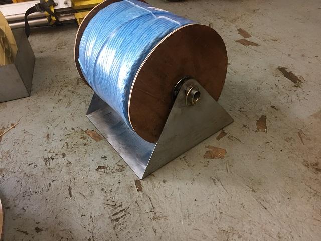

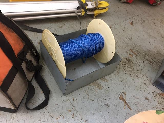

Perhaps I should first explain that each duct that I lay for cables is always left with at least one 'pull through' rope for future use. And usually you need rope twice the length of the duct if multiples of cables and pipe are being installed.
As my reel of 'pull through rope'  - which is three strand 6 mm o/d polypropylene - was running out I had ordered and received a new 500 metre reel, but although mounted on a cardboard tube, it had no cheeks to keep it in order. So yesterday I made up a pair of 4 mm plywood cheeks, and some metal collars that nicely slid onto the bit of scaffold pole that I used as a core (nice tight fit in the cardboard tube), and tack welded the collars to the tube to hold it all together.
Today I decided that my previous arrangement of just plonking the reel in a box to stop it rolling all over the place when the rope is pulled was unsatisfactory. Time to make a proper 'reel holder'.
Step forward the ubiquitous CNC Plasma Table. In no time flat, a bit of 2 mm Zintec sheet was cut to profile, a couple of bends in the Edwards Box and Pan Folder, and a reel holder emerged - axle is a bit of 20 mm steel electrical conduit.
(The reel is about 12" diameter)
Oh I DO love my CNC Plasma Table  :lol:

Very neat cable reel. But, if it was mine, it would be rolling all around the floor as the rope came off. The gremlins are obviously much kinder to you.
  • Posts: 9118
Re: New Tractor Shed
« Reply #184 on: July 23, 2017, 02:49:55 PM »
Pete the carrier is quite weighty, and with the lead out down into a hole and pulling gently it should be fine. Even the old one that just sat in a metal box 'sort of works' !

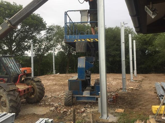

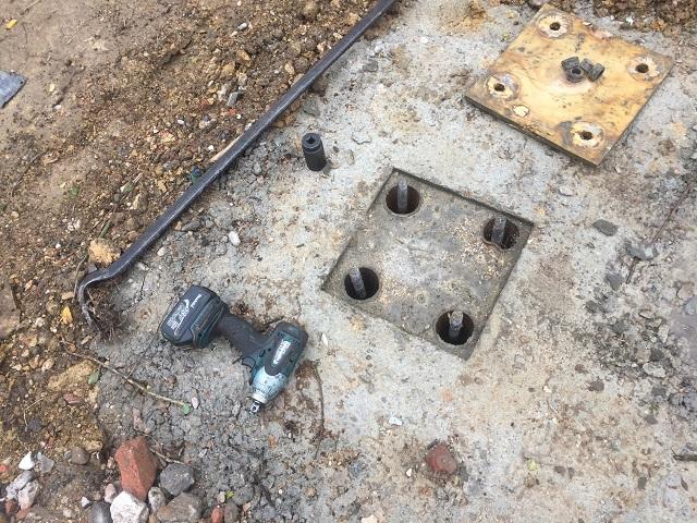

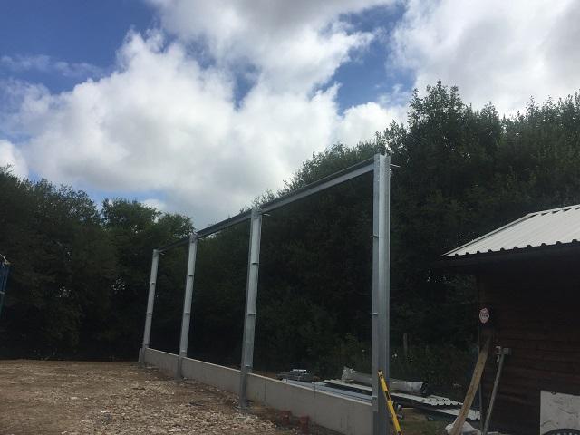

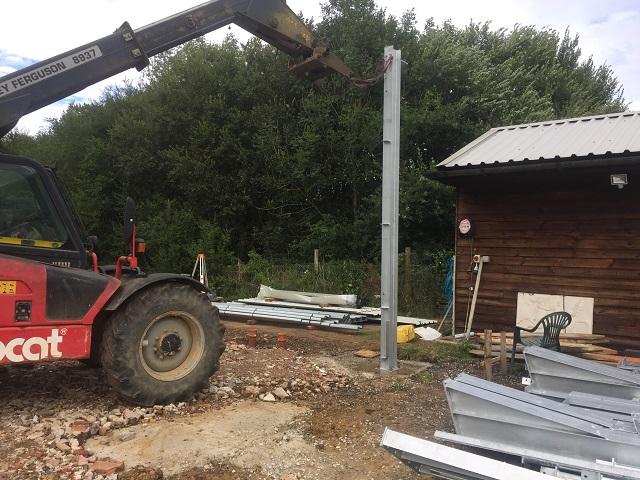

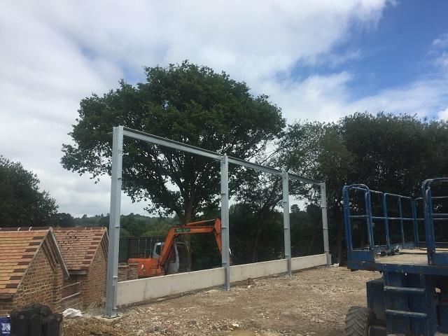

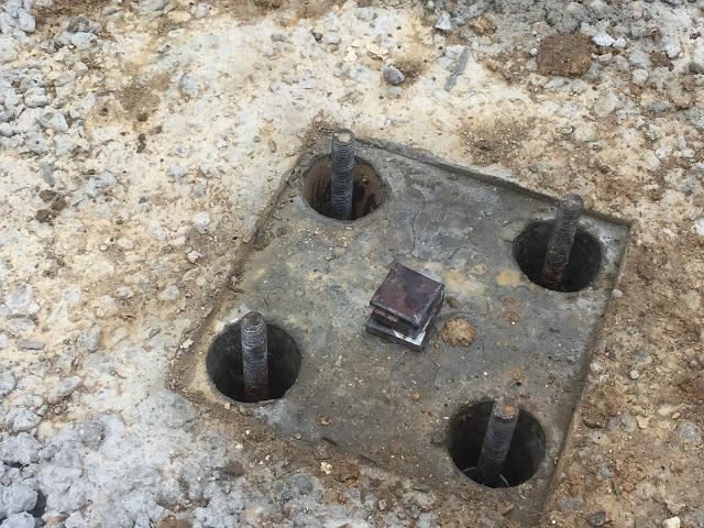

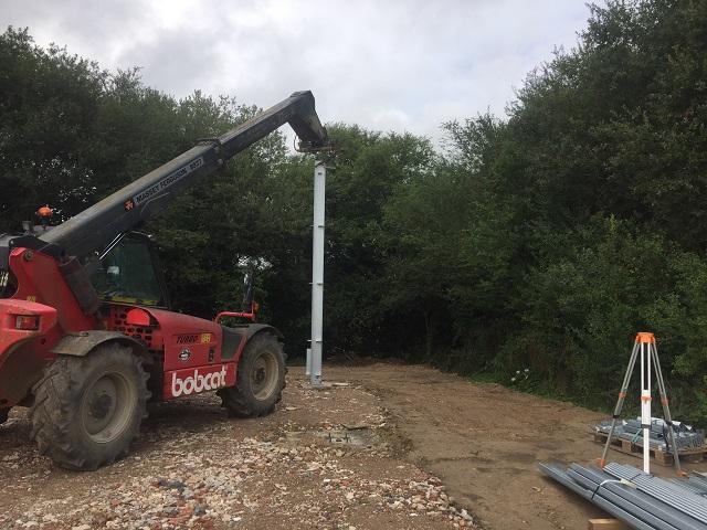

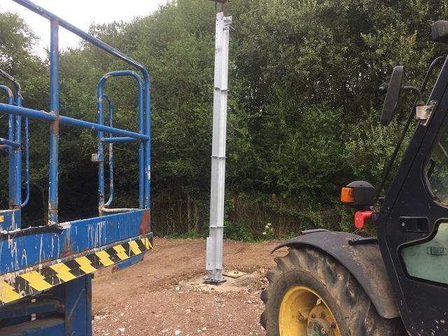

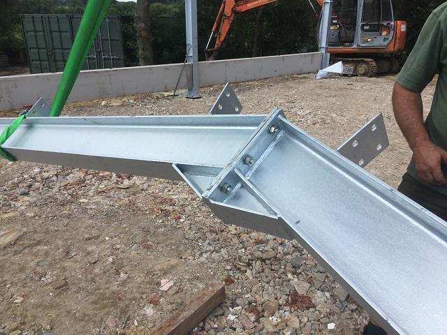

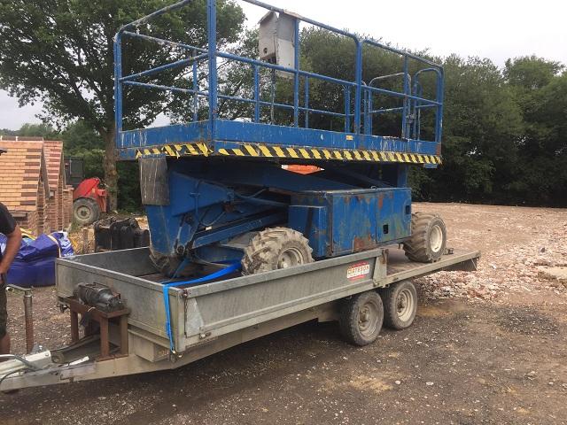

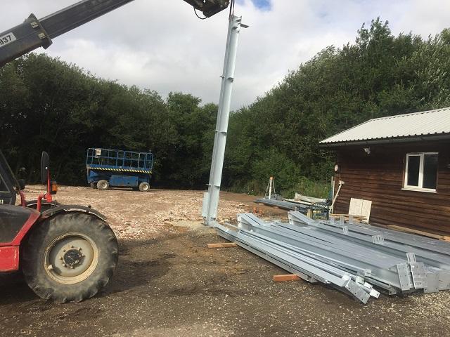

Today we got off to rather a slow start - the weather wasn't too good in the morning and also Darren had brake issues with his trailer. However 15:30 brought him here along with yet another toy - his self propelled access platform.
Having unloaded it he got on with exposing all the hold down bolts, removing their greased cardboard cones, and setting packing pieces to a laser level to bring them all up to an exact height.
Then he started placing the 'goal posts' that form the sides of the shed and take the portal frames for the roof.

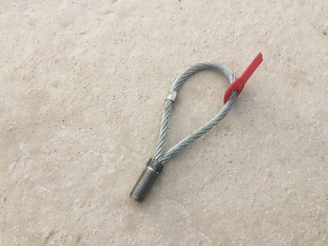

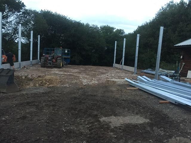

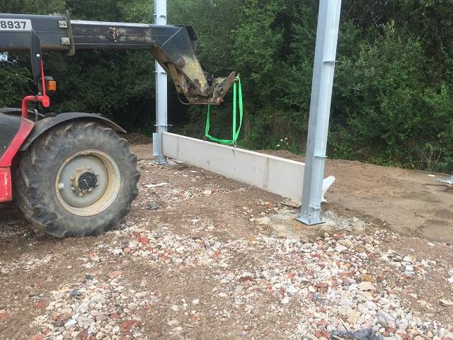

Then it was the turn of the concrete panels. These will be embedded in the concrete of the floor, and are 500 mm tall - their purpose being to keep the side sheeting out of the ground and reduce rusting. They create a watertight joint at floor level, with the outside being formed an inch or two lower than inside.
The 'shed kit' came with a pair of crimped cable lifting eyes that screw into sockets cast in the panels. The panels fit tightly on their length between the webs of the 'goal posts' and rest on brackets that are integral with the posts. As they were such good fit each post had to be tilted a bit by slackening it's bolts, to get the panel in - a very dodgy looking operation  :bugeye:
All but one of the side panels were installed before it became too dark.

Please, sir, please sir,
How did you unload the self-propelled elevating platform from the trailer??
  • Posts: 9118
« Reply #191 on: July 25, 2017, 05:25:04 AM »
Rather dodgy ramps Pete   :bugeye:

Water will certainly pass through the building on it's way to the pigs & chicken, not sure if it will actually be used / accessible in the shed - no real need.

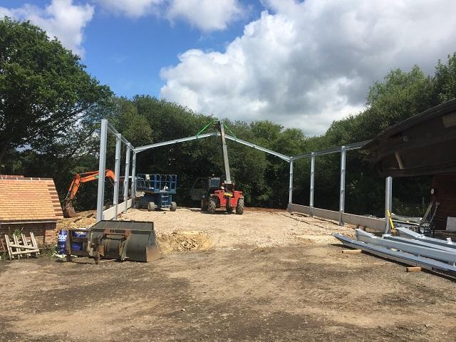

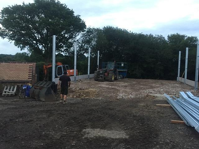

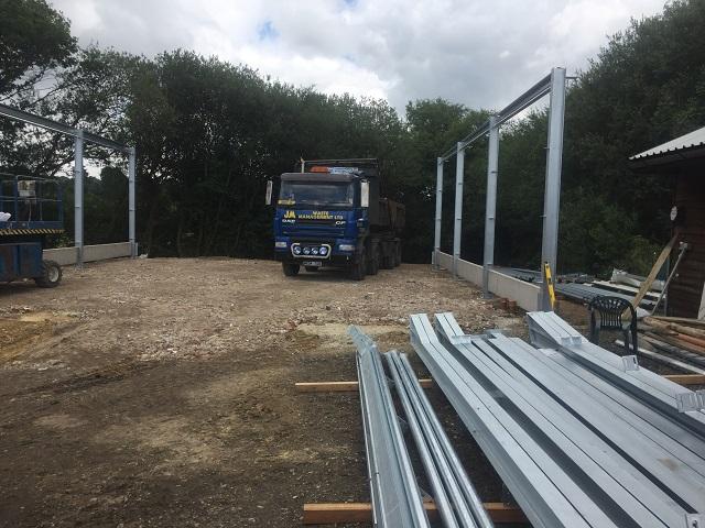

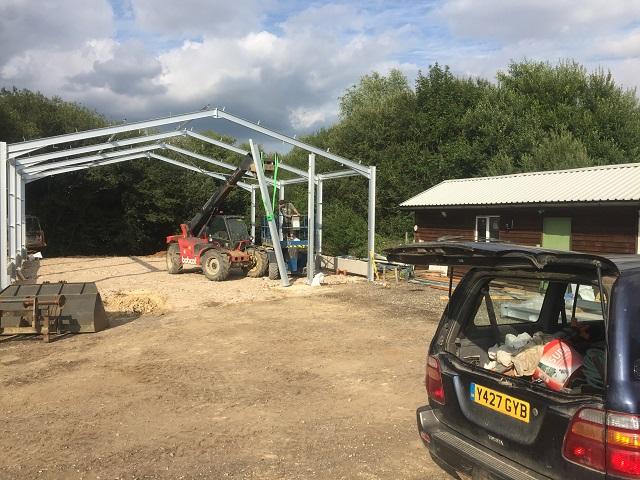

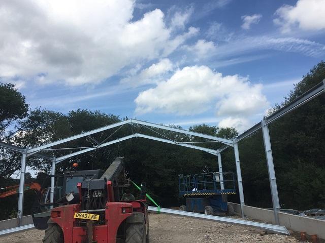

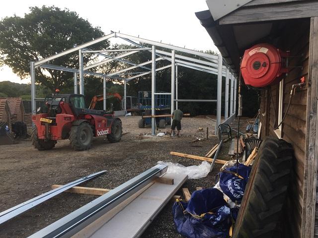

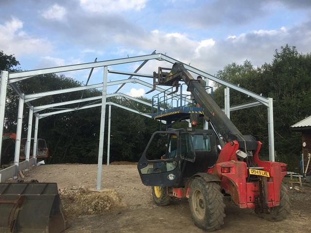

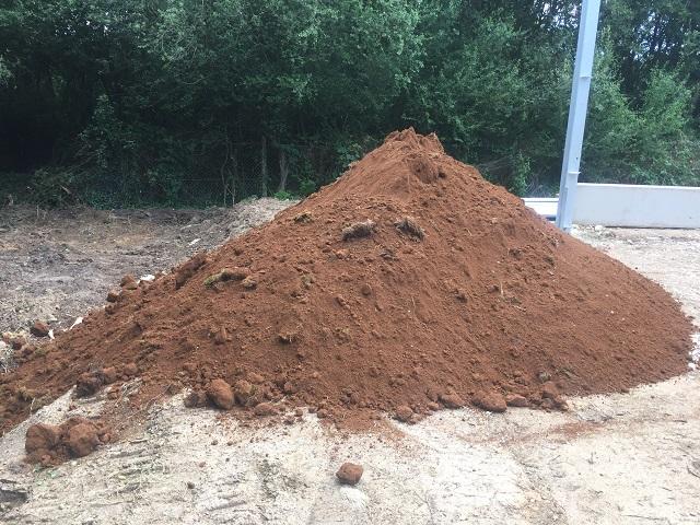

Major progress with Darren putting in a long day. First he fitted the last of the concrete panels, and then went about fitting the six Eaves Beams.
When this was done, an extra 8 wheeler / 20 ton load of sandy topsoil arrived to build up behind the shed. He was able to reverse inside and tip through the open rear wall to save numerous Telehandler journeys  :thumbup:
  • Posts: 9118

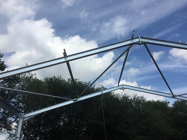

« Reply #196 on: July 25, 2017, 06:12:12 PM »

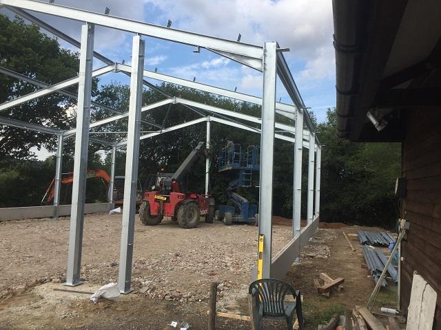

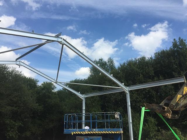

Then it was the turn of the 'Portal Frames' and their bracing beams

Then the posts that go either side of the main roller shutter and pedestrian doors. These 'hang', are then squared up, and then anchor bolts are drilled into the concrete footings. This is unlike the other posts, where the anchors were cast in the concrete
  • Posts: 9118
« Reply #198 on: July 25, 2017, 06:22:37 PM »
At least now it looks like a shed  :thumbup:
Obviously there is still much to do structurally: The front and rear concrete panels need fitting. Numerous 'Z purlins' have to be fitted. The floor hardcore needs bringing up to 150 mm below floor level. Then the roof sheeting can go on. Then 150 mm of concrete needs floating to a smooth finish. Then the wall sheeting . . . .it goes on and on  :bugeye:
