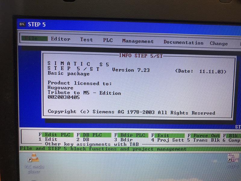

For any one passing this way who is familiar with STEP5 software and can offer help, this is the version information:
  • Posts: 9114

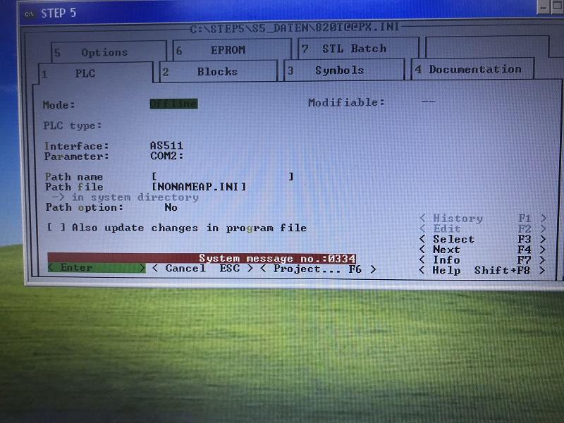

« Reply #429 on: October 05, 2018, 06:34:25 AM »
Progress comes in tiny little bits after expending hours faffing about  :lol:

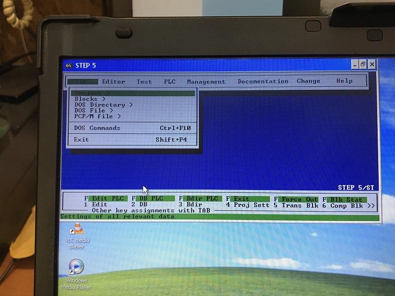

At last I've found the bit in STEP5 that lets me select the correct COM port (COM2: on this laptop) - now the book of words for the 820T controller doesn't directly refer to STEP5 talking to it's interface, but it does refer to "PD/PG Programming Workstation" and gives me parameters for the interface (4800 baud, 8 data, 2 stop bits, no parity, flow control via XON/XOFF) and gives a 'device code 3' in the setting bits so the controller knows what it's talking to. What it doesn't say is what I need to do at the controller to start the two talking ! At the moment I've just experimented in the 'data-in start' mode.
Using XP's Device Manager to set the COM port to match and thrashing about again in STEP5 I find a bit where the PLC can be set ONLINE from it's current 'OFFLINE' state. If I do this it give me a message saying that it's checking the interface, but then comes up with a red error message "System Message no. :0334"
Is this progress - yes I think that it is of a sort - the STEP5 program is at least acknowledging that is has a port to talk to but presumably doesn't like what's being whispered in it's ear !
The major issue is that I have no documentation for STEP5 and haven't so far been able to find a source.

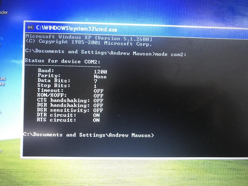

  • Posts: 9114
« Reply #435 on: October 06, 2018, 05:22:17 AM »

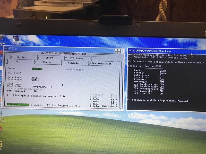

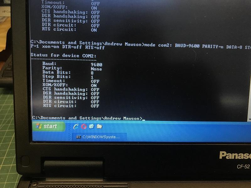

I started this morning with three objectives:
a/ Prove the COM2: port on my laptop is working
b/ Prove that STEP5 is talking to the correct COM port
c/ Make sure that the baud rate, word length, parity and flow control all match
So by connecting my trusty RS232 breakout box using the same cable that I've been using to try and talk to the PLC, going to the command prompt under WIN-XP-Professional and issuing the command:
COPY CON COM2  (copy blocks from the CONsole to COM2:)
Sure enough I get activity on the transmit line - good, the port is working OK

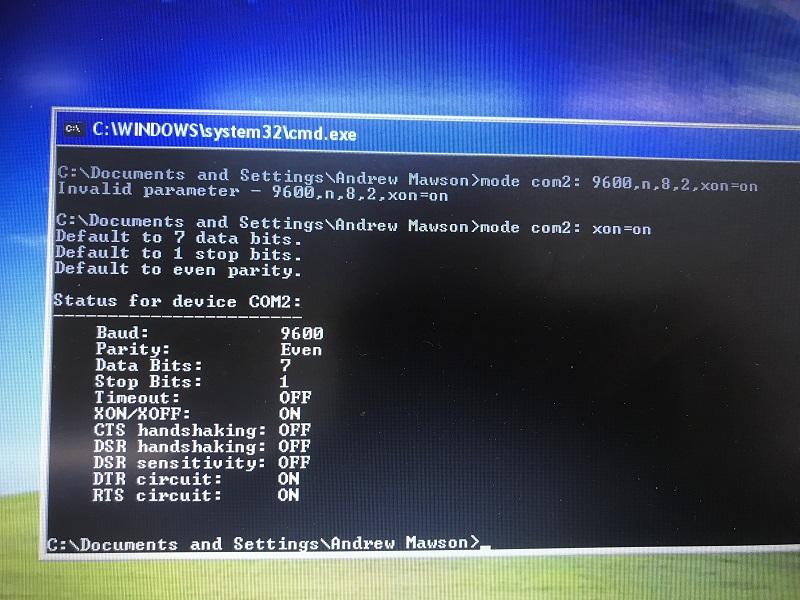

Now here comes the oddity. If I use the MODE command to show how the port is set up I get 1200 baud, no parity, 7 data bits, 1 stop bit Xon/Xoff disabled and DTR/RTS enabled. But I have set it in Device Manager to be 9600 baud, no parity, 8 bits, 2 stop bits, using Xon/Xoff - see the picture with both on the screen at the same time !
So what happens if I run STEP5 with the port connected still to the breakout box? There is transmit activity - STEP5 IS talking to the correct com port :thumbup:
But look what happens to the port settings - under MODE we now have the correct baud rate, but wrong parity and flow control but under Device Manager everything is correct  :scratch:
And if I bring up Device Manager and the Command Prompt screens while STEP5 is running they still contradict each other  :scratch:
Another oddity is that I cannot get the MODE command to accept a setting for Xon/Xoff - I must not be understanding the syntax despite having the crib sheet on screen by entering mode /?
So something odd going on here - until I can get consistent port settings the PLC ain't going to talk ! Who is controlling this port ????

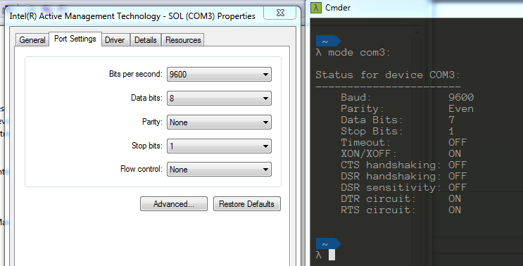

  • Posts: 2487
« Reply #436 on: October 06, 2018, 06:43:01 AM »
This:
Code: [Select]
MODE COM3: xon=on
worked for me...
Interestingly, I have mis-matched port settings in Windows 7 as well.... although this laptop doesn't have a real serial port, I wonder if Windows & "DOS" are somehow talking to different things?

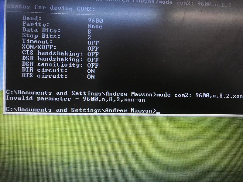

This mode thing is VERY odd. If I use your syntax as a single parameter sure enough I can enable XON but not as one of a line of parameters.
If I set baud rate, no of data bits and parity as a mode command then follow with mode com2: xon=on as a subsequent command it sets XON ok but resets the bits back to 7/1  leaving the baud rate at 9600 :bang:

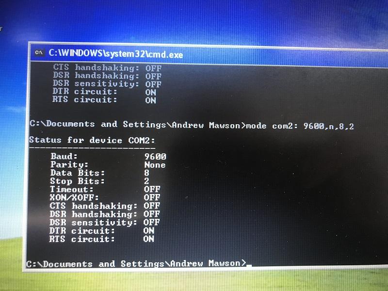

A quick Google seems to suggest that the defaults are 9600, no parity, 8 bits, 1 stop bit and xon/xoff. it suggests that you do not need to configure the handshake.
MODE COM2: 9600,n,8,2 should do the trick.

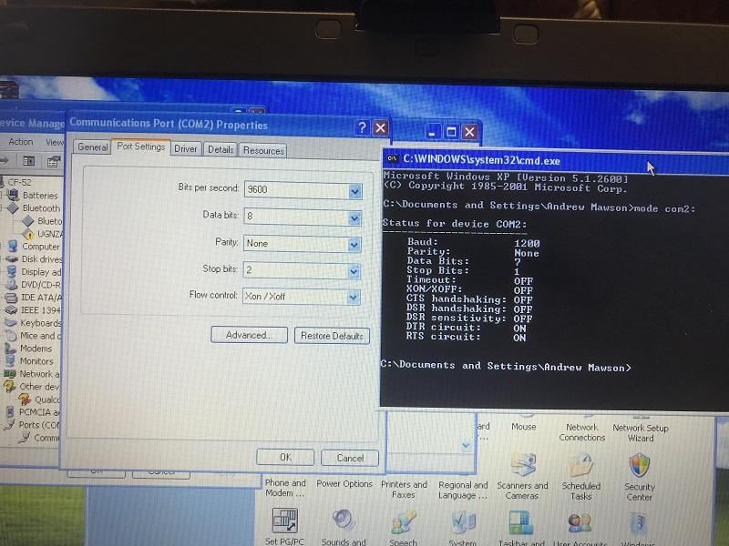

  • Posts: 9114
« Reply #441 on: October 06, 2018, 10:47:09 AM »
Thanks, but if you look at the last picture you will see it actually defaults to 7 bit 1 stop and even parity  :(
And with your command line it reverts to RTS & DTS with XON disabled but does set the baud rate etc OK as shown in picture 2 above where that is the mode command that I issued !
It wasn't until I looked at that picture I realised it actually told me what it was defaulting to !

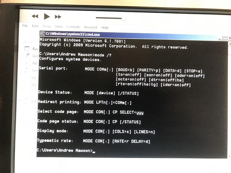

You could try this syntax
Serial port: MODE COMm[:] [BAUD=b] [PARITY=p] [DATA=d] [STOP=s] [to=on|off] [xon=on|off] [odsr=on|off] [octs=on|off] [dtr=on|off|hs] [rts=on|off|hs|tg] [idsr=on|off]
IE
Mode com2: BAUD=9600 PARITY =e DATA=8 STOP=1 xon=on
Russ
« Last Edit: October 07, 2018, 06:49:00 AM by russ57 »
  • Posts: 9114
« Reply #444 on: October 07, 2018, 09:46:34 AM »
Russ you are a genius  :bow:
Yes that works and not only can I set the correct bits, baud rate and parity using Xon, but it actually remains unchanged having been into STEP5 and then out. I can't use the MODE command when actually running STEP5 as MODE complains that that port isn't available of course.

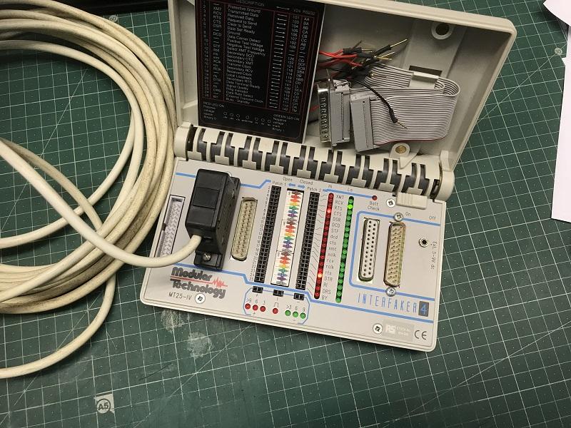

Today's plan was to connect up my Tektronix 834 RS232 analyser and try and watch the traffic between STEP5 and the 820T controller, having firstly re-taught myself how to use it after many years gathering dust.
First - set up it's interface to match the laptop - COPY CON COM3: and sure enough 'THE QUICK BROWN FOX . . . .' ends up on the analyser screen.
Next - connect the 834 to snoop on the line - now this requires a three way D-Type cable IDC cable. Male at one end (for the 820T), Female at the other (For the STEP5) , with a Male in the middle (to connect to the 834 Analyser). I used to be awash with these, and also the IDC plugs and sockets to make them - always useful on site to make up odd connections to printers, modems etc. Could I find one - of course not  :bang:
OK lets see what STEP5 is sending out on the interface even if we can't see what does or does not come back from the 820T controller as this just needs a simple male / female cable.
Answer:  STX NULL BRK NULL BRK STX NULL BRK
So what did I learn from that? Not a lot except that presumably it's polling the control and waiting for a response, then not getting what it expects it times out.
I still don't know what mode or state the 820T controller needs putting in for all this exchange to work. I've been assuming it needs to be in the Input/Output mode waiting to receive, but that is just guessing. But at least thanks to Russ the mode issue seems sorted.
Order for D-25 IDC plugs and sockets placed with RS-Components - should be here Tuesday  :ddb:

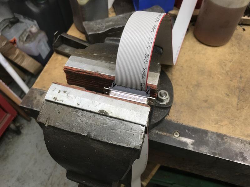

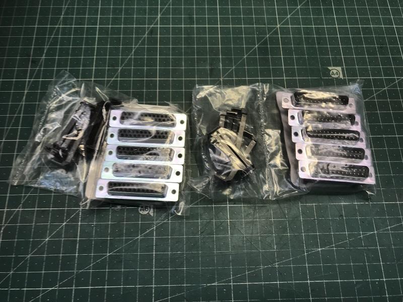

  • Posts: 9114
« Reply #449 on: October 09, 2018, 08:20:10 AM »

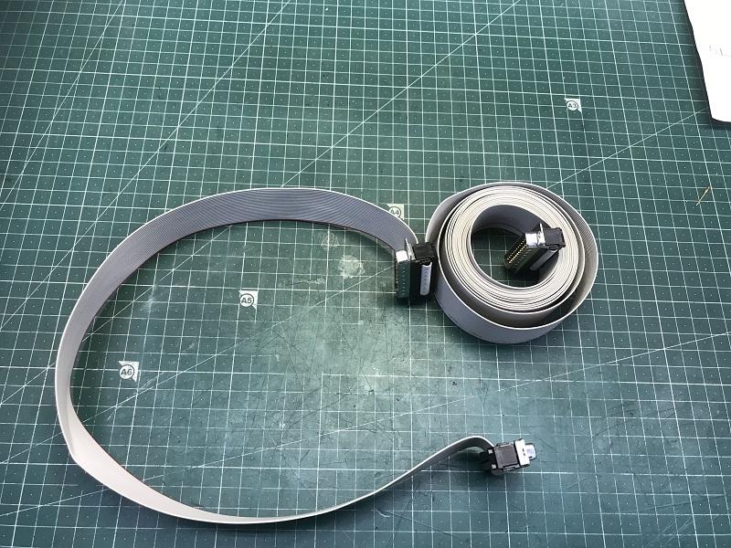

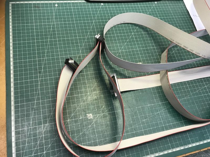

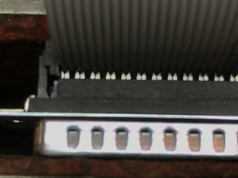

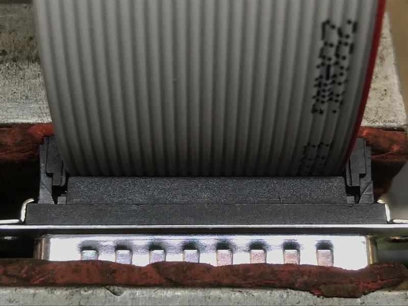

The IDC-D-Type male and female connectors have been delivered, so I set to making up the three ways cable. Somewhere I have the proper squasher for making these cables, but for a one-off the vice with soft jaws was perfectly serviceable.
So, cable made up, Tektronix 834 and Sinumerik 820T steamed up and interconnected to my Toughbook CF-52 running STEP5, and full of expectations I told STEP5 to go on line.
. . . result ?  . . nowt, no response what so ever, the 820T sits there like a sulky child doing the dumb insolence thing  :bang:
In desperation I set the interface to use RTS/ CTS and then DSR/DTR but no, still no response at all although the controller was happy to push out its same polling sequence
