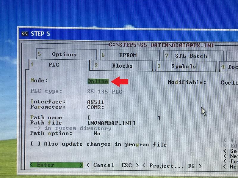

We're On Line !!
Thanks to a user (Pea Ell Sea) on the Siemens support forum I've found that the value for parameter #5010  needs to be 00000100. This value of 4  brings up "PLC-Prog" on the Sinumerik 820T input screen and the STEP5 program goes 'online' and reports PLC Type as S5 135 PLC.
One hurdle surmounted after days of trying  :ddb:
The next mountain to climb is to learn more about STEP5, so that I can have a look at the PLC program and hopefully see things in real time.
Decided not to plough on immediately in case I break something - take the dogs for a walk and have a good think then lots of  :coffee:

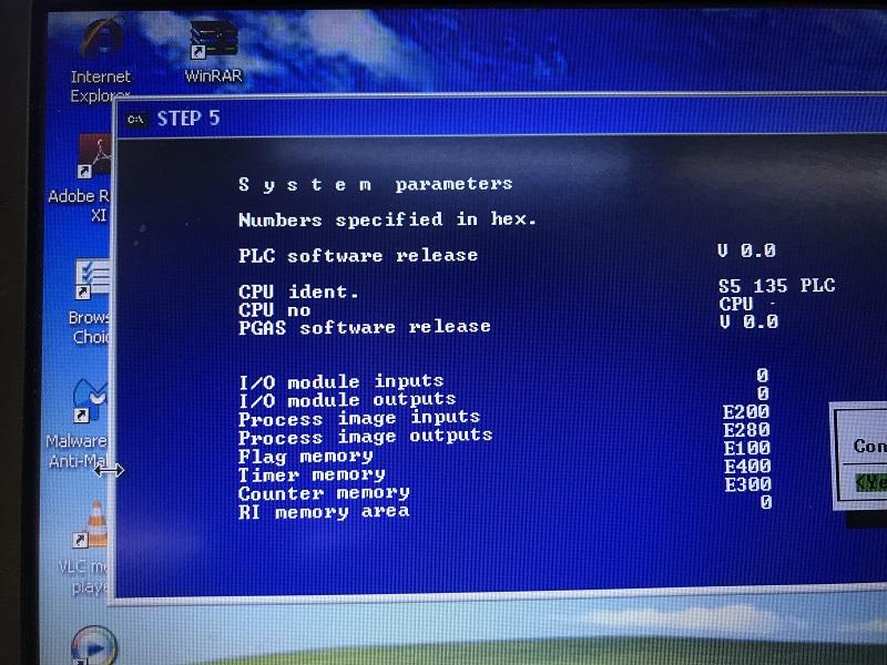

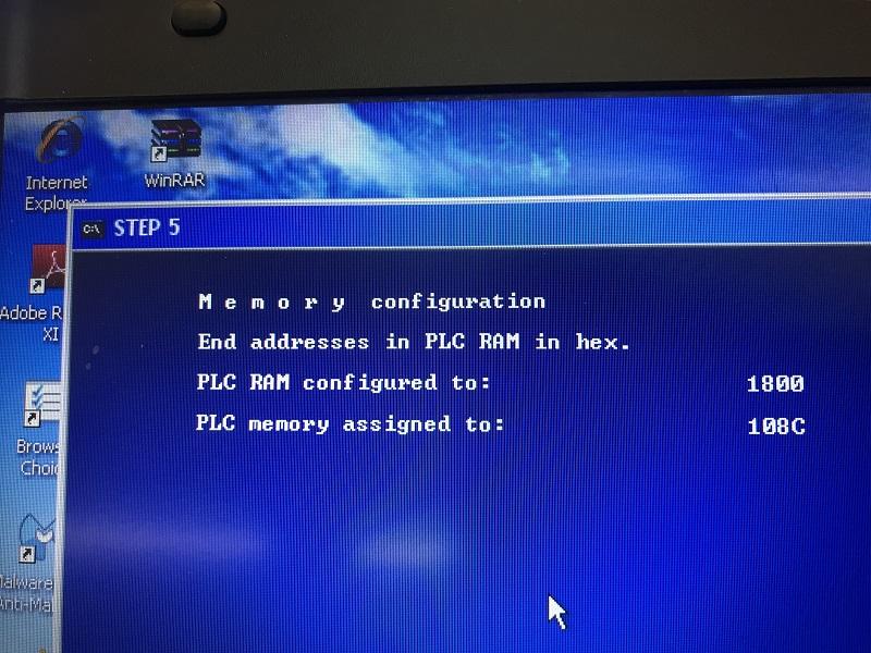

I've been unable to work in the workshop all yesterday due to a plague of flies - literally thousands of  them, but I think I've now got them down to manageable numbers, with just the odd one or two pingng off fluorescent light tubes. I think something must have died on the roof.

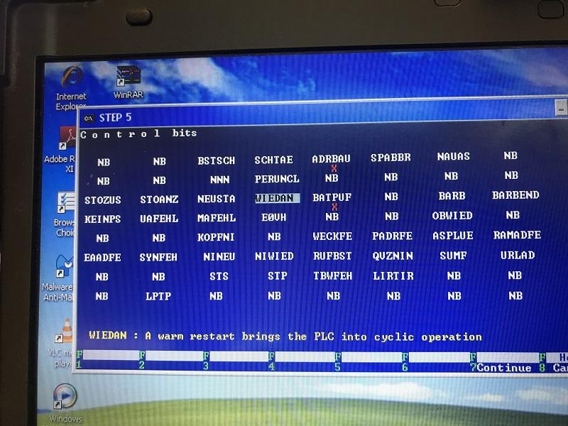

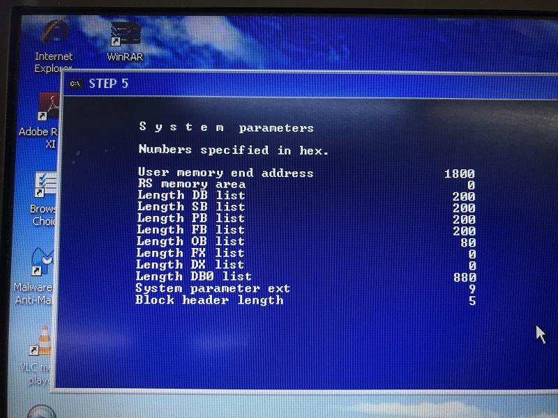

So now back in and working I've been doing a bit more investigation of what I can see in the PLC via STEP5. The PLC program comprises 'blocks' of instructions, arranged as 'organisational blocks', 'program blocks', 'function blocks', 'sequence blocks', and 'data blocks'. One of the myriad of STEP5 facilities is to download these various block either by their reference numbers, or all together as one file. Trying the latter approach (as I don't yet know the reference numbers' seems to start off OK, loads of data being transferred, then everything locks up, STEP5 freezes, Program Manager shows it's using 100% of the CPU time, and the only way to stop it is to use Program Manager. When PM stops the program the entire operating system crashes  - yes this is repeatable  :bang:
So what blocks do I know should be there - apparently all the PLCs have OB 1, which is the interface between the operating system in the 820T controller and the  user program. So I set it up to down load OP 1 - and it did it ! But I can't find how to read the file I've downloaded !
OK what else can I do - well there are various internal things in the PLC that can be brought up on the screen - not yet familliar enough to know what it all means but I suppose it's a bit more progress - have a few screen shots !

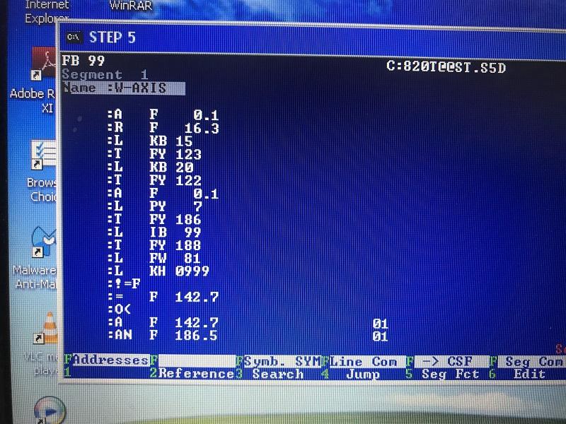

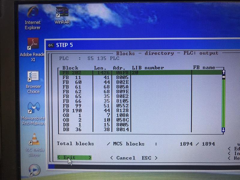

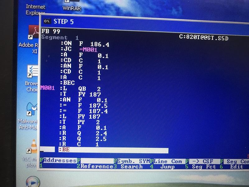

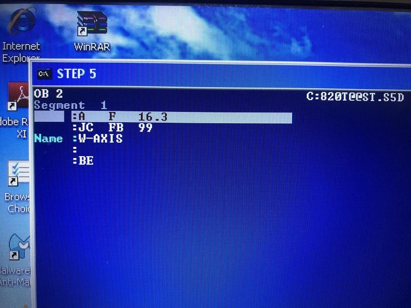

A bit more poking about confirms that I have managed to download three 'blocks' from the PLC and can examine them and potentially edit my local copy. I don't think I can modify the code in the 820T PLC yet as A/ some is in EPROM and B/ the rest (all 18K of it) is at this point sacrosanct until I undersatand it better.
OK what have I got? Well I have 'OB 2' - (organization block #2) which is quite short having only a few lines and is apparently the interrupt service routine for high priority interrupts, but VERY interestingly refers to the 'W-Axis' in plain text, conditionally calling up 'FB 99' to service this interrupt. And FB 99 also refers in plain text to the W-Axis.
Why all the excitement about the W-Axis when this lathe hasn't got that option?  Well it's not the axis that gets me excited, but that fact that some of the code  obviously includes plain text giving a clue as to its function, which will help enormously.
As an aside I'm sure that I've read in one of the commissioning guides for the 'GEN2' lathes (mine is 'GEN1') that the commissioning Engineer was instructed to run a program that examined the options required by the particular customer, and create the PLC program by assembling blocks, so I assume that blocks are enabled or disabled in fact from the W-Axis one I've found.
Having now printed the documentation I've decided to 'start over' with the set up of the file structure on STEP5 to isolate my 'project' from the various examples etc, and thus get a clearer idea of what is stored where.

OB 1 "Cyclic" calls PB:s (ladder)
OB 2 is intterrupts, you don't want to saturate this file with may simultaneous calls
OB 10-18 calls programs on certain time base, we used them on FB:st that had exacting time requiremets like counters, positioners, servos etc.
OB31 "cyle time monitor" is a lot of fun if your CPU gets loaded! It is really easy to exceed cycle time if you have too much junk on too fast loop.

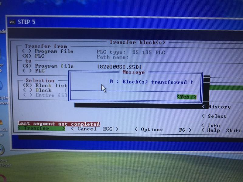

I started the day intending to lower the baud rate on the STEP5 to 820T controller link, to try and resolve this locking up issue.
820T end no issues, parameters 5011 & 5013 set to 11000110 equating to 4800 baud, all else unchanged.
At the PC end however something very odd is happening. I set up the COM2: using MODE in a dos box, then hop into STEP5, which refuses to go 'on line'. Back to the DOS box only to find that COM2: has reverted to 9600 but at 7 data 1 stop. Device manager shows the correct setting. Now as I understand it there can really only be three things changing the port settings:
1/ Me using the MODE command
2/ Device Manager
3/ STEP5 perhaps using a configuration file that I've not yet discovered
But the really odd thing is, if I revert back to 9600, No Parity, 8 data 2 stop everything works, STEP5 goes on line to the 820T controller and when I come out of STEP5 the com port is still as I set it.
Not managed to resolve that conundrum yet  :scratch:
So per force continuing at 9600 I discovered that I can display a directory of all the blocks in the PLC. If I try to download PB202, which is the first, and biggest block, (and the only program block in fact), the interface locks up as it did when I told it to download 'all blocks'. If I tell it to down load the next listed block FB11 I get I get an error 'last segment not completed', but every other block I have managed to download to the local file and can open them for display and editing. However there is not much meat in them, I think the action is mainly happening in the elusive PB202.
Now when the interface locks up, I can only stop STEP5 running by using Task Manager to terminate it, and doing so brings down the whole operating system requiring a re-boot of Windows XP-Professional. However looking at Task Manger I notice that there is a service "IASTORDATAMGRSVC.EXE" that seems to be using 100% of CPU time.
Googling about I find that this service is not part of Windows but is part of "Intel(R) Rapid Storage Technology" and apparently isn't needed, but if I try to uninstall it using 'Programs and Features' in Control Panel I get my hand slapped telling me that it's controlling my hard disk and if I do I'll loose data and won't be able to re-boot  :bang:
. . . oh what fun . . . .

« Reply #466 on: October 13, 2018, 06:13:17 AM »
So somehow the download is writing to disk in a way that the controller doesn't like..
Did you work out how to control the download location?
If so. Try either writing to a separate disk (usb?) or even, assuming it's still possible, a ram disk.
Is @@ valid? I think it wasn't in some file systems.
Russ

Did you get your analyser running? I must I'd be surprised if you were getting flow controlled at that speed.
It could be a corrupt block on the controller as you suggest.
That would mean step 5 hangs waiting for more data that never comes.
Re com settings, I agree with your analyis that step 5 is setting it. I'd search the entire installation for 9600 and see if it is a config somewhere.

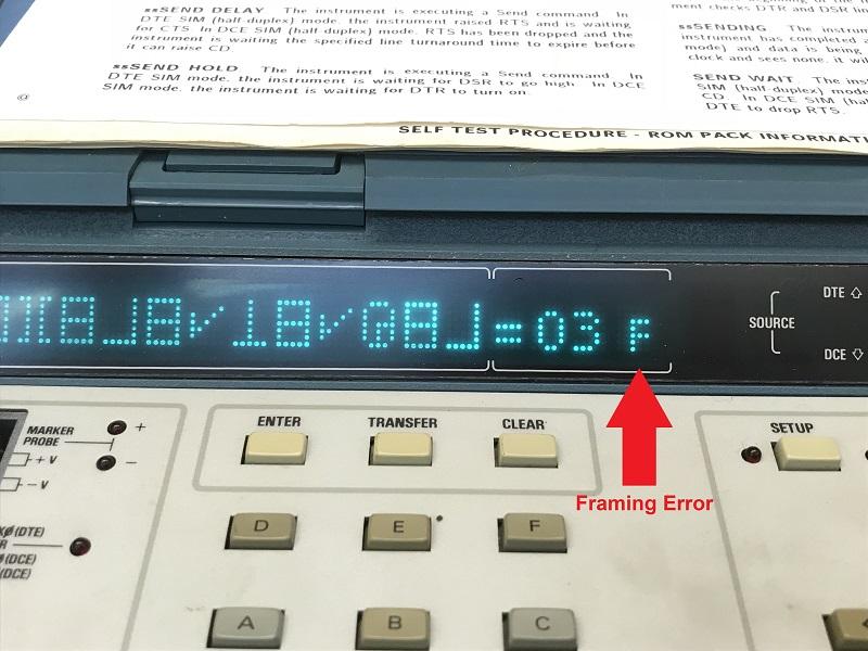

Thanks for the link Moray, but I think it might complicate things even more than they are. I only have access to signals at the RS232 +/- 12 range so at the very least I'd need to build a simple level shifter for each CCIT circuit.
Having just now hooked up the Tektronix 834 RS232 analyser I've realised that it is actually reporting 'Framing Errors' on quite a few (but not all) characters in both directions ie from both the STEP5 PC (DCE) and the 820T (DTE).
Now this may well be a red herring, as of course we have also got the set up on the 834 analyser as  well as both ends of the link which have to match. Theoretically they all do match !
. . . but I've been driven out of the workshop again by a plague of flies  :bugeye: - this time far fewer than before and hopefully just the 'tail end charlies' of the last batch but I can't concentrate when they literally drop down the back of my neck into my shirt !

I never realised this was running at full 12V signal levels.
If you did rig up a basic level shifter, it would mean you could see exactly what's going on with the signal timing, which may reveal what's causing problems.
