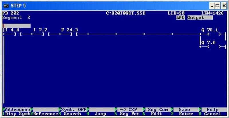

Aaah, I see! Very clever  :smart:
Although one immediately wonders what would happen if bits 47.1 and 47.2 were both set to true! (a real RS flipflop would output 0...)
I can see why you want a printout of the whole thing, it must be a bear trying to trace it all one logic unit at a time... It will be interesting to see if the Mazak has something similar (I guess it will).

« Reply #502 on: October 22, 2018, 03:38:22 AM »
But the one in Andrew's screen shot looks like an SR not an RS so Set will take priority over Re-set as this rung is evaluated.

« Reply #509 on: October 22, 2018, 09:02:51 AM »
That does not look too bad...Only it is ladder and I am more used to FUP. Some statement lists the but I did not spot any assembler.
If I remember right in S5 lingo S-R has reser overriding and R-S has set overriding. Modicon and Telemeganique had it it opposite - or A-B! Anyway, I had to check every time I changed my "language".
S5 has interesting timers, to convert S5 to Modicon had to make some extra logic to accommondate some of the timers used in S5, but not suported in Modicon.
First you need to check the offending outputs on harware, crossreference where outputs are set (only once in the program or someone has ****** up) and there you find the segmet it is set. Backtrack from there.
Commenting few segments and most inputs/outputs is a half a battle, figuring out the flags (typically exceptions like E-stop, Low hydraulic pressure, alarms, permits or states like "run" or "pause" or "jog" takes a little more tennacity.
But you are the man!

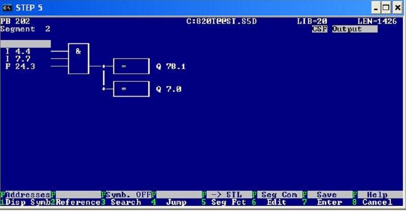

Thanks Pekka, not come across FUB but I do know LOTS about FUD or Fear Uncertainty and Doubt  :clap:
I can display the PLC program as CSF, LAD or STL
CSF - Control System Flowchart
LAD - Ladder
STL - Statement List
But I suppose not all constructions are possible to display in some formats hence interspersed statement lists. Here is an example of SEG-2 in all three formats
Incidentally that I4.4 is eSTOP, I7.7 is 24 volts OK, Q 7.0 is a spare output, but I have as yet no idea what F 24.3 is except that it's an internal flag bit, or what Q78.1 is, again it's an internally used output from the range it sits in.
Perhaps I should explain I's are inputs F's are flags (temporary one bit memory) and Q's are outputs.  So Q 1.2 is output word 1 bit 2 for instance which would be 'select low gear on this lathe.
( all this is me trying to familiarise myself with what I'm working with - sorry if I'm boring you all  :scratch: )

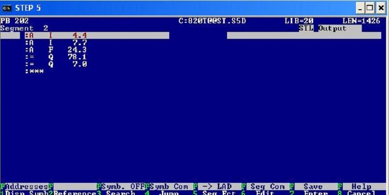

« Reply #511 on: October 22, 2018, 09:54:13 AM »
So continuing on the theme of self education, and boring the pants off you, segment 1 translates as follows:
Segment 1
:STL
:L KH 0202        Load Hexadecimal 0202 into Accumulator 1-L
:T FW 121           Transfer contents of Accumulator 1-L into Flag Word 121 bits 8-15 to byte n, bits 0-7 to byte n+1
:L KH 0020        Load Hexadecimal 0020 into Accumulator 1-L
:T FW 119           Transfer contents of Accumulator 1-L into Flag Word 119 bits 8-15 to byte n, bits 0-7 to byte n+1
Which can only be represented as a statement list, as flowchart or ladder are not appropriate

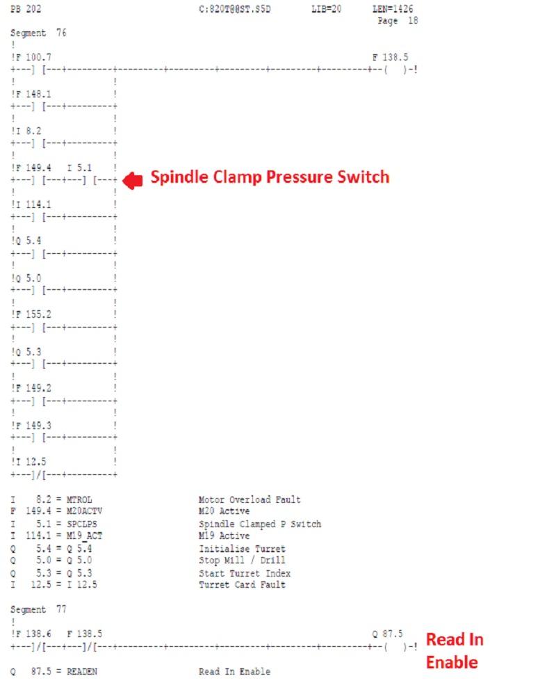

  • Posts: 9152
« Reply #523 on: October 26, 2018, 05:35:41 AM »
No activity yesterday other than printing out my latest cross reference list, as a reunion with friends in Littlehampton was the order of the day - early departure and late return.
However four hours of thinking time on the journey got me to a diagnostic method that I applied this morning. Now that I have the entire PLC program on paper, and can inspect inputs, outputs and flags using the inbuilt facility in real time I can trace what is happening.
So the problem is, that issuing an M20 ('Enable Spindle Drive') command that is the preparation for M19 'Spindle Orientation' the M20 is entered but then locks the control by not asserting the 'Read In Enable' line, so the control is freezing and not reading the next command. However the bits are set in the flag words that the spindle is indeed enabled by the M20.
Now having the PLC ladder in front of me like a circuit diagram, I can go through the logic that asserts 'Read In Enable', which is segment 77 that is a simple dependency on both F 136.6 and F 138.5 being False (or 0). This showed me that F 138.5 was the problem being at a '1'
The previous 'Segment 76' produces the flag bit F 138.5 from a twelve input structure requiring all it's inputs to be '0' (apart from one where the logic is inverted for 'Turret Card Fault') and the failing input was traced to the third input element being F 149.4 (M20 Active) in series with I 5.1 (Spindle Clamp Pressure Switch)
Well guess what - although the spindle clamps OK with an M31 and unclamps OK with an M32 the input on I 5.1 is the inverse of what I would have expected, with a '1' for unclamped and a '0' for clamped.
How could this possibly happen  :scratch: Well think back to the end of July, when I got all enthusiastic replacing the solenoid and pressure switch sockets as the old ones had perished - I couldn't possibly have wired it wrongly could I - oh yes I could  :palm:
So a quick wire move from the NC to the NO terminal, and guess what - the M20 command now completes as it should and the following M19 command is read in  :ddb:
However I'm not out of the woods yet, as the M19 keeps the 'Run' light on and doesn't orientate the spindle but just sits there glowing  :bang:
OK never mind, this IS actually major progress as now I can hopefully trace out what is happening just as you might with the equivalent physical relay circuit and a multi-meter.
Not every item in the PLC ladder is yet named, and probably never will be, but this method will let me concentrate on the area with the issue rather than having a scatter gun approach
