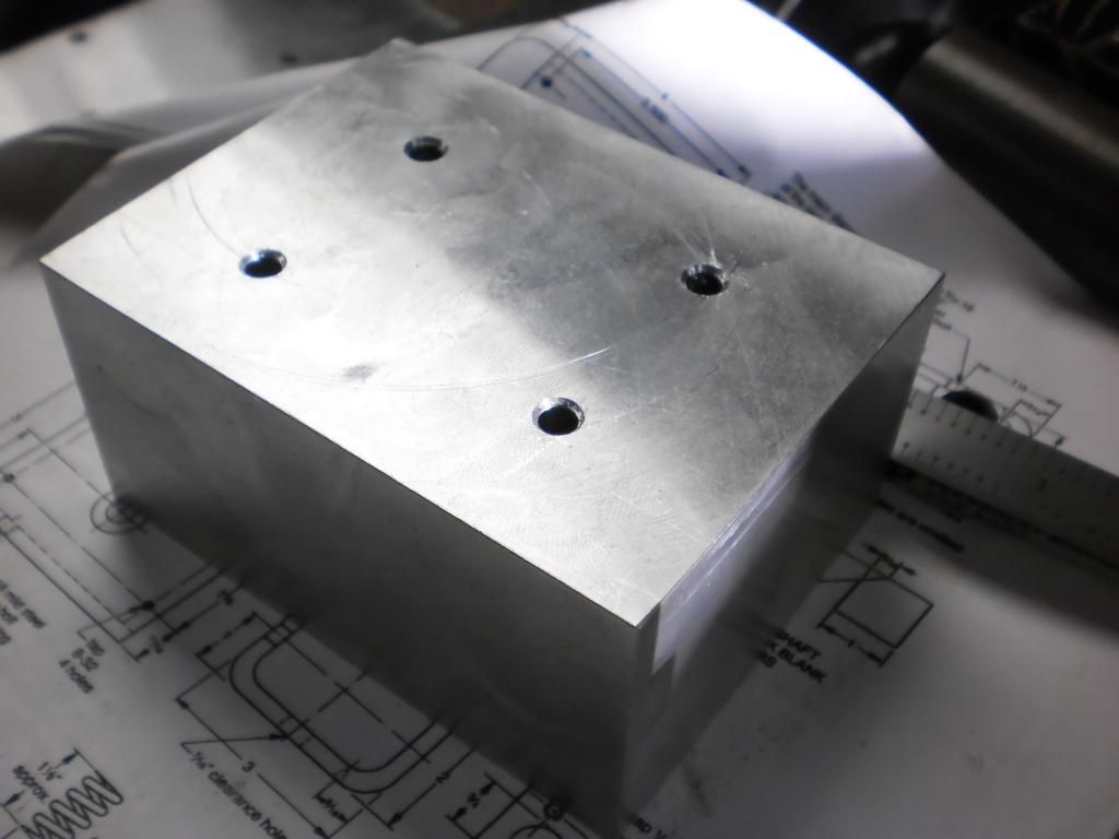

Ok first block squared up to size.

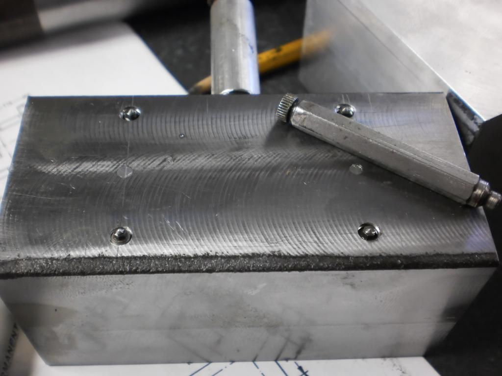

put in transfer screws in housing block to transfer hole pattern to the top mount block.
holes drilled and counter bored from back side.

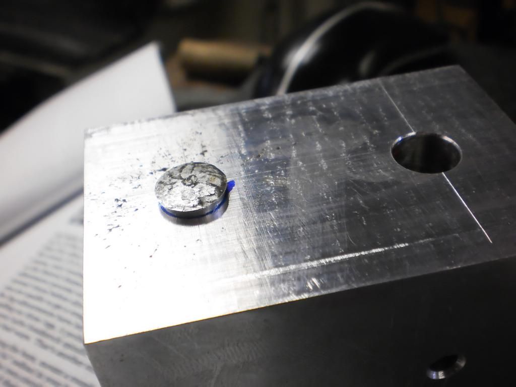

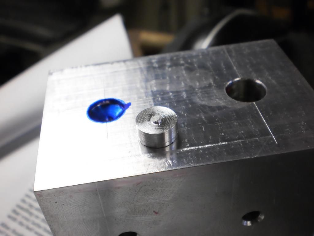

Things were going good until oops I started to drill the hole for the finger mount and was on the wrong side darn! Now I have a scar so I went to work to fix it. turned up a little plug fro some scrap.
Put plug in place and peened it over good.
After I milled down the repair it was not to noticeable.

Well I have the top mount block near completed put the bushing holes in set the heights and put the spring pocket in only thing left is a hardened slug for the cam pin to push against
Setting height of the 2 balls unit will swivel on.
Spring pocket done.

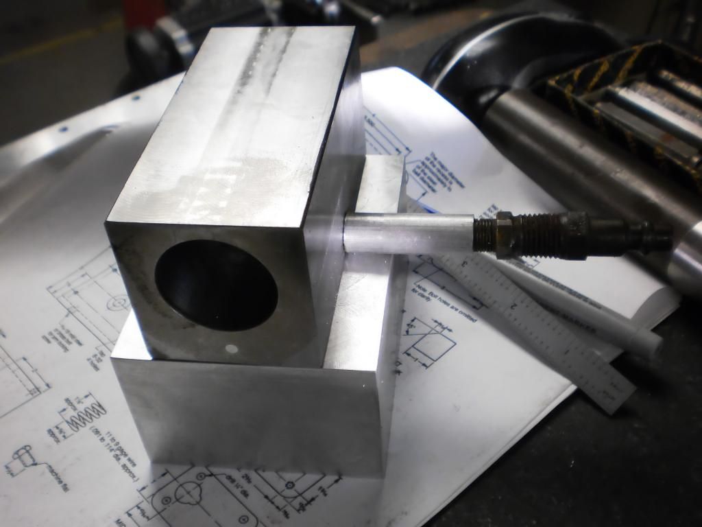

« Reply #17 on: November 28, 2013, 10:39:24 AM »
Ok got an early start before turkey time  :beer: and got the holes put in the bottom block for the bushings and the cam pin and also the cam leaver hole.
Setting the bushing heights.
Here I'm transferring spring hole from top block to bottom with transfer punch.
