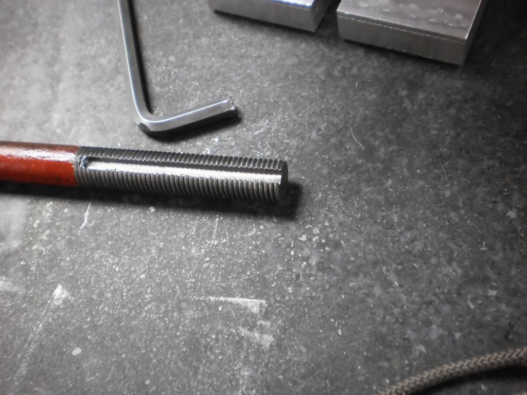

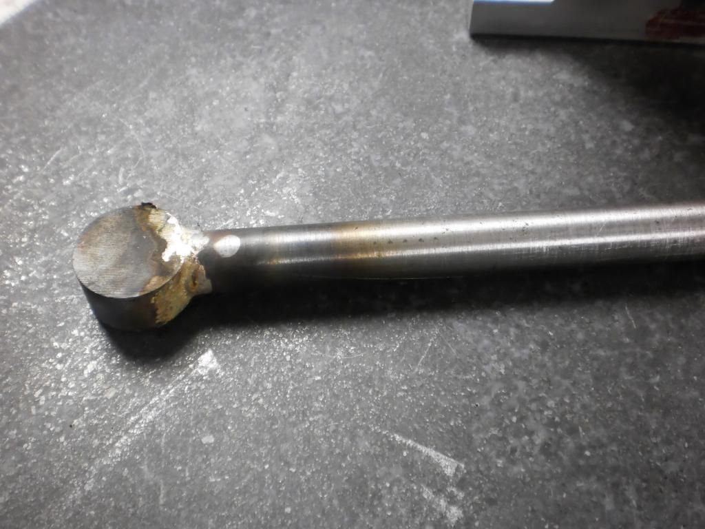

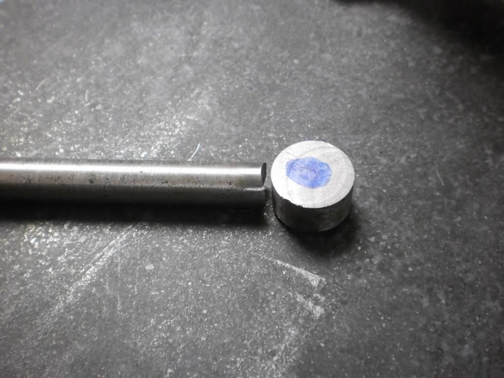

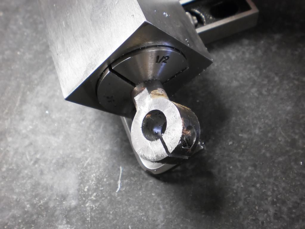

Ok I started with a length of 1/2 dia stock and a short plug of 7/8 dia. The short plug will be silver soldered to end of 1/2 dia shaft.
soldered up
square up in 5c collet bloc to mill width and drill and ream 7/16 dia hole.
spot face, drill and tap cleaves clamp hole. Then band saw slot and open up clearance hole down to the slot.
Cut a piece of 7/16 dia stock and another piece of 7/8 for end again.  same as last one only no cleaves clamp screw hole and no slot this time.
soldered up ready to mill width and drill hole square up in 5 c collet block again.

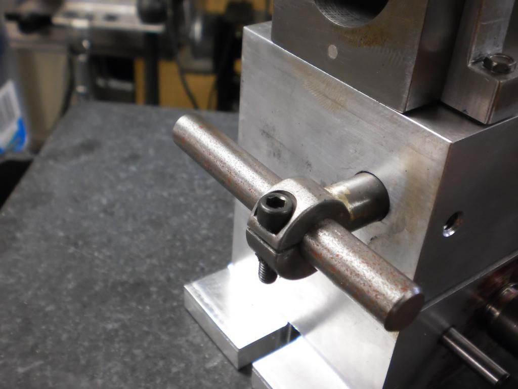

Ok another piece of 7/16 dia stock turn 7/16-20 thread mount in 5c collet block and mill keyway.

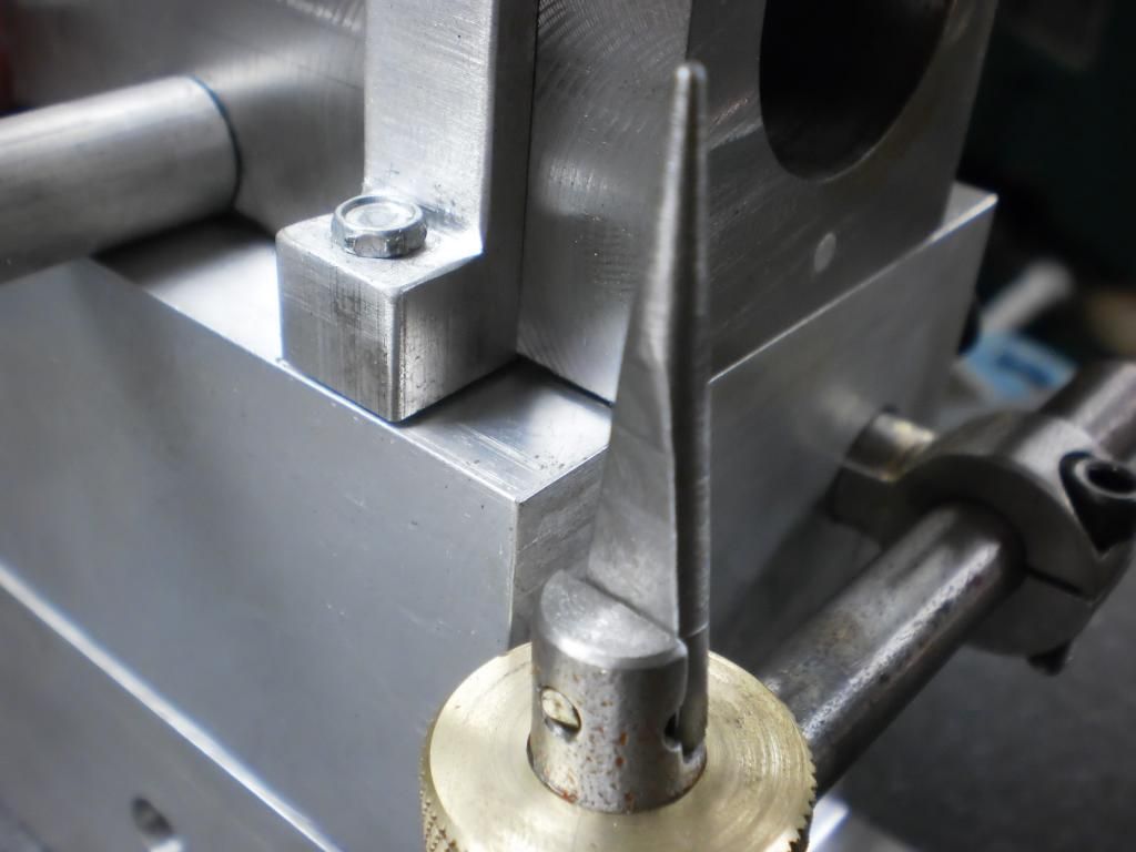

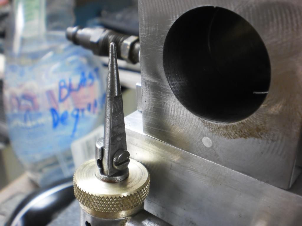

ok milled step in opp end and drill ant tap hole to mount finger. Turned up and knurled a brass thumb nut .
And here the finger mounted I started with s piece of 1018 steel didn't have a piece of 3/8 dia tool steel so I heat treated the end by heating to red the plunge into some sugar then heat to bright red again and quench in water it did turn out hard a file wont cut it now anyway the sugar definitely added carbon like it was suppose to so it worked.
Just a few minor things to do some deburing and it should be ready to go.
George

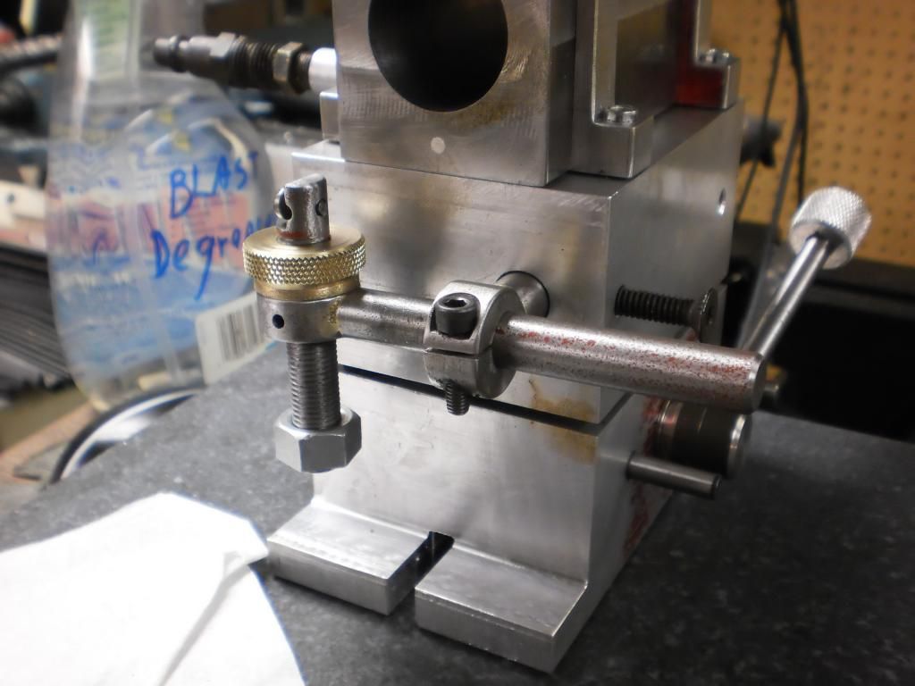

The spindle that goes into it holds an end mill and the spindle floats on air so you can move it back and forth friction less, the finger is set to guide the flutes of the end mill as it is sharpened. The leaver tilts the whole spindle and finger set up into the grinding wheel for grinding then away from grinding wheel to index end mill to next flute.
Then when to flip the leaver back to grind position it moves back into wheel to the exact grind position for grinding the next flute.

I recorded a short video showing how well it floats on air and it uses minimal air. It will start to float at about 15 psi and will float really well at 20psi. If I give her a good spin she will set and spin for long time.
  I started making some brackets to mount a motor and grinding wheel on the mill spindle like in the book but I don't plan on doing that permanently as I don't like the idea of getting grit on the ways of the mill.

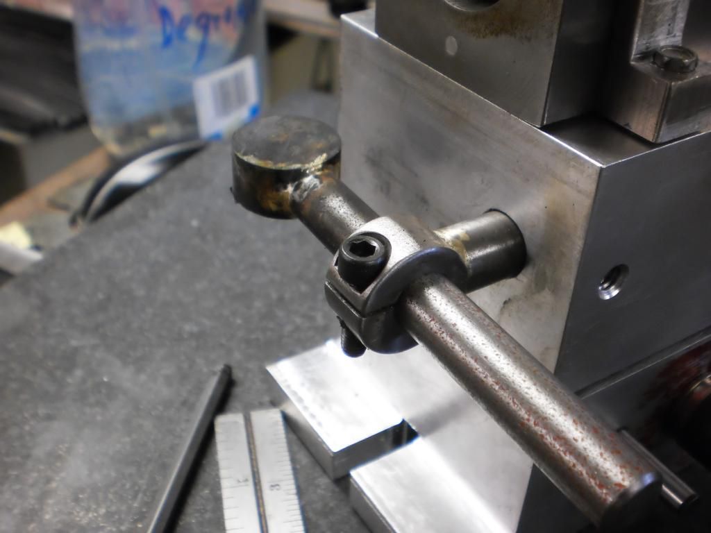

Now remember this is just a temp set up until I make up some cross slides and a spindle made up for the grinder.
Grabbed a piece of channel and mounted a 60degree wedge on the end and a push block to clamp to the mill ram.
mounted on mill ram
motor mounted on machine.
Ok now I need to dress wheel and set the proper height for the 5degree primary relief angle. Which is explained in the book pretty well on setting it up. Basically set a protractor to 5 degrees and set the point of contact with wheel to the center line height of the floating tool holder. So I need to get the center line height of the tool holder.
With that I took dinner break and after I post this will head back out.

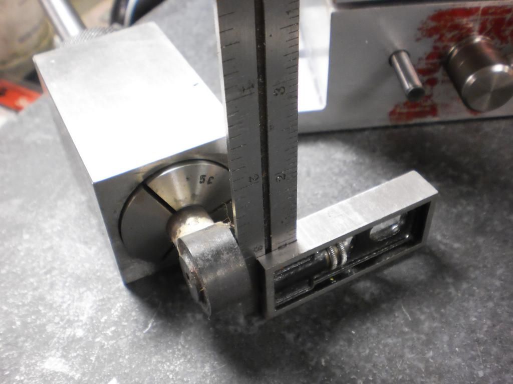

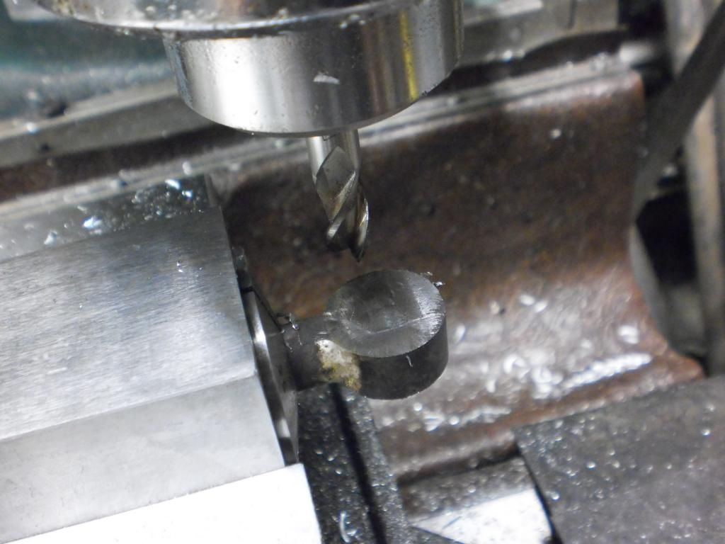

Ok set the protractor to 5 degrees and scribed the tool holder center line height on protractor blade.
Then placed on table and set wheel height to where the point on contact lines up with scribe line.
set up and ready to give her a try. Taped old shopping bags to keep dust off machine.
I know its hard to see but this was just a primary grind and I tested the end mill on my NC mill after sharpening and was pleasantly surprised it cut like a new one.
This one I did the secondary grind and the primary grind and it to cut like a new end mill.
