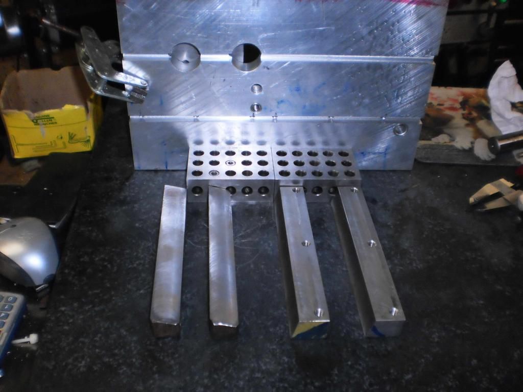

Ok I set up and cut a set of slides the adjustable sides will be made of aluminum and have brass slide inserts.
Done drilling and tapping the mounting holes.
Have I told you all I love this little devise wish back in the day when I was out in the tooling shop these existed.
Cuts down a lot of setting up a sign plate to set up the angles.
Done and ready to mount and dowel to the table.
I've got most of it laid out in cad now. I need to order some acme threaded rod and some nuts for the y axis travel the x will be moved by lever and linkage.
George

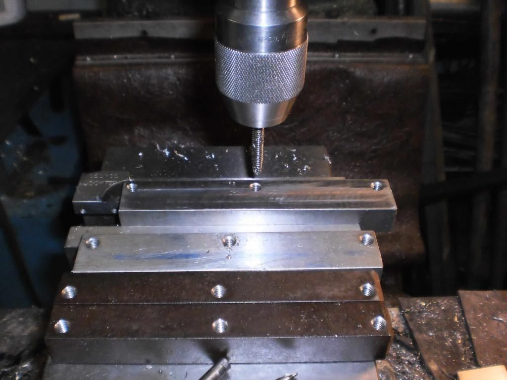

Ok I got a little distracted  :lol: seems my wife seen these seem to be square gears on U Tube and thought I  should make a set for my father-in-law for fathers day. Well I thought what the heck I'll set up the NC mill and cut a set out and here is what I got. I cut them out of some old lexan I had laying around. I'm going to get some wood grain contact paper and cover them.
Ok enough of that, I drilled and tapped the gib tightening holes and re trammed the mill head so now the dove tail blocks are ready to mount to table bottom.
Flipped and spot face back side.
I'll lock the gib set screws with a set of set screw lock jam screws.
These should work.
George
