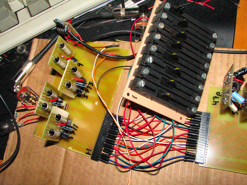

Test setup with slide pots:
  [ This attachment cannot be displayed inline in 'Print Page' view ]
Although the pots are logarithmic(audio), they already feel a lot more natural, when adjusting the waveform. Almost like kind of an audio mixer. But instead, they adjust steps of the waveform. If it was an audio mixer, log pots should be perfect for it.
But is it(an audio mixer), as its output is audible, but the signal is made of dc voltage? Beats me, as there are plenty of different elements in project like this, of which I can't make any sense at all.
So after all, linear slide pots would be a better option for a visual reference of the waveform, and I'll probably order some in the future.

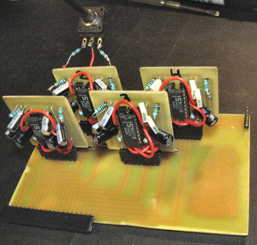

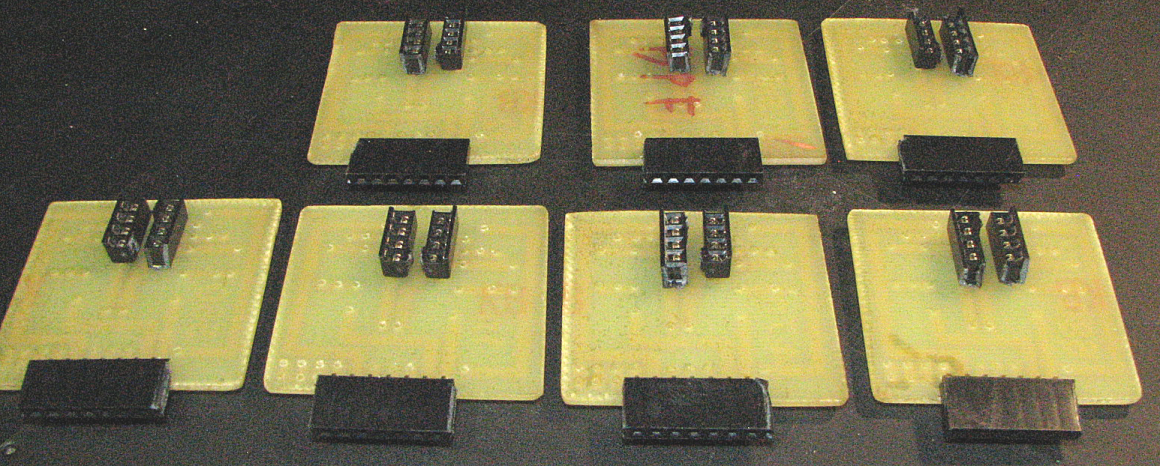

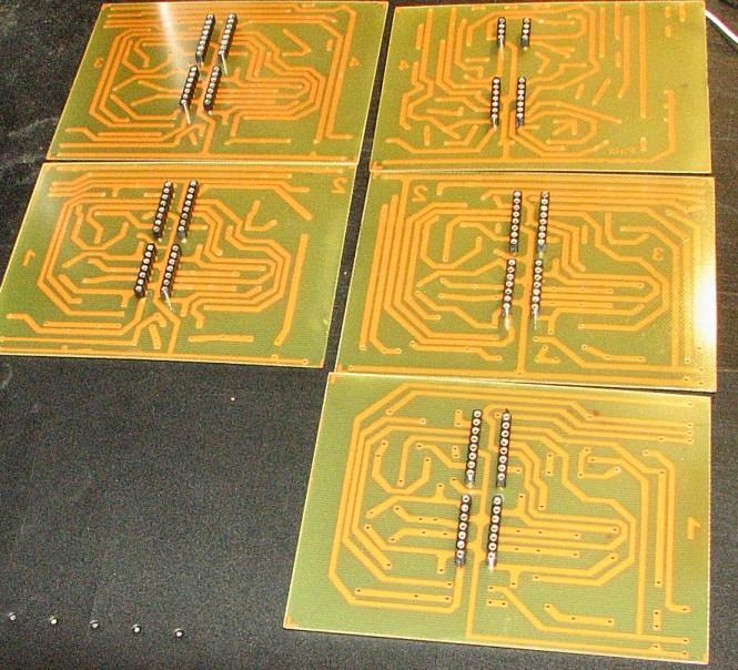

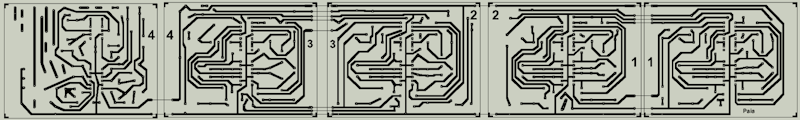

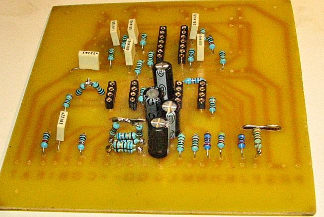

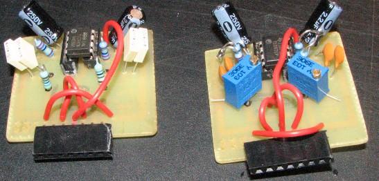

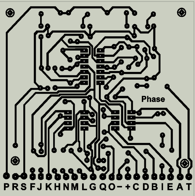

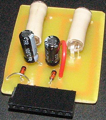

Almost finished new board for frequency multiplier 4046-4017 and waveform generator 4040-4051:
I used headers for the parts, that adjust the capture range of the 4046, so they can be changed, if needed. Longer headers on the left are for slider pot connections(and also for future testings with something like ldr's).
Sometimes I wonder, why on cmos counter chips(like ones used here), the outputs are in awkward order. Should need hair-thin pcb traces to get them all to the same side in order, and even then, some of them cross each other.
On the other hand, that shouldn't be a problem, if one was able to make two-sided pcb's. I have some in my shelf, but haven't yet got that far, to start testing different methods/techniques.
Could very well be worth it, because I just hate using many jumper wires for a pcb, like above. Lots of room for stupid mistakes.

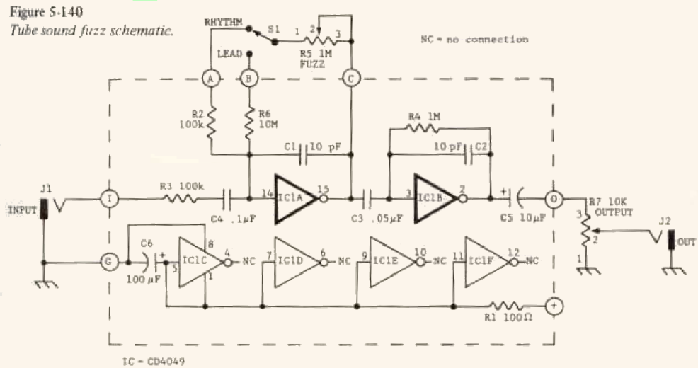

- to make 4049(Hex Inverting Buffer) -based fuzz unit(s). Let's be honest, certain kind of distortion adds plenty of texture to the overall soundscape, if desired.
What I mean by certain kind of distortion is, that 4049-chip, when configured as a linear amplifier, clips the input signal gently, very much like tube amps do.
It must be one of the few of the logic chips, if not the only one, that can be (ab)used that way. As far as I know, one of the first ones to notice that, was Graig Anderton(author of still excellent book Electronic Projects For Musicians), back in the seventies.
So no wonder, that it's used in some of the commercial "tube sound" effect pedals.
- to add some kind of (possibly modulable/envelope) filters for the outputs

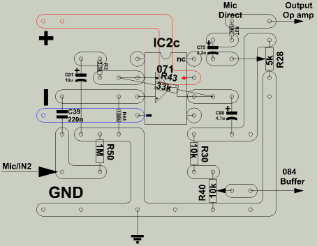

Current circuitry had one stubborn bug in it, but finally I managed to stomp it out without using bug spray(http://emoticons4u.com/crazy/061.gif)
Circuit with correction in red:
Now it works, as it should. 1M pot on the right side will probably replace the 100k resistor, to make 4046's tracking speed adjustable. That together with 100n capacitor(can be anything from say, 10n to 10uF) provides the "timing" for it.

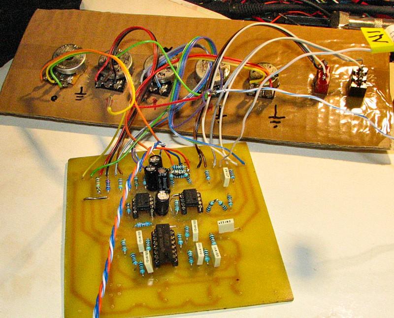

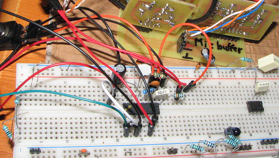

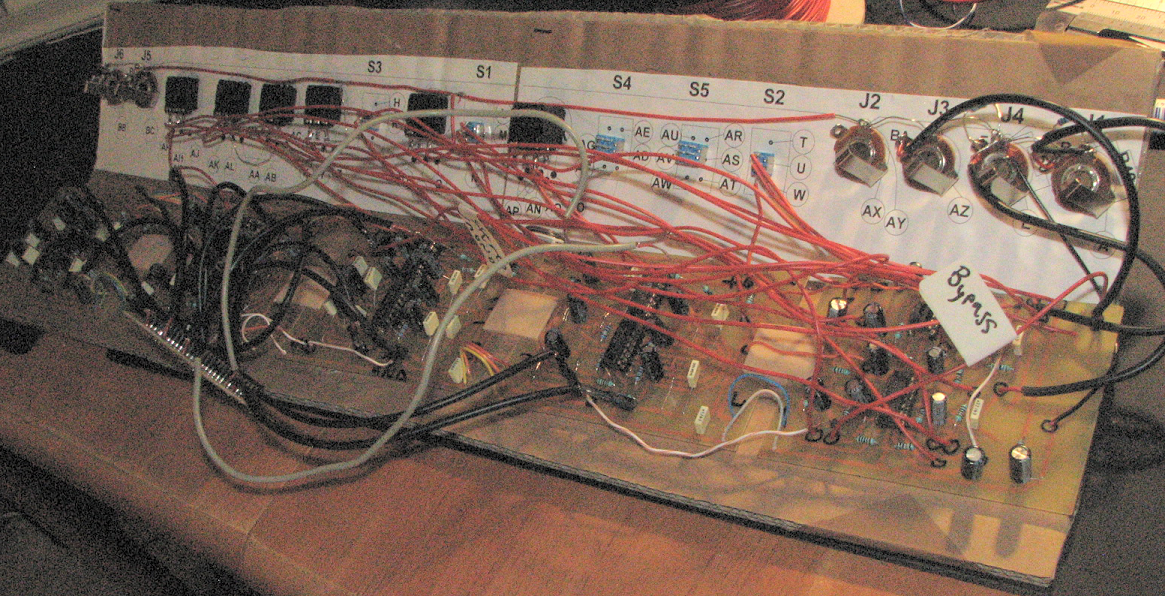

Circuitry with linear slide pots:
It has a skeleton 'enclosure', as I'm not yet sure about possible additions. 1M pot on the left is for 4046's tracking speed, but it needs one of the timing capacitors to be  "variable" also. It needs to be tested, which cap values are most usable, though. Then rotary switch to select between them.
This current circuitry's output should be made ready to be fed to more than one devices, like mixer, filters, or echo/delay simultaneously. So It might need a buffer/splitter for its output. There is a project 26, 'Spluffer' in the Craig Anderton's book, which does exactly that.
Once I get the mixer together, then could be a time for a bit of break in building, and trying to figure out, how the hex pickup setup works/sounds with this circuitry, that is monophonic after all, meaning, that it should handle single notes(like on single string) just fine, in the range of 80-300Hz, with current 4046 configuration.
So it should be good to use with thickest string(e) output to accompany other strings. But we'll see, how that turns out in practice, as there are already many(so far uncertain) factors involved.

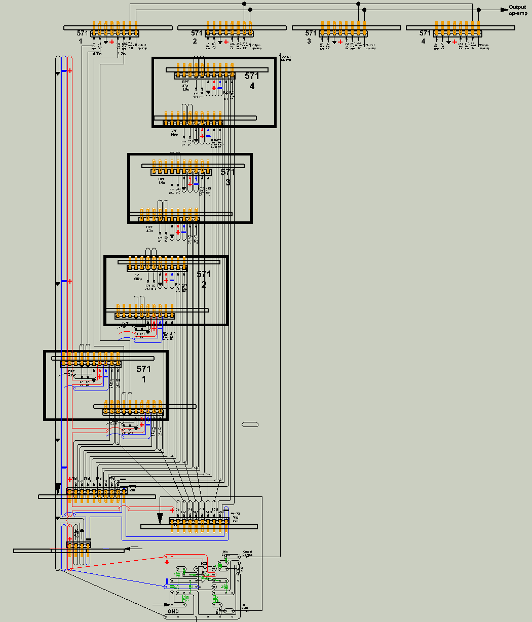

The 8-channel vocoder, that I mentioned earlier, I found stuff about it on my hard drive. What makes it better, is that it's so much simpler, than any other ones that I've checked so far.
I'm going to draw the pcb using this image, as I haven't found any better images of it:
Length of that pcb is about 430mm. Too big for me to make, so I'll divide it to 3 or 4 parts.

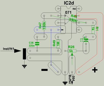

The vocoder pcb almost redrawn:
It has some tight spots, that needs to be taken care of, though.
I'm redrawing the component designators also, as the image is too blurred to be (possibly)transferred to the component side of the pcb(haven't done that before, but well see):

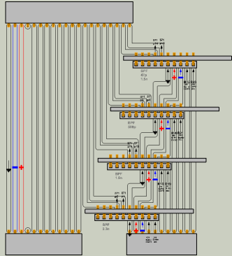

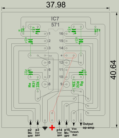

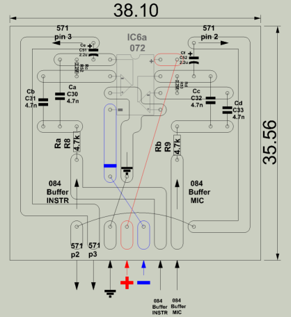

Divided vocoder pcb:
I decided to use 75 x 100mm pcb's as they are already available in that size. Cutting the pcb is something, that I've never managed to do properly.
On the other hand, I have only used 1,6mm boards, and have scored them to get cleaner results, but they seem to be too thick for that, and the edges tear. Maybe 0,8mm ones, which I'm going to order next, are more suitable for the 'score and snap'.

When looking inside of that previously mentioned ex-tape recorder enclosure, there was dust and a phase shifter:
I doubt, if it's still in working order, after two decades, due to corrosion of the pcb traces. As can be seen, two ic's are configured to substitute original op-amps(super-rare 4739's). White blocks are diy optoisolators(led/ldr), to replace original Clairex CLM6000's(that were probably never available outside US, but what do I know).
Quite a mess, that is worth only for looting socketed ic's, pots and switches.
I'm considering of rebuilding that, but what comes to optoisolators, they need some fiddling(when using ordinary leds and ldr's) to get them to the 'working range'.
Or just re-use the components inside white blocks, and look, what kind of mods I did use back then, to get them to work.

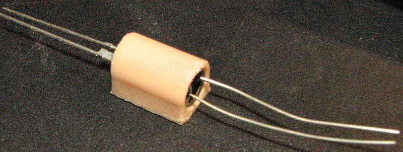

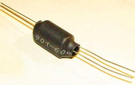

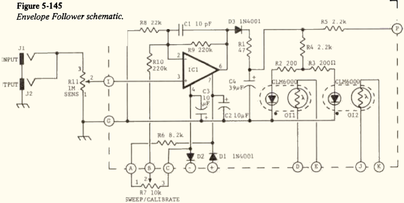

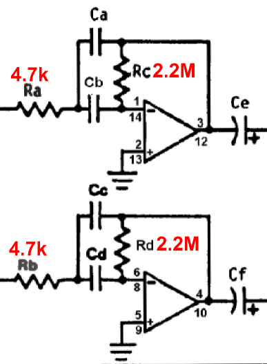

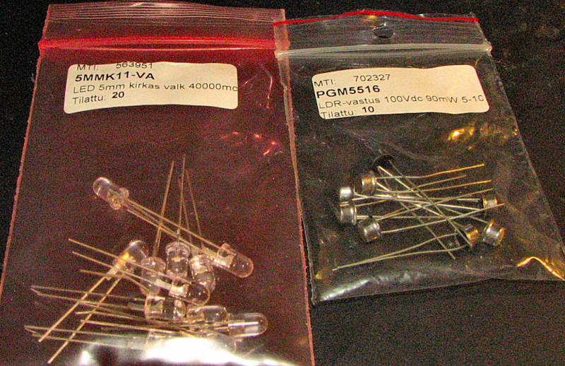

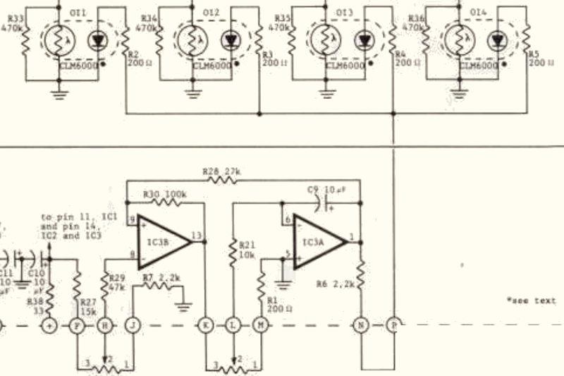

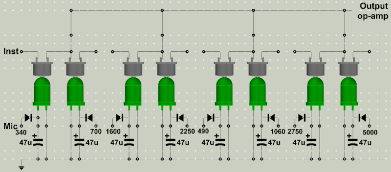

Seadog, yes quite a price for single led/ldr -pair. One way, at a fraction of the cost, is to make ones using a heat shrinking tube.
If memory serves, it wasn't that difficult to get ordinary led/ldr pairs to work, as required in that phase shifter. In schematic, there is a 470k resistor in parallel with ldr, and 200 ohms current limiting one in series with led. The circuit itself:
Playing with those two resistor values should do the trick. Nowadays the leds are much more brighter(and/or efficient?), so they need to be tamed down, to fit for the rest of the circuitry.
Ldr's responses (could) vary between maker/model, so some tinkering with them also, I guess.
More about that, when I get to building the actual device.

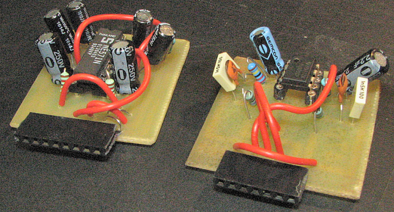

Ordered parts came today, so I managed to finish the 15V split power supply circuitry. I also did the previously mentioned ac-mod for the 15V dc wall wart.
I'll have to admit, that I got a bit nervous, when testing those out. I had already a box of fuses, and some other measures of precaution, just in case, that something goes horribly wrong.
But it went well, and they work nicely together. Fortunately there are very rare occasions, where I have to do projects like that.

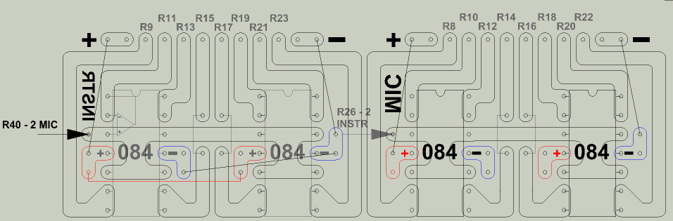

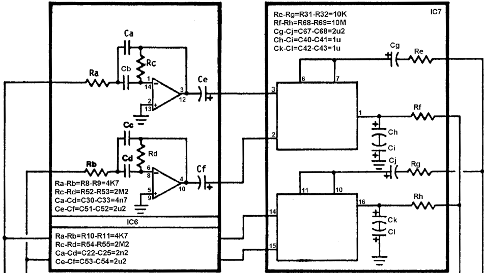

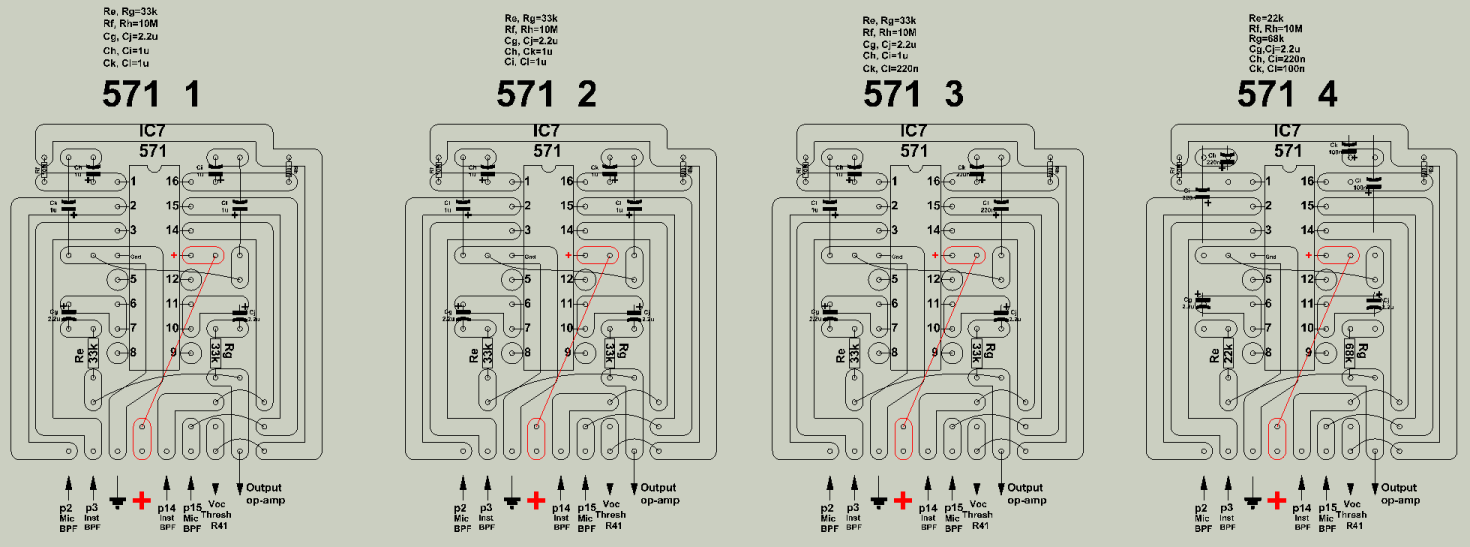

The pcb for the vocoder needs thorough cross-checking, using the schematic(down-sized to fit for the page):
Luckily most of it is repeated 'blocks', like op-amp and compander sections in the middle. Only the component values vary between them. But still, tedious task to do, so I'm expecting to take a break of it at some point, and do something else, like building the phase shifter.
What comes to the previously mentioned audio recording interface, there seems to be a lot of those usb-based soundcards.
Without knowing too much about them, something like Behringer U-Phoria UMC22 could do the job for 39 euros, but it's currently out of stock on local supplier:

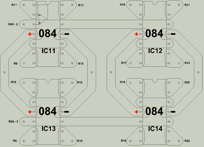

Post by: sorveltaja on April 19, 2020, 08:38:47 PM
Cross-checking that vocoder pcb is indeed very slow thing to do. I had to restart from the beginning a few times, to find better ways to approach it, and perhaps learn something in the way.
So far I've found several missing traces, and errors, when compared to previously drawed one, using that blurry image.
But after all, no matter how long it takes, I guess it could be worth the effort. If not, there are always plenty of other vocoders to choose from.
In the meantime, I have also had some ideas, like making the filter sections 'variable', using headers for their capacitors. Originally the cap values are for 200, 400, 600, 950, 1300, 2200, 3000, and 4900 Hz. But we'll see, once I get there.

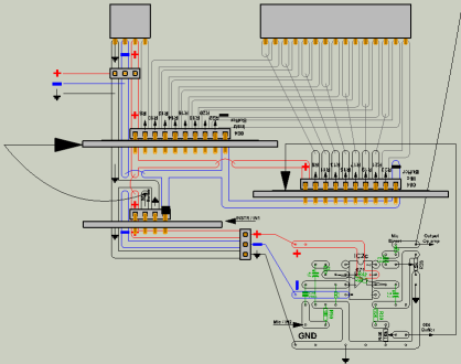

Post by: sorveltaja on April 20, 2020, 05:24:02 PM

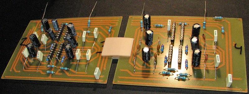

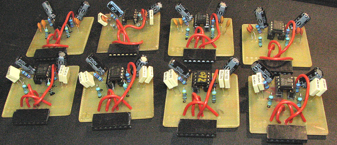

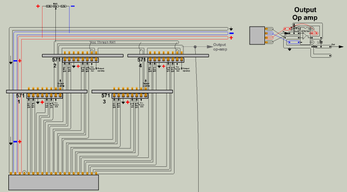

Oh boy, what a job to do! Time flies, when you're having fun(or so they say). Now the vocoder pcb should match the schematic:
Next step is to verify, how well they match... only one way to find that out. Yes, by building it.
But now it's good time to take a break of it, although some traces perhaps need to be beefed up. For now, I'll leave it there.

That is the updated version of the original pcb, found at http://www.generalguitargadgets.com/effects-projects/extras/epfm-book/
Then salvaging all the reusable parts from the old phase shifter, printing 'housings' for led/ldr -pairs, and so on.
Title: Re: Extending the soundscape of a hexaphonic guitar pickup
Post by: sorveltaja on April 21, 2020, 06:20:06 PM
The phase shifter pcb is finally in etching bath. It took 6 or 7 times, to get all the traces to transfer. Usually it works right away, but this is a bit bigger pcb(100 x 93mm), than most ones, that I have previously made.
As I use flat iron, as a part of transfer, it just needed more heat and pressure to be distributed, than smaller ones. Fingers crossed, that the traces stand one more time the heat, when soldering, as I already roasted that pcb so many times.
Anyways, once it seemed good to go, I dropped it in etching bath, and only then noticed, that the trace pattern was mirrored(http://emoticons4u.com/crazy/1261.gif).
That is one bugger of a trap, where I fall every now and then. But yes, it was (again) one of those moments of "Play it again Sam, one more time, but please, not backwards this time".
Post by: sorveltaja on April 22, 2020, 06:28:26 PM
^^Just like that :D
But yeah, holes for the phase shifter pcb are now drilled. There are some fractures in only few traces, that needs to be checked, if they need to be patched, though.
Vocoder pcb images are also ready for transfer. Should make a good practicing on that size(100 x 75mm), as there are five of them.

Post by: sorveltaja on April 23, 2020, 08:27:39 PM
The phase shifter board with almost all components:
IC's, some switches, and pots are to be added. Optoisolators need to be made, and the resistors parallel with ldr's, and resistors in series with leds need also be tested, and modified, if needed.

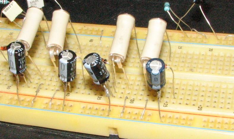

Not much progress today, except making first optoisolator for testing. Components used:
The leds are white, very bright(actually painfully bright, once they get some 'juice') ones. Ldr's are 'hermetically' sealed ones. There is no specific reason, why I chose to use those exact components.
They are just a part of the optical component stock, that I gathered back in the early phase of the 'optical hex pickup' -project.
Printed enclosure for the led and ldr:
They are secured in place with few drops of super glue. Then some heat shrink tube to keep the ambient light out:
Both ends need to be sealed also, using just about anything, that is thick enough, and opaque. As I have some black acrylic paint, that's what it'll be.
What comes to testing that optoisolator with the rest of the circuitry, I think the led part of it should be quite straightforward. There is an adjustable LFO(low frequency oscillator (running at ~0,2 - ~8Hz)) that drives it, and the involved series resistor needs to be adjusted to make the led to pulse so, that it fades completely, when the lfo wave hits the 'bottom'.
At this point, when thinking about it, when the lfo wave hits its highest spot, the leds, that I'm using, should glow very brightly(remember, this circuit was originally published ~40 years ago!), which shouldn't be a problem, unless that led starts to draw excess current. But we'll see.
The ldr -part(having a parallel resistor) is somewhat more difficult to imagine(at least for me), but in the end, it should be about adjusting its response, to fit the range of led's brightness variation.

It seems, that the resistors for led and ldr might not need to be modified that much, if at all. For my surprise, the led already pulses in a way it should do.
So I listened to the output, and there was an audible pulsing effect. It was rather lacking, as I tested the circuitry with only one(of four) optoisolator, and sine/rectangular waves. The lfo and optoisolator -part of the schematic:
As can be seen, there is already a limiting resistor(R6) at the output of the lfo(IC3A), that drives the leds. There is also an option to use an external source for modulating the leds(feeding it to pad P, while pad N is disconnected).

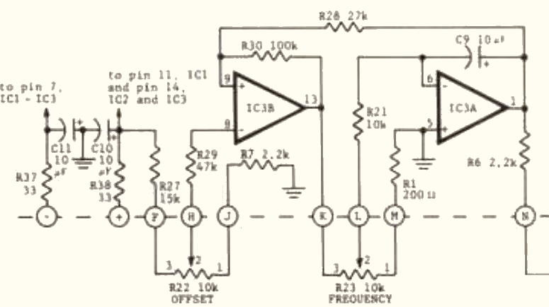

Today I simulated the Lfo part of the schematic, with different values for R27, R7, and R6:
I managed to get quite good results, but when I did the same modification in practice, they didn't work at all, as expected.
My aim was to bring the triangle wave, that IC3A(which modulates the optoisolators leds) makes, between 2,40 - 2,80V, because that's where the effective range seems to be.
I tested with function generator's triangle wave, having 0,40V with 2,40V offset, and that's where it sounded the best, without gaping dead zones.
When doing the mod to the circuitry, it messed the Lfo speed settings also. It's not worth to restore the original resistors, as with them, it was already too quirky. I think it's time to ditch the included Lfo section, and use something, more usable instead.

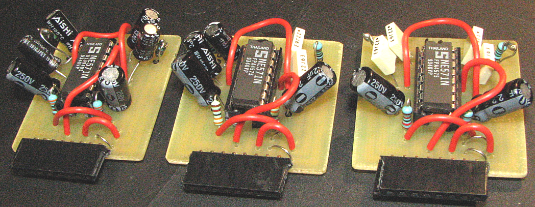

The vocoder pcb's are almost populated:
Between the boards is a two-sided, printed 'clip', that holds them nice and tight together. It could well be a permanent holder(probably needs to be extended on both ends, to have holes for screws).
Also it takes the strain off the to-be-soldered connecting wires, making the boards a lot easier to handle together, when the outboard wiring mayhem hassle begins.
Once all wiring is done, and all goes as expected, plan is to stack two pairs of the boards, to make the whole pcb footprint narrower. When all 5 boards are placed one after another, the cumulative width is just too excessive, being about 550mm.

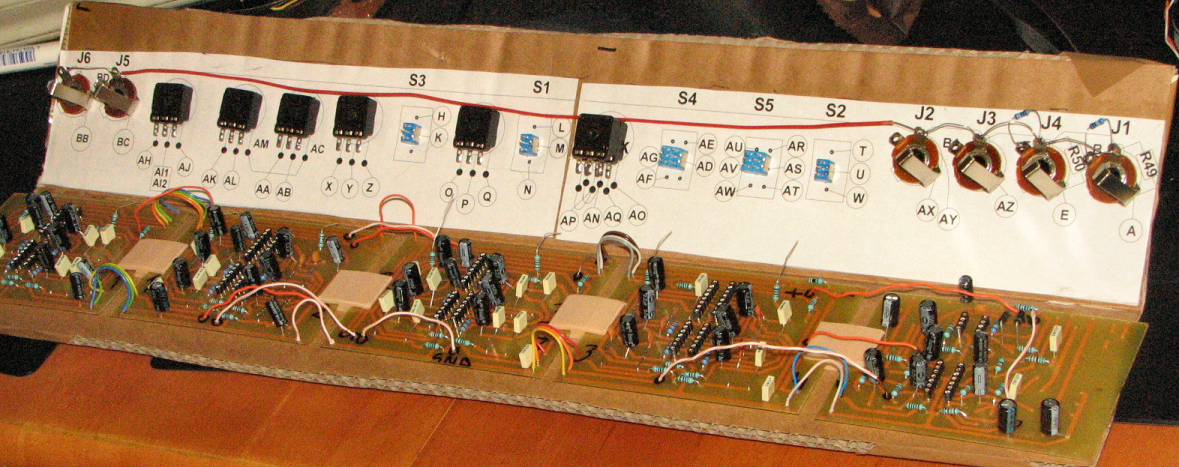

Post by: sorveltaja on July 27, 2020, 08:06:00 PM

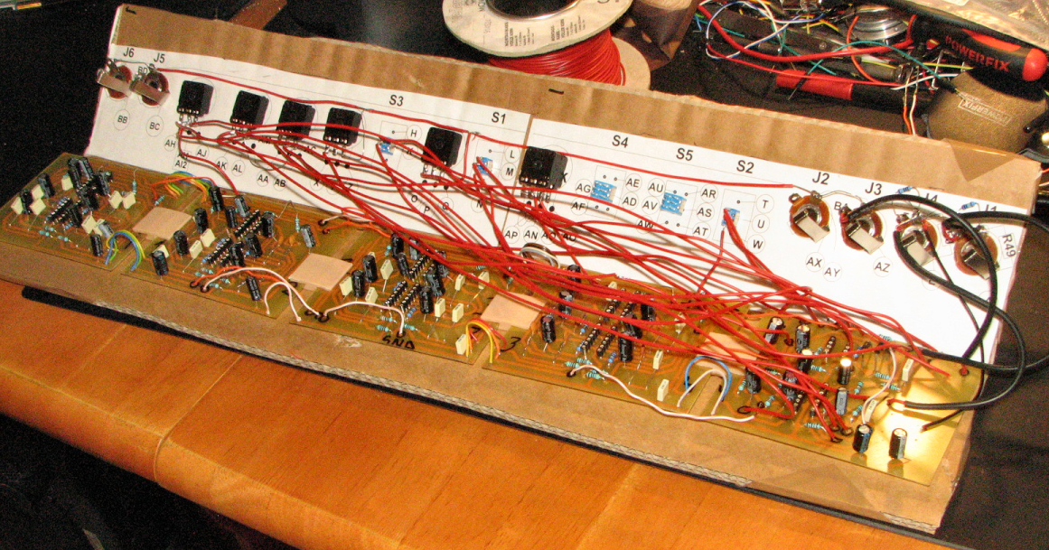

Wiring hassle before and after, using rather hi-tech building platform:
I have omitted some switches and plugs(right channel and effect loop), as they might not be necessary in testing phase. Lots of unshielded wires running around, so we'll see if the noise becomes a problem.
Currently I don't have enough shielded cable for all the wiring, so only audio plug wires are shielded.
Next I'm planning to draw and print some kind of gadget, that makes bending the IC legs hopefully easier. When the IC is new, the legs are usually spread out too much to be pressed to the socket.
Bending and aligning the legs one by one is just pain in the arse to do, especially, if there are more than one IC involved.
After that, I think it could be time press the IC's into the sockets. That is always preferably done only after all the soldering is done, but in this case, none of the IC's (4136 quad op-amps, 571 companders, and one single op-amp) are cmos-based, which could be very sensitive to static electricity.
As mentioned before, there is a mod, that clarifies the overall operation of this vocoder(buffering the input level pots). It adds even more wires, and althoug there are simple and clear instructions, first I have to get my head around, of how to connect it to the main circuitry.

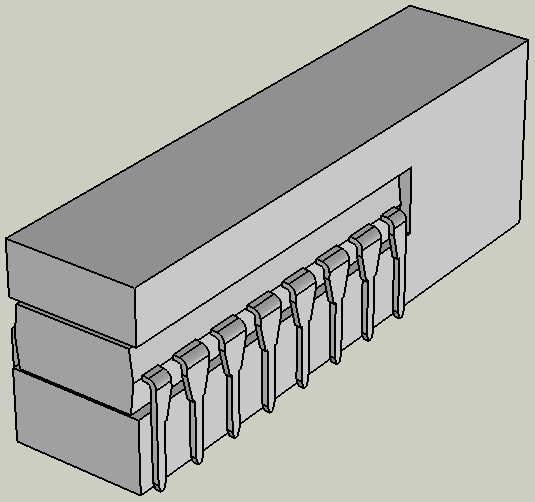

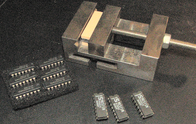

Post by: sorveltaja on July 28, 2020, 06:16:47 PM

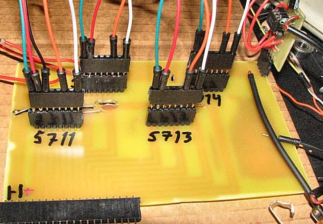

Thanks for the replies, guys. Awemawson, that's an interesting idea of the leg straightener. Haven't seen those before. Shouldn't be too hard to make one.
Another way could be like this, that has printed/machined block with a 'pocket' to fit the IC in:
Then the legs are pressed, using vice:
That block might not be necessary, but it limits the legs from bending too much. It seems to work quite well, at least on 14 and 16 pin ones, and the IC's pop nicely into sockets.

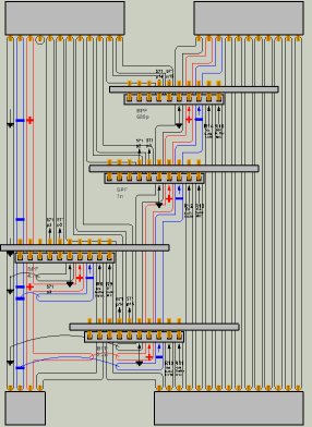

On the other hand, I finally got my head around of how that mod should be connected to the main circuit:
Now that it's done, moment of truth gets closer. All the needed basic wiring is done, except power connections(three wires for the main boards, and two for the mod board).
The main circuitry(pcb's) is yet to be verified. As far as I know, most of the builders of this device have built it using the kit, that was available on the Paia website(not sure, if they still make that kit, as it's been out of stock for a long time).
Plan is to start testing as soon as the power wirings are done.

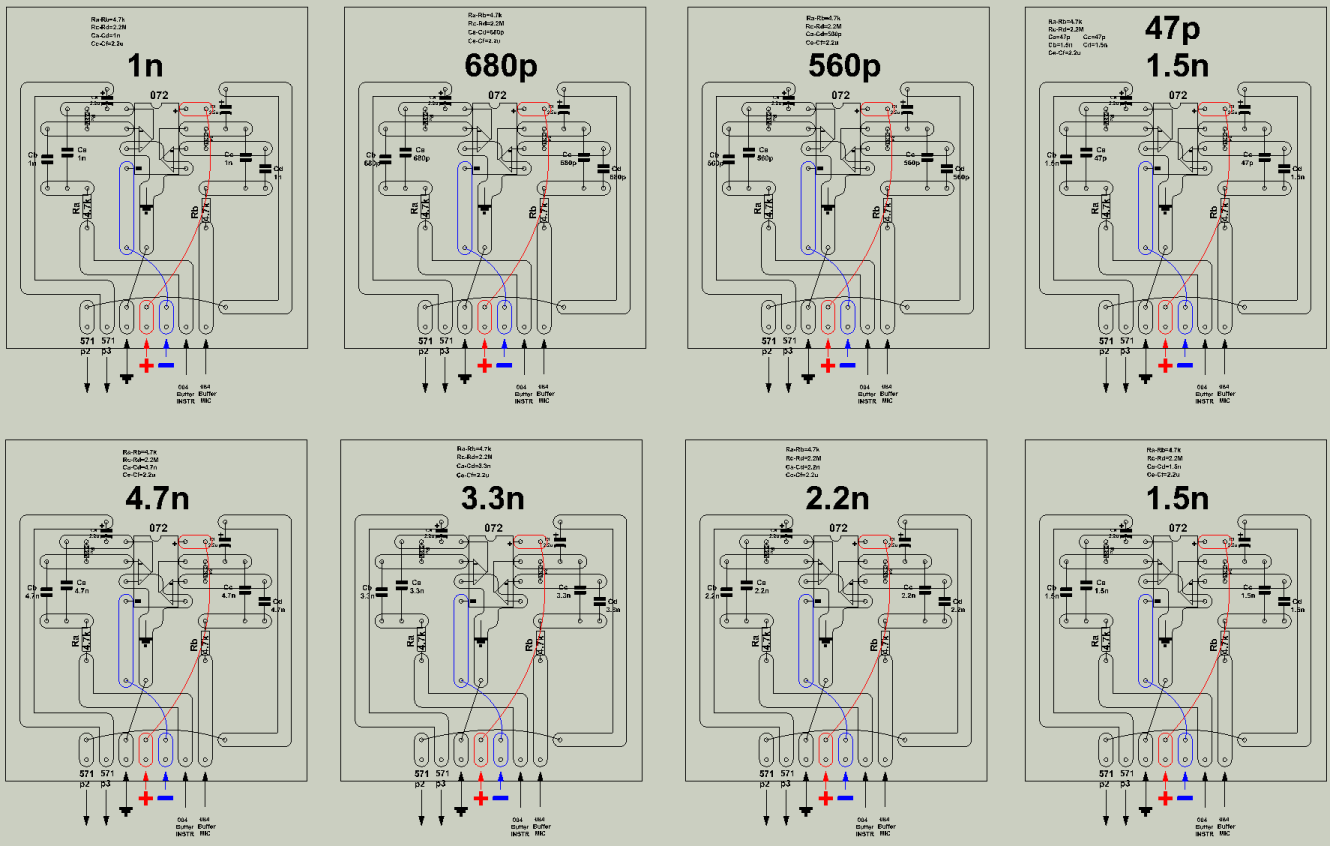

Today I did some drawing, of how the blocks could be breadboarded. Both the instrument- and microphone input stages consist only single amp. So does the output stage.
The heart of the device is between:
On the left side is one of the bandpass filter pairs, which share the same component values. In total there are 8 pairs of them, for 200, 400, 600, 950, 1300, 2200, 3000 and 4900 Hz. Obviously different frequencies require also different capacitor values. Other than that, all the pairs are identical, and use the same pcb layout. Should make easier to build the blocks one by one.
Plan is to make separate pcb's for each pair, so that they could be handled like 'modules'.
For those I'm going to use dual op-amps, instead of quad ones used in that already built circuit. I happened to find more than enough duals from my shelves, and also few single op-amps, that I'll use for input- and output stages.
On the right side is one of the 571 dual companders. I might have used one or two in some projects in the past, but never actually fiddled with them. But now there is a good chance to hopefully make sense, of how they work, at least during testings.
So here we go again, and next on to the breadboarding.

Both input stages were breadboarded, and tested. I did draw pcb's also:
So I printed the transfers, did some ironing, etched the boards, and drilled the holes. Only after that, I noticed that they were reversed...  Sometimes the printed transfers need to be mirrored but not this time. The way, that I draw the layouts, they should be printed as they look on the screen. If there is some text in them, only that should be mirrored.
To keep the project going, I made new ones using non-mirrored transfers, and now the boards are in etching bath.

Today was spent mostly by drawing new layouts for buffers(the 'clarifier' mod for the vocoder):
First is the old layout. Second is the new one, divided to two separate boards. Both have only one input, and 8 outputs. I thought that it would be more handy to gather the outputs together, so headers will be used. There are no ground connections in the buffer boards, as was mentioned by the builder of the mod.
As can be seen, there are no other components than quad op-amps and a few jumpers, so I didn't bother to breadboard it. If the IC's are fine, it just should work.

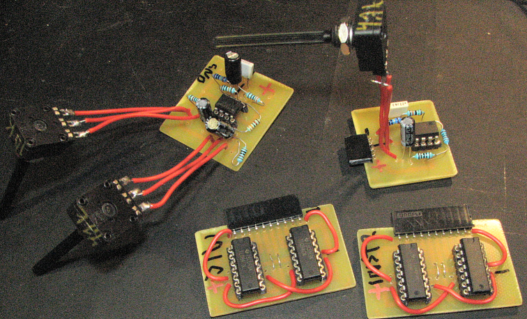

Input and buffer boards almost finished:
Only one of them doesn't have a header, being mic input board, as it was the first one that I did draw and build, and didn't consider of using headers.
But after that, I got back to my senses, as using them(headers) should minimise the wiring hassle between stages. That way, testing of the 'modules' is also a lot simpler thing to do.
Next thing to do, is to add necessary wires for the boards, and test them together. If that goes well, then on to the bandpass filters.

Boards are almost ready for transfers:
First is one of the eight band pass filters, and second is one of the four companders. I did some double-checking, and it's worth the effort, as there were some obvious errors.
Now they should have been sorted out.
When taking a break of the drawing/checking, I got seriously distracted, when looking at some other vocoder schematics. They have some nice extra features, such as separate level adjustments, inputs/outputs for each BPF/channel, which could then be cross-linked in any order, using patch cables, to make it behave like ministry of silly walks.
But back to reality. At this stage, that kind of options would make the process a lot more complex. After all, the idea is to first build a bare bone -version(as I have already cropped all the extras out of the layout/schematic) of the vocoder, to get a grasp of how this specific breed(Paia) works.
I haven't yet found a way to draw the 'bus board', or 'motherboard', where all the blocks could then be inserted using headers. It's probably because at the moment I don't have too much of circuit board to spend.
I have a bad habit of drawing the layouts basing of what I currently have on the shelf. Yes, it's unnecessary subconscious limiting factor.
When going back to the hex pickup -project, there were numerous versions of different layouts/schematics/stages, to get closer to the desired results.
So I think, that part of the learning is about remembering, and revisiting the ideas, that once worked. For me, at least, it requires some deep digging, to access that mindset again.
But enough of that jabbering. I'm going to place an order for the components/stuff, that might be needed in the project, plus some more. This time the circuit boards will be 0,8mm ones, as they are easier to cut, than previous 1,6mm ones.

Bus boarding in process:
Really good concentrating exercise, I must say. I started by adding power connection traces, but soon noted, that It's better to leave them last. That way the signal paths have traces with less jumper wires.
Whole layout is about 260mm long, so it is too big for me to make it in one piece. Once the drawing is done, I'll divide it to 3 or 4 parts, which could then be connected together using pins and headers.

Drawing of the bus boards first version is almost finished:
At this stage, I think I'll probably use angled female headers for bus board connections. At least it should make testing of the separate boards easier, by using the same wires as on the breadboarding.
If testing goes ok, they could then be connected together by adding male pin headers between them. For that, I'm going to order longer ones, as the ones I have in shelf, are too short.
But first things first. Next I'm going to build one of the band pass filter boards, to verify that the layout works. Then same for one of the compander boards.
The rest of those 'blocks' use same layouts, but the component values differ.

Today some cross-checkings:
First are the band pass filter sections, and then the compander ones. It is important to connect them in certain order as 'pairs'.

Finally, first ones ready for testing:
I think I'll start with band pass filter(on the right side). With component values that it has, the 'peak' should be at ~4900hz.
Then the compander board, which, to my understanding, acts like a dual channel... something. As it is now configured, one channel's output level controls the other channels output/gain/level.
Still, there is something about it, that I can't get my head around. Maybe it's simpler than that. But we'll see, once I start testings tomorrow.
Band pass filter boards ready for the parts. I managed to salvage all the needed components from the previously built boards:
If and when all the 'blocks' are built, tested and working, then the aural testing -fun should be a bit closer. Some bus boarding, and other supplies need to be ordered before that, though.
Post by: awemawson on August 18, 2020, 05:31:19 PM
Surely those electrolytics don’t need to be 250 volt working   Rated at a lower voltage they’d be much smaller and your board less crowded.

Band pass filter -boards are now finished, and tested. Regardless of the clumsy looking capacitors, they work as expexted:

In the end, the compander bus board is now finished, and connections tested:
The four pin header on the right side is for the op-amp -board(to be done), that sets the output level using a pot. The pot on the upper side is to adjust the 'vocoder threshold'.

One thing that came to mind, was to replace the companders with something simpler, like Led-Ldr(Light dependent resistor) pairs. After a bit of search on the net, conclusion was, that they aren't generally used for a vocoder.
All the diy -designs, or versions that I'm aware of, use IC-based solutions for that.
The Led-Ldr pairs are used on some diy compressors, phase shifters and so on. Of course the linearity isn't at the same level with the IC-based 'level adjustment' -devices.
Despite of all that, I think it's worth of testing, how they could possibly work for this purpose. The form will probably be like on an envelope follower from Craig Anderton's "Electronic projects for musicians":
Basically, the above Led-Ldr envelope follower works as follows: an audio signal is fed to the input, and goes through the op-amp(IC1), which drives the Led portions of the optoisolators(OI1 and OI2), so that the leds light up, roughly following the input signal's amplitude. Amount of that light tells the Ldr, how much it can 'open', by lowering its resistance.
So, plan is to start by cropping the above schematic's parts count to bare minimum.

To see, if the compander bus board could be used for led-ldr pairs, I made adapters for the pin headers, so that it's easier to connect the breadboard to the rest of the circuitry:
I did roll some temporary optoisolators to test the concept. They aren't lightproof, and need to be covered with something like a cardboard box, when testing. I had to order more ldr's, as it is probably better to have the same model for all the eight pairs:
First I connected some leds to compander bus boards' header pins(which are connected to band pass filter's(bpf) outputs), and it was like a christmas tree. Frequency sweep from 0 to 6000Hz showed, how each channel responded to certain frequencies. Adjustable gain, first stages(for mic and instrument) had expected results; when turning the gain down, leds dimmed correspondingly.
So far, it looks like the bpf's outputs itself might have enough drive to make the leds light up at the usable levels.
One part of me tells that the signals should be buffered, before they hit the leds, but not yet; only if there are several, noticeable impacts to the rest of the circuitry, then it should be done.
Version 0.1 layout of the possible compander-replacing led-ldr portion:
Mic input signals drive the leds, and should ideally be in a dc form. Diodes do some rectifying by allowing only positive peaks of the ac-form audio waves to pass through, and then the 47uF caps smooth out rest of the signals.
Instrument input signals go through the ldr's, that act like variable potentiometers. Again, microphone's signal controls the intrument's signal output level.
As can be seen in the above layout, 'outputs' of the ldr's are fed to the final stage, being an op-amp. They are simply tied together, which shouldn't work, as all of them will fight against each other, to get a place in the sun. Buffering seems to be the key, and is added later on, if definitely needed.

First aural test, using previously mentioned circuit. Currently 5 of 8 channels are connected:
Resulting audio, rather muted and distorted, with little of an eq added to clarify:
Audio files used to drive the vocoder: a sample from an audiobook "Gods of Mars"(freely available from archive.org) for mic input. For instrument input, an audio file, using the hex pickup, recorded back when I made final adjustments for it.
It's very tricky to get the adjustments to the point, where the effect is most clearly audible. Changes in input signal levels affect the result also.
I'm thinking of testing the inputs by using compressed audio signals, to get more stable action. First it could be done by compressing the audio file's signals, and if it helps the overall performance, then build a compressor for each input. But we'll see.
After all, I am very much surprised, of how that rudely simple concept, where I just threw some components to breadboard, gives signs of life. Absolutely worth further testings.

The ordered ldr's arrived, and now all the 8 channels are connected. First sample was made using the same hex pickup track, to feed the instrument input. Control input (Mic) was fed with 2Hz(120bpm) square wave. Raw output, so there was no post audio processing(who needs a drum machine, sequencer, or a keyboard anymore):
This one was made by feeding the same clip from previously mentioned audio book(speech) for mic input, and 50Hz square wave for the instrument input(or was it vice versa). But anyways, that required some heavy eq'ing afterwards, but still lacks the definition:
So far, as this vocoder is a bare-bone version, it has already exceeded my expectations, by opening a whole new audio landscape for experimenting.

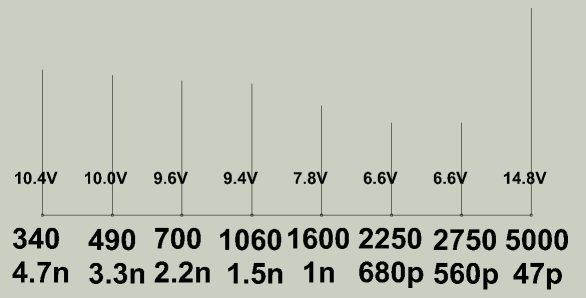

Not so much of an aural testing today. Instead I've been drawing a breadboard version of a compressor, that uses led-ldr pair for gain control. If it makes noticeable improvement for speech processing, more about it later.
I also measured outputs of the band pass filters, one by one. 0.1 volt sine wave was used, at each one's peak frequency. Power supply at -15/+15 volts. Results:
Quite a lot of deviation, to say at least. I started modding with the 560p one, to add more gain for it. Schematic of the mic-instrument pair:
First I removed resistors Ra and Rb(both 4.7k), and replaced them with 10k multiturn trimpots. Still not enough, so I detached one end of the Rc and Rd(2.2M each), and added 2.2M resistors in series with them. Then I was able to get the max. output to 12.0 volts, which might be enough for now.
I just don't understand, why there is so much deviation between bpf's outputs. 560pf one had 072 dual op-amp, and I replaced it with 082, to make sure, that the ic is working, but still same results.
Those bpf's have identical components, besides frequency setting capacitors.
Modifications are quite simple to make. On the right side is modded one:

Optocoupler pair, as a module, and built one(1 of 4):
  [ This attachment cannot be displayed inline in 'Print Page' view ]   [ This attachment cannot be displayed inline in 'Print Page' view ]
There were two odd things, that I stumbled upon. First one was, that I had to swap mic/instrument connections for the led-ldr pairs 2-4-6-8. Otherwise they wouldn't give any output. Probably some logic error in the bus boards. I didn't want to spend too much time to find them(errors), instead it was easy to fix the problem, when they were on the breadboard.
Second one was utterly strange. When I built the above led-ldr pair as a module, there was usual testings, to see if it works, as expected. Procedure was this: feed a low frequency square wave(1Hz) to the led inputs, and higher one(audio range) freq. signal to ldr's. That way I expected to see, how the slowly flashing led turns on and off the signal, that goes through the ldr.
No such thing. The signal went through the ldr, and the flashing led did affect it only barely visible amount, when looking at the scope. I used signal generator for the signals, and dialed the levels up and down, but no visible reaction.
There I was, thinking: "bugger! this doesn't work!". Then I did the same tests with 'previously aurally tested and working' -setup, that was on the breadboard. Exactly similar results.
My conclusion was, based on level measurements, that it shouldn't work, but when connected to the rest of the circuitry, and listening to the output, it works, for some reason.
There must be some 'plan 9 from outer phase' -audiochemical processes going on.
But seriously, the way they work, isn't obvious(at least for me). I would most probably have skipped the whole concept, if I was counting on my skills to find out, what's happening, just by looking at the numbers or curves.
In the end, no off-topic ramble this time.
Makes one wonder, why the optoisolators aren't used on diy-vocoders(as far, as I'm aware of).

All the optocoupler boards are finished, and the whole device works, as expected. Now it's time to look, what needs to be added/modded, to get the most out of it.
First one is simple; 100k potentiometers(left from the arbitrary waveform generator -project) between bpf- and optocoupler boards, to adjust each channels levels individually:
It works like an equaliser, but has rather subtle effect. That is probably because the leds on the optocouplers could use more 'juice', to make the ldr's more reactive/responsive. The outputs of the band pass filters, although their gains are cranked close to the max, are still lacking the grunt. But then again, they weren't originally designed to drive leds...
I discovered a possible trick to increase their current levels, while testing earlier with a single potentiometer. So far, I can't tell, what the cost will be(like roasted op-amps, and such).
As always, there is only one way to find out.

I can now see, why there is a fuzz option for the instrument input, in the original schematic. It adds, when used very sparingly, a bit more harmonic content. So I breadboarded the 'tube sound fuzz':
It uses a 4049 cmos hex Inverting Buffer -ic:
I left the R6(10M) out of the circuit, as only very mild portion of fuzz is needed. Actually finding a sweet spot could be easier to dial in, if a multiturn pot was used insted for R5(1M).

At first, I'll be using simplified tooth shapes for sketching:
This will be a short sideproject, to see, if the concept is relatively easily implemented, as I don't feel like delving into it too deeply at this point.
Post by: sorveltaja on September 09, 2020, 09:06:27 PM
For testing the vocoder effects between different audio samples, there is an easy way, using Audacity's(free audio editing software) vocoder, which I discovered just recently.
I tried it with the same tango-steamtrain audio sample, that was previously posted. With default settings, similar effect is there, but has somewhat different 'pronouncing', when compared to the analog device.

Post by: sorveltaja on September 11, 2020, 08:09:16 PM
Measuring, how to fit the vocoder into the enclosure. Bit tight, so the slide pots between band pass filters and optoisolators can go, for now. If needed, they could be added afterwards:
I've had a far-fetched idea of adding some kind of an audio analyser to the setup, having an led bar display for each channel, to show and hold the peaks of average values of say, 5 sec. audio samples, to get the 'profiles' of certain sample's frequencies.
In practice, I guess it would get too complicated, if only analog components were used. An alternative could be to use one of those cheapo pocket size oscilloscopes instead.
Getting/testing smaller nozzle has been on my to-do list for a while, so we'll see, once the current projects give room for it.
What comes to conical metal(or other material) surfaces, there is a slight chance, that they might not be necessary, as I noticed today, when fiddling with different configurations. Also the tension spring might not be needed. It seems that only the centerpiece, or 'sun gear', that rotates the bearing balls(planets), needs to be made of metal, having smooth surface.
Printed outer ring turned out to be adequate for testing(although smoother/machined surface would be better). Once there is sufficient amount of tension between the parts, they rotate just like planetary gears do.
Almost too simple, so there must be some serious obstacles ahead. To find out, what they are, I'll start a separate thread about the subject soon.

Today I managed to almost finish the fuzz and super tone control for the vocoder:
Again, the fuzz pcb layout was mirrored, which I noticed(again), while soldering the corner legs of the ic socket(http://www.elisanet.fi/kz1706/emot/1087.gif).
Anyways, It was a breeze to make a corrected one, as the board is so small.
The way, that the fuzz works with the vocoder is already tested, when it was on the breadboard. The super tone control will have to wait, until the vocoder itself is fitted into the enclosure.
The plan is to use as few switches as possible, to avoid unnecessary wiring hassle, when compared to the original, Paia version.

Now the vocoder has an enclosure, although carboard is still in use for front panel:
There will be at least 7 pots more and one switch, once the fuzz and super tone control are installed. Then plug for the headphones, so the output doesn't need to be connected to the pc's soundcard, while testing.

Today more cardboarding:
Before putting the tone control and fuzz into the vocoder enclosure, it's easier to first test different combinations, to see, how they work. Knobs need to be printed, and power supply wirings added.
