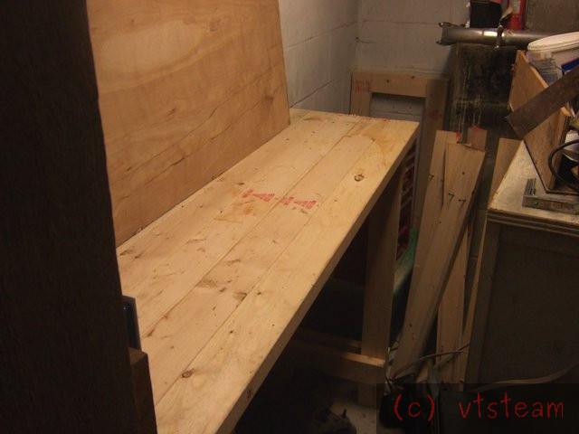

I had to cut my bench top -- can't keep it full length (temporarily) because I wanted to put plywood as a back panel to stiffen the bench up. And to provide support for the 2 vertical plywood dividers I plan to put in. The dividers will hold the drawer slides to provide 3 vertical drawer sections.
There was no way to move the bench out away from the wall if it extends full length. The chimney blocks it from being moved out.  No way to fasten the back panel on. Or the vertical dividers.
So I cut the bench top down to 5 feet. I'll replace the missing 3 foot length when the dividers are in place.
Here's a photo of the top after cutting it short. The ply back panel is sitting on top of the bench. I later scooched the bench out and clambered in behind it, and fastened the panel in place.
This is the only photo -- so much stuff in the shop I had to shoot through the door.

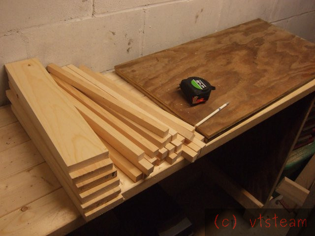

I ripped up some 1 by 6 into 3/4" square x 17" drawer slides, and cut some 1 by 4 into 17" lengths for the bottom slides. The salvaged plywood for dividers is also on top of the bench. One of the plywood end pieces is just sitting in place to check fit, on top of the back leg cleat. It will get drawer slides glued and fastened in place first before screwing to the legs.

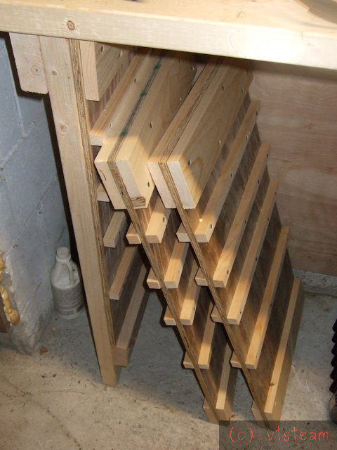

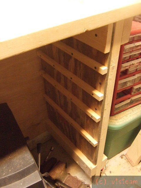

Today, I sanded the plywood end panels and divider panels, and began gluing and screwing the drawer slides in position.
A side piece for each drawer depth (there are 4 different depths) was used as a spacer to determine where to place the slide. I used 1/8" shims to give enough clearance for sliding and wood movement before screwing the slides down. You can see a drawer side and the slide and shims here:

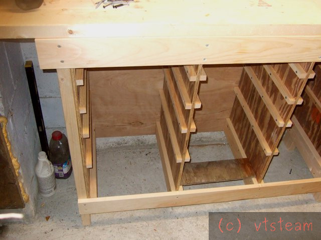

Here is a finished end panel in position. It sits on top of the 2x4 leg cleat, and that cleat also serves as the bottom slide.

The two divider panels. These are 3-1/2" longer than the side panels and have 1 by 4's screwed to the bottom to act as slides for the same drawer that will ride on the leg cleats of the side panels.
All ready to go for attachment to the bench tomorrow.

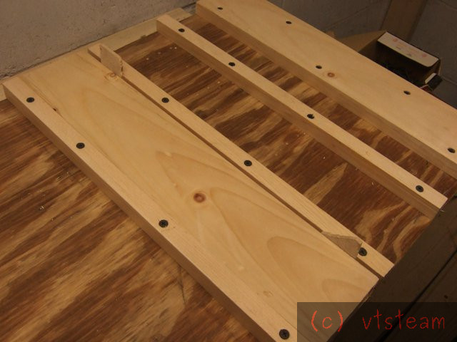

Today, I added the dividers, and scooched the bench out again to fasten them in place to the backboard.
A strip of 1x 4 was added to the top and bottom on the front side of the bench to fasten the dividers there as well.
I cut a piece of scrap plywood as a spacer gauge while screwing the dividers in place, you can see it in the pic below. It's exactly the desired divider spacing (greater than the actual drawer size), and I slid it in, top and bottom, front and back while fastening each section. If it slides and fits everywhere, that's perfect. And it does. A lot easier than measuring and marking, and keeping things aligned by hand.

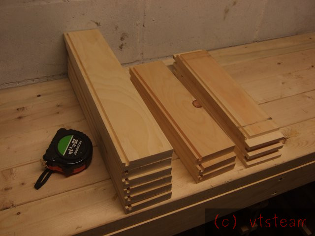

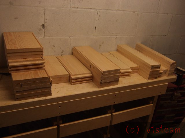

With the dividers in place, it was time to start on the drawers. First thing I did was put a dado in a couple long pieces of stock, which will accept the 1/4" plywood drawer bottom. I did it with just a small combinaton blade on my old Craftsman 8" table saw -- so it took 3 passes to get a 1/4" wide groove.
Then I chopped those up into the various lengths needed for the drawers. There's enough stock here for 3 drawers -- I didn't want to cut all 15 drawers worth of parts at once in case of a measurement error someplace.
The drawer fronts (far right) get a rabbet to take the drawer sides as well. This was done on the table saw using both the fence and miter gauge, with a piece of scrap wood as a spacer.

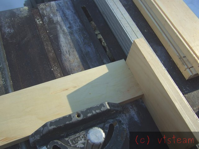

Here's how I set up the first cut of the drawer front rabbet using both the fence and miter gauge.
Generally it's not a good idea to use both at the same time, or the cut can bind. But if you put a piece of scrap wood against the fence behind the saw's blade slot, it can act as a length stop for your material in the miter gauge, But when the gauge is pushed forward the work is clear of the scrap block at the cutting edge, so doesn't bind.

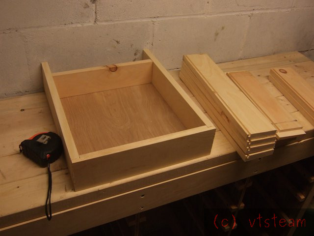

Checking the fit of the pieces before gluing:

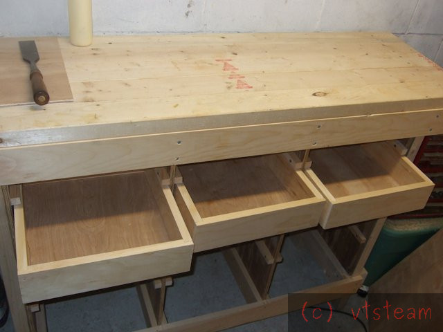

And glued and fastened together. They work fine, and I didn't cut anything short (unusual!), so tomorrow, on to the other 12!

Steve this is revealing a high level of wood working skills - pulled through no doubt from your boat building past ?
Looking very nice  :bow:

Today I finished molding and cutting out the pieces for the other 12 drawers. Made a few small mistakes, but none that I couldn't fix -- I've learned over the years to cut my longest pieces first, so if I mess up, I can cut shorter pieces out of it. That saved me twice here, because I bought nearly exactly what I needed, and no more.
Had the table saw throw about a 1/4" (6mm) cube of white pine at me -- you'd think something that light and small wouldn't do much, but it hit me on the back of the middle finger, and it is now swollen and stings like heck. Felt like I'd got hit by a good sized rock. No damage, but glad it didn't go for the face. Stood off to the side more while sawing after that.
