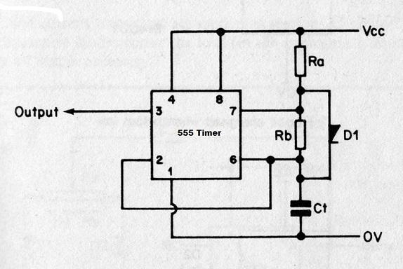

Went and bought some electric stuff today to build a PWM speed controller for a car windscreen wiper motor. I could've just bought a controller from ebay but i've been wanting to learn some electronics for a while, and this gives me an excuse.
It took a few tries to get something working. Keep in mind I really don't know alot about electronics besides the basics. I was first going with some more complicated diagrams i'd found online, specifically for PWM speed controllers, and I must've been mucking up the wiring somehow. So eventually I looked up some 555 timer stuff and found a very simple diagram that I was able to successfully build.
It's not without problems though. At about 75% duty cycle the wavelength of the signal starts to increase. I probably need to read up on 555 timers and play around with them more.
Glad I bought the oscilloscope though! I would've really been lost without it.

I presume your pot. is linear, not log or semi-log ???
Which is my usual antic ....  :loco:

  • Posts: 1513
Re: Drum/ Thickness Sander
« Reply #55 on: January 31, 2015, 06:34:17 PM »
Nope ...  Should be Linear. The frequency would drop very rapidly as the resistance increases.
eg ... say you had a 100k log pot the resistance change for the first ( say) 10 deg. would be a whole lot less than the last 10 deg.
Have not used 555's for PWM for ages, gone onto PIC uControllers .. Smartarse    :D

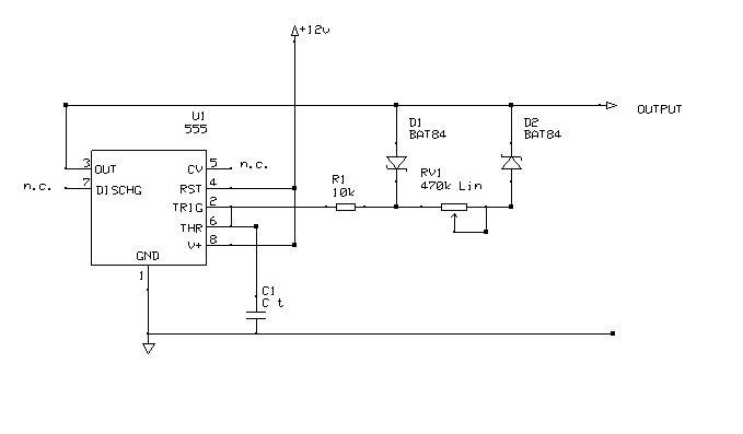

IIRC this is the cct. I used to use .. is it the same as yours ...
EDIT Rb is a linear Pot ....
Or it might have been this ...   :scratch:

« Reply #57 on: February 01, 2015, 07:07:27 AM »
Most of the stuff you need to know about '555's in here  :thumbup:
http://www.amazon.co.uk/Integrated-Circuit-555-Projects-BP/dp/0859340473
PS The two BATxx Schottky diodes can be 1N4148's, makes no significant difference.
IIRC the 2nd circuit does not affect the base PWM frequency ...

« Reply #58 on: February 01, 2015, 10:30:41 AM »
That second diagram works much better at controlling the speed. Also produces a nicer square wave without the high points (inrush?). It does change the base frequency though, but i'm not sure if that is really a problem.

It may well alter the frequency a bit ... it's a good few years since I did PWM with a 555.
Once you get into PWM on PICs its much more stable and very easy to change by code rather than oiking out the soldering iron.
If you're using breadboards I wouldn't bother about the glitching .. it does happen as you have a poor layout and contacts. Been there many times looking for non-existent problems ...  :palm:
If you want to 'scope it I would swap the motor for a resistor, no noise/ spikes from the commutator, and the sync. is better.
Post your original circuit ???
