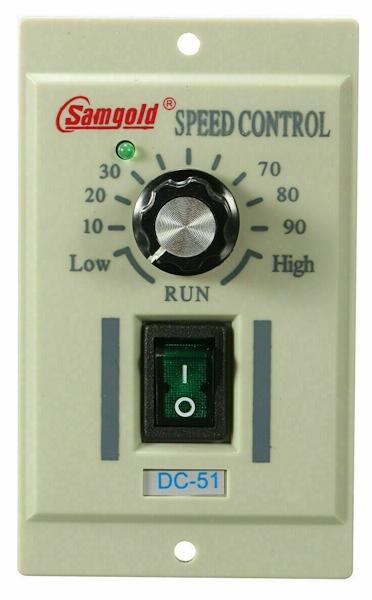

The tiny shop has languished for a long time while I worked on many other projects and chores over the last couple years. But longing once again to build engines, I've cleaned shop and moved the new lathe to where I can work on it again and got ready to finish the tailstock ram. It needs a slot, clamping cam pieces, thrust bearing, and handwheel. Slot was next on the agenda.
Things were eventually reasonable again after much mischief from mice, condensation and time. Unnecessary stored items were moved out, the floor swept. I oiled cleaned and lubricated the lathe ways, removed some surface rust from the 3 jaw chuck. Then I hooked up the lathe's DC motor controller, removing the XL timing belt from the headstock, and gave it a spin. Unfortunately the controller, a Cycletrol 150 (manual attached) had suffered, and though it spun the DC treadmill motor and responded to the potentiometer to increase speed, it didn't act right. I couldn't slow the motor very much -- minimum speed was too high, and it ran inconsistently, sending odd momentary pulsed jerks to the motor while running
I thought maybe the problem might be that the potentiometer had become noisy. I rewired with new wire, and soldered connections (I had used alligator clip jumpers for testing in the past) and tested the pot with an ohmeter. But it seemed okay, and nothing I did made a difference. BTW it always seemed odd that the only pot that worked was a 1 megohm resistance, when the manual called for 50K ohms, but that's the only way it worked in the past.
There are also three trim pots on the controller's circuit board one for min speed one for max speed, and one for max current. Adjustments to these three still did not solve the problems.
Since I was pretty much at the limit of my circuit solving capabilities here, the tailstock ram slotting has been put on hold.
  • Posts: 6941

I sent for a temporary AC to DC speed controller a few days ago when the Cycletrol 150 first started acting up. Temporary because it only handles a max of 4 amps at 90v DC output while the Cycletrol was spec'd at 10A. Nevertheless I figured I could get light use out of the smaller controller, while deciding what to do for a permanent replacement. The Ebay 4 amp "Samgold" controller was only $30 delivered from a US supplier. There were suitable larger controllers available for $60, but from China which might take a month or two to get here.
I got the Samgold controller this afternoon, hooked it up and was pleased to see it ran the lathe with the heavy faceplate and 5 inch chuck combo without cutting out. I haven't tried turning anything yet, but I did apply some hand pressure to the edge of the slow turning 8" faceplate, and didn't cause a cut out. The spindle does have a 5 to 1 reduction from the DC motor. I could probably double that ratio with a jackshaft, since the high speed range seems more than needed. Maybe the temporary controller is adequate with this treadmill motor.

I picked up the same controller for a project coming up.
  • Posts: 6941
Re: Building a New Lathe
« Reply #765 on: November 04, 2020, 09:13:40 AM »
Hi John, glad to get back to work on it here, too! I hope to do a lot more machine work and casting this winter, with several projects in mind.  :beer:
Hi Tom, I'm surprised at how well it works so far and how compact it is. My main question is, is it rated at 4 amps or 400 watts (various sellers) and is that a max permissible draw, or a continuous deliverable? And if it is 400 watts is that at full output only or at low speeds as well?
What will you use yours for?  :wave:

I want to build a 2x72 belt sander and have a spare 90v motor from my Craftex 601 milling machine. I belive I read that with these controllers it is recommended that the speed knob is turned down for starting to reduce the strain on it.
  • Posts: 6941
« Reply #767 on: November 04, 2020, 10:53:08 PM »
Hi Tom, looking forward to seeing that project when you start.
 :proj:
My experience with this controller is, yes, with a high inertia load like my 8" steel faceplate plus 5" 3 jaw chuck you need to start with the speed dial all the way down, then hit the power switch, and slowly speed the motor up.
I did want to see what would happen otherwise, so I intentionally flipped the power switch ON with the dial already rotated to about 1/4 speed. As expected, the controller automatically cut off as a result of the momentary power surge. But surprisingly, a second later it again started the motor slowly, and then ramped up to the 1./4 speed setting. This happened automatically.
