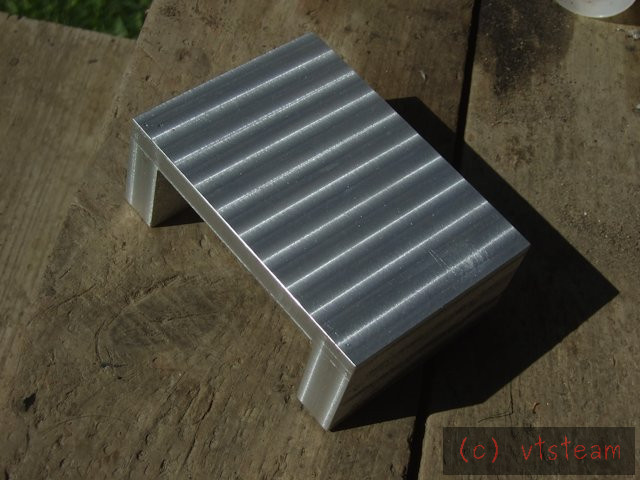

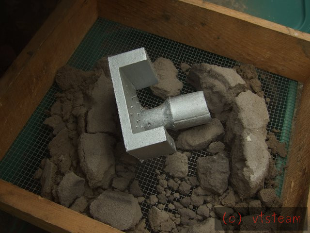

Interesting re-reading this thread. Just wanted to point out that I began it by trying to compound a specific silicon and copper bearing aluminum alloy, rather than an aluminum bronze -- which is a copper alloy with some aluminum in it . Quite a different purpose and metal alloy.
The aluminum alloy I chose to try to make was EN AC-45000. Which is 6% silicon and only 4% copper. I think that was a success and it certainly machined fine. I will have to check it again now for hardness after aging a further 3 years. I did make a part for the lathe project  with it -- a base extension.
