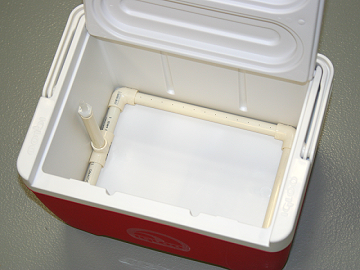

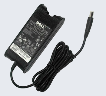

I joined this forum about six months ago because I saw Tom's anodizing bench thread. I had planned on setting up my own anodizing line, and Tom did such a great job of explaining and showing how to do it, I joined the forum and began setting thing up. I've done some work in that regard, so I figured I had better post some progress.... :thumbup:

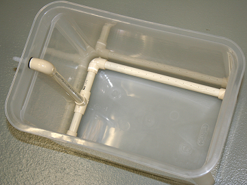

I'm using smaller tanks than Tom did. Mine are two gallon instead of five. Plus I'm using picnic coolers for the heated baths. The ones I found are Igloo 9 quart coolers.
I made a manifold for pumping air bubbles into the tank to keep it "stirred".
Since the acid bath warms while anodizing, I opted for a larger tank for the increased thermal mass (and therefore slower heating). It is in the four gallon range, but since it isn't insulated like the coolers, it doesn't take up a lot more room.
I haven't yet made a bench nor have I gotten all the parts together to have my anodizing line complete. However, I have clear anodized over 50 parts of various sizes, with good success. And of course, I learned A LOT in doing so.

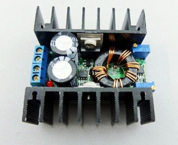

The most important thing I learned is to use a Constant Current power supply. I started with an old manual automobile battery charger. Fortunately it died (although it didn't feel fortunate at the time). The failure had me scrambling to find an alternative since I had a job to finish and I was behind schedule.
The parts I anodize are not large so I don't need a huge power supply. I had a surplus Laptop charger/power supply lying around so I connected it to a Current Control module I got on eBay. This what the charger looks like:
I was able to finish the job, but more importantly, the Constant Current module made a huge difference! The Laptop charger is 19 volts and anodizing in my tanks needs 13 - 16 volts (this will vary with the size of the parts, temperature, pH, cathode, etc.), the Constant Current module is a "Buck" (or step down) converter. It has a digital display for both Amps and Volts, and looks like this:
The Laptop charger is only 65 watts, and I would like a little more "headroom" for the larger parts I may anodize, I am "upgrading" to a Desktop PC power supply. It is really old (from a 386) so it is still limited but 120 watts at 12 volts is still an upgrade....
Since it is 12 volts, the Constant Current module needs to be a "Boost" (or step up) converter.

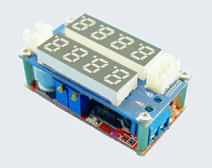

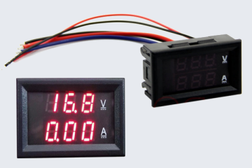

The one I got on eBay doesn't have the Amps/Volts display so I also got a separate display from eBay.
I'm currently in the process of putting it all in an enclosure. The module uses small 10-turn trimmer pots to adjust the current and voltage, so I am planning on removing them and wiring in a standard panel mounted pot for easier use.

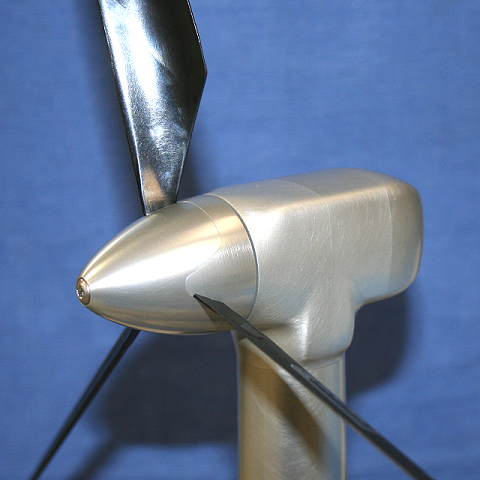

Oh, I almost forgot... here is a sample of the anodizing I have done:

 :mmr:nice pics....
Are you going to add some colour to your items?.....Blue perhaps?  :thumbup:

Your actual anodising tank - you've got your aerating pipes right in the corner - ideal situation to avoid shadows is as close as you can to 360 degree surrounding with the cathode - lead flashing sheet or similar. I would fit the lead lining first and then the pipes on top.  Bubbling on its own may not be enough - you may need pumped circulation as well...   Note your comments on larger liquid mass reducing probs with heat build - but remember you may need to inject some heat to start with as well.

Nice setup, your results look good.  :thumbup: The last anodising I had done was what they called "hard anodising" which is I think done the same way except the acid solution is kept very cold? The results were good anyway.
Yes, I have dyes for black, blue, red, and yellow. Since the job I showed, didn't require color, I haven't yet set up those tanks. I need to make the bubble manifold and work out the heating (the dyes need to be at 140 deg. F). I have heaters that look like this:
Good points Dave. Thanks for the suggestions. Your point about the cathode being 360 degrees has me thinking of making a new one. :thumbup: The bubbles seem to be working well, so it doesn't look like a pump is needed - it's not a large tank. Also, I keep my shop heated year round so the acid tank stays a good temperature.

Thanks for extra pics Aero. One thing to watch with those heaters is that you don't get the dye too hot, even in just one location. You can (don't ask me how I know!) get the dye too hot, and even just one hot spot can cause a problem. You would think, in general 'chemical' terms, hotter is usually faster which can often be better. The problem is that if the dye is too hot, you can get premature sealing of the oxide matrix you've carefully grown in the ano tank - you may just get a bit of dye in the top of the matrix and it'll "self seal" - but it won't be full-depth, can be particularly noticeable on black dyes where it will look paler and potentially longer-term wear unevenly.
Re circulation etc. in the actual ano tank - your pipes look to have a row of holes on the top. That will give a rising curtain at each side, and will induce some circulation; but depending on the geometry of the part, it may not be enough, particularly if you've got areas where bubbles can be trapped. The actual ano process out-gasses, and if those micro-bubbles get trapped they act as a localised insulator, so you can get an un-even depth of matrix and hence uneven colour if you're dying it. If you're going to stick with just bubbling then you may want to (a) have some holes at varying angles, and (b) consider having some transverse rows across the floor of the tank.  I have pumped circulation through a chiller, but also bubble pipes every 2 inches.
Your comments seem to put more attention on something I have been being casual about. So thank you, I'll make some changes. One thing I found was that the manifold would fill with solution when not in use, and it would take a lot of air to clear it out and produce bubbles from all the holes. I have been planning on remaking the pipes with much smaller holes to get higher air pressure. I'm thinking this will help evacuate the manifold better. I'll put holes in different places when I do it.
